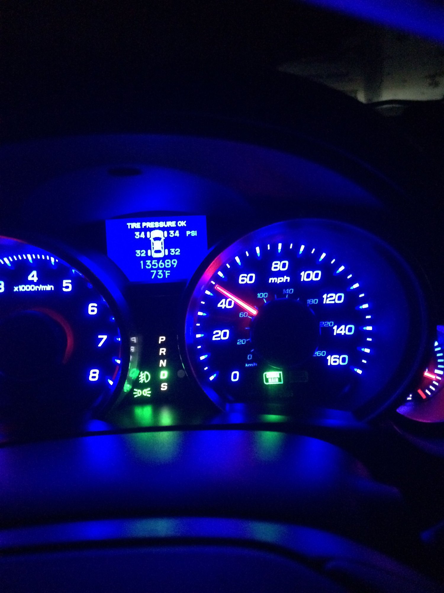

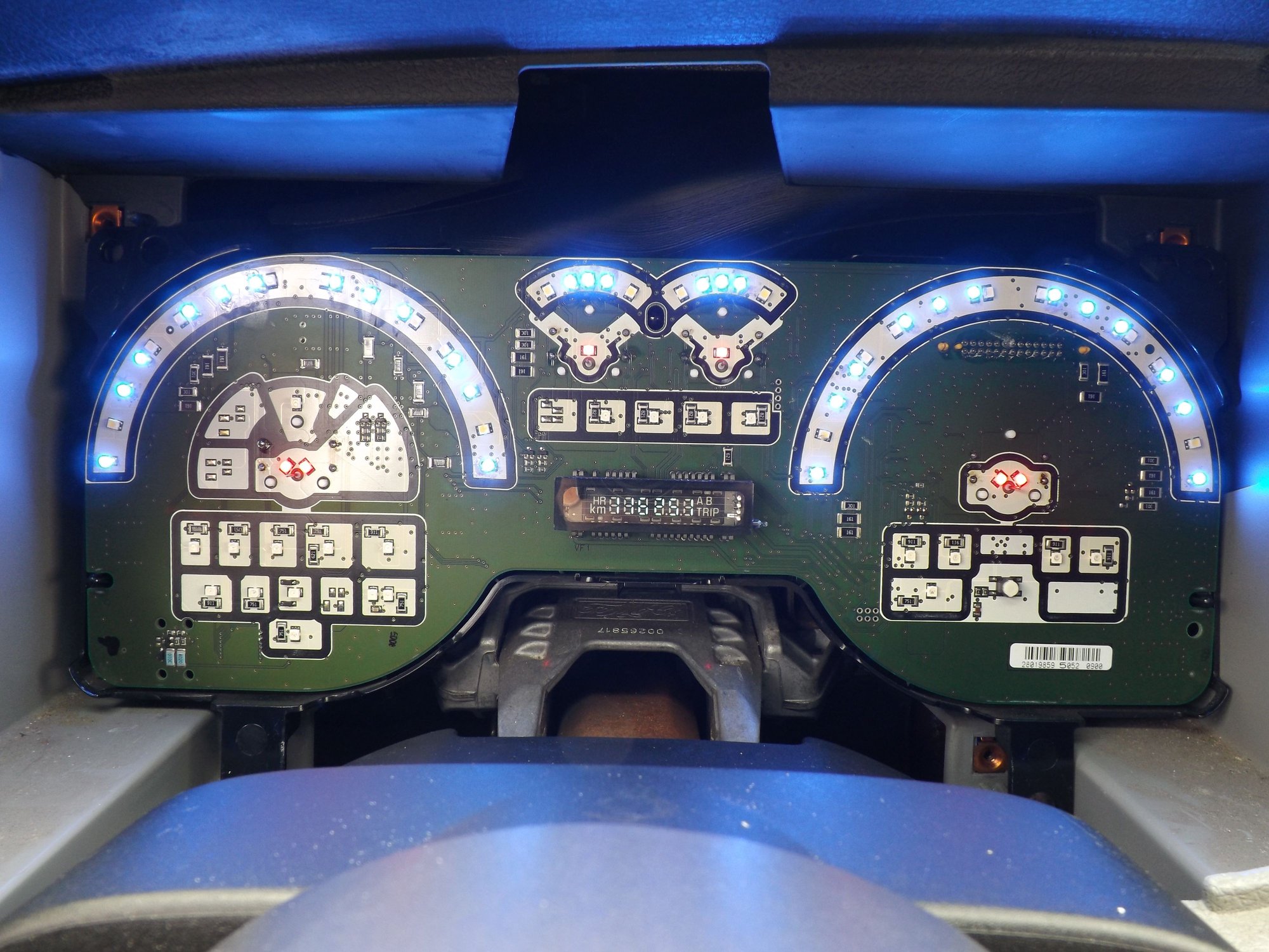

I would solder the lights, and I would remove the middle screen from the donor and install it in place of the broken one.
I don't think this option is a good idea, since it is a very delicate job, one false step and you will ruin the entire instrument cluster. Besides, in my country I don't know people who do that job well, that's why I prefer to change it.

You exaggerate the complexity of this job, all you need is a soldering iron, solder, tweezers and SMD 3528 LEDs. I did this job on my 2006 Mustang, then did it on a 2009 Acura TL. If you change the Cluster, then there will be problems with mileage, and when selling, people will think that you did fraud with mileage. This is a free country and you do what you want to do.
