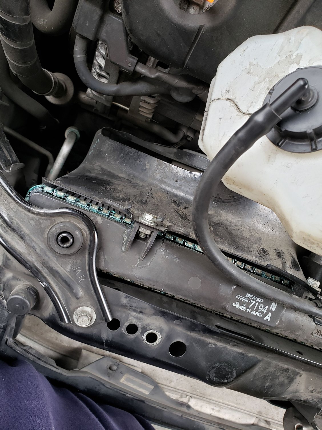

Based on pictures, there are coolant traces close to expansion tank but no splash marks like around the top hose, no leaks apparent off the tank cover. Some coolant seemed to have been spread around by the fans, quite a lot maybe.

Common failure point is the plastic/aluminum 'seams'
Just replace the radiator with a DENSO one (can be found on Amazon or rockauto.com)

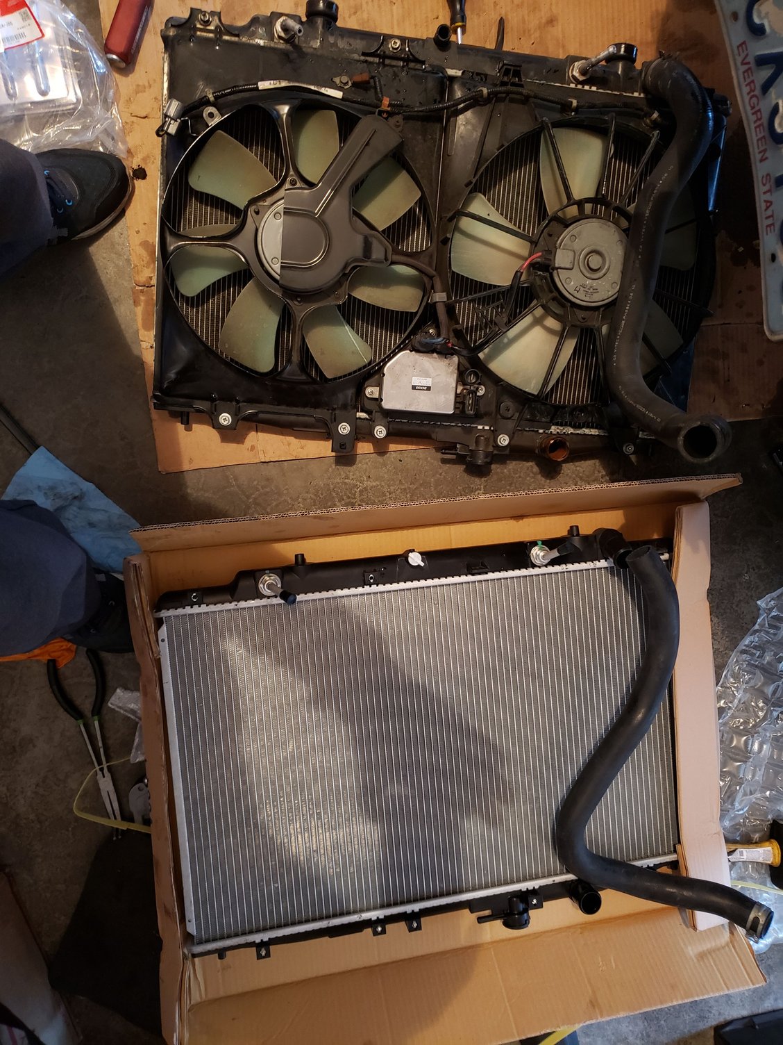

I ordered the Denso radiator on RA and lower tube on acuraoemparts along with other things like the thermostat. Might as well replace the thermostat while I have the radiator off. Will report back when I get around to it! Thank you everyone.

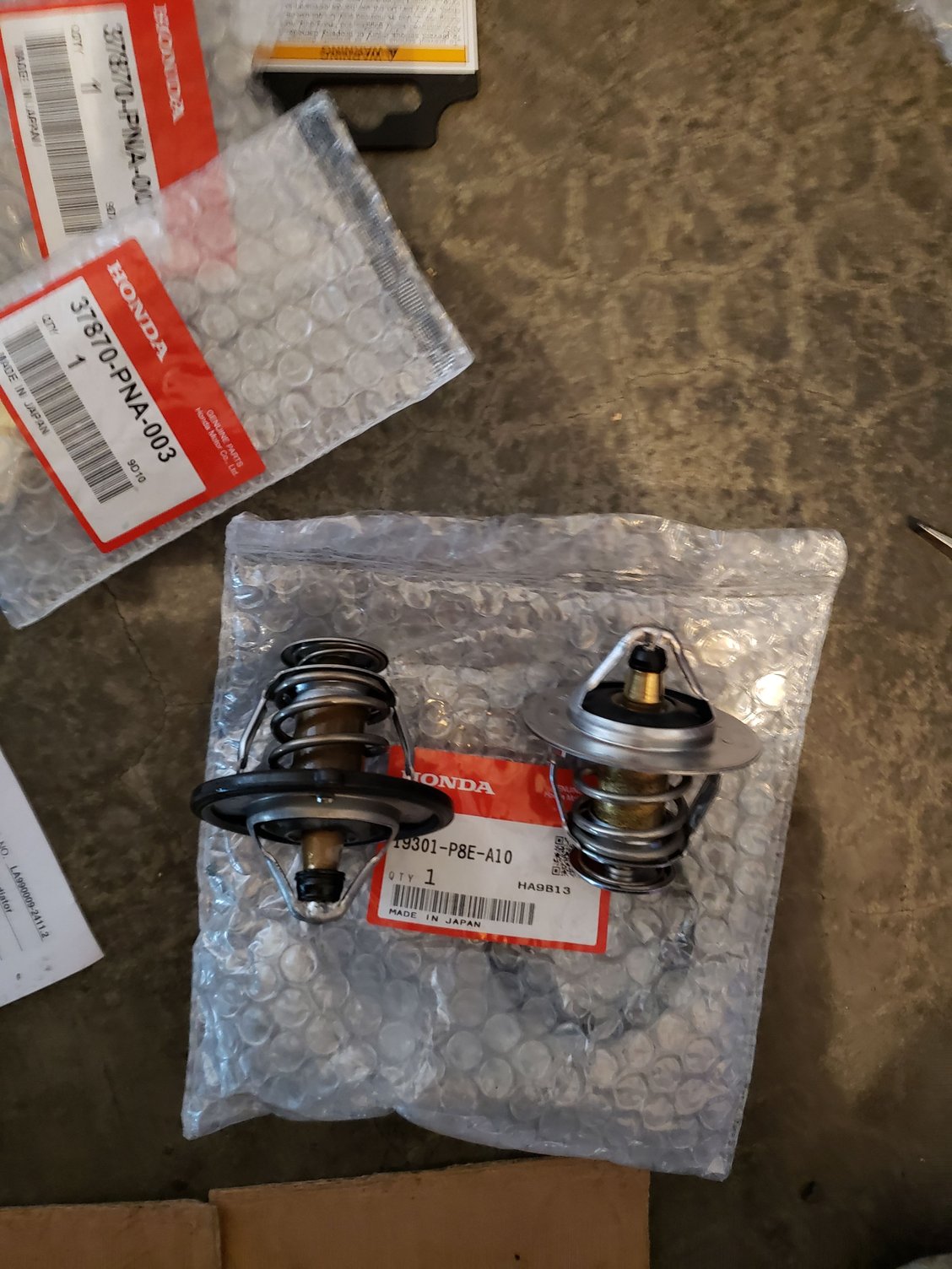

Great idea! I just ordered the sensor based on your recommendation. I will also check the temps for you when the parts arrive, both pre-install and post installation of sensor. You should replace the radiator cap because the center of the cap made of plastic erodes over time due to heat. Notice below on the right which is my old cap, the center has eroded compared to the new cap on the left.

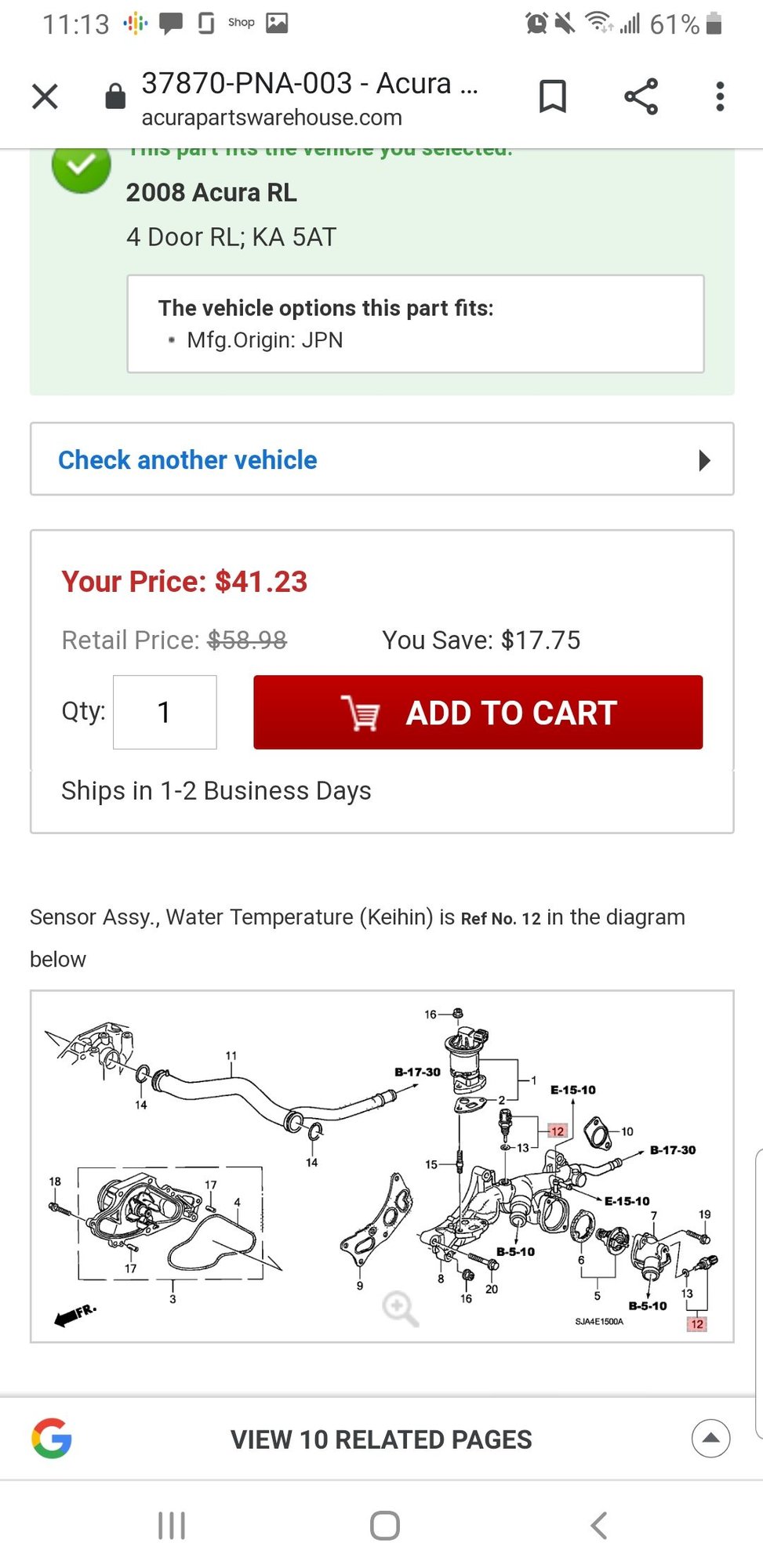

for 2005 to 2008 Acura RL the sensor is actually different 37870-PNA-003.

I see the two sensors you ordered, around water pump &thermostat housing:
The one sensor I was referring to is at bottom of denso radiator, numbered 22 on the diagram, part number not listed for 2008RL:
https://www.acurapartswarehouse.com/...tor-denso.html
It is shown on the same diagram, and this time listed as 37870-rta-005 water temperature sensor, which I believe just controls the rad fan and does not inform ecu of water temperature or displays its info on the dashboard indicator.

I have no idea but I have a 2008 so I'd assume it does not have the bottom sensor. Can anyone confirm this is the case for the 2005 to 2008 RLs?

Check your car DIY style: follow the radiator diagram, look at bottom of radiator for a 2 wire harness connecting to the radiator.
If there is one, its the sensor for the fan, none then dont worry about it.

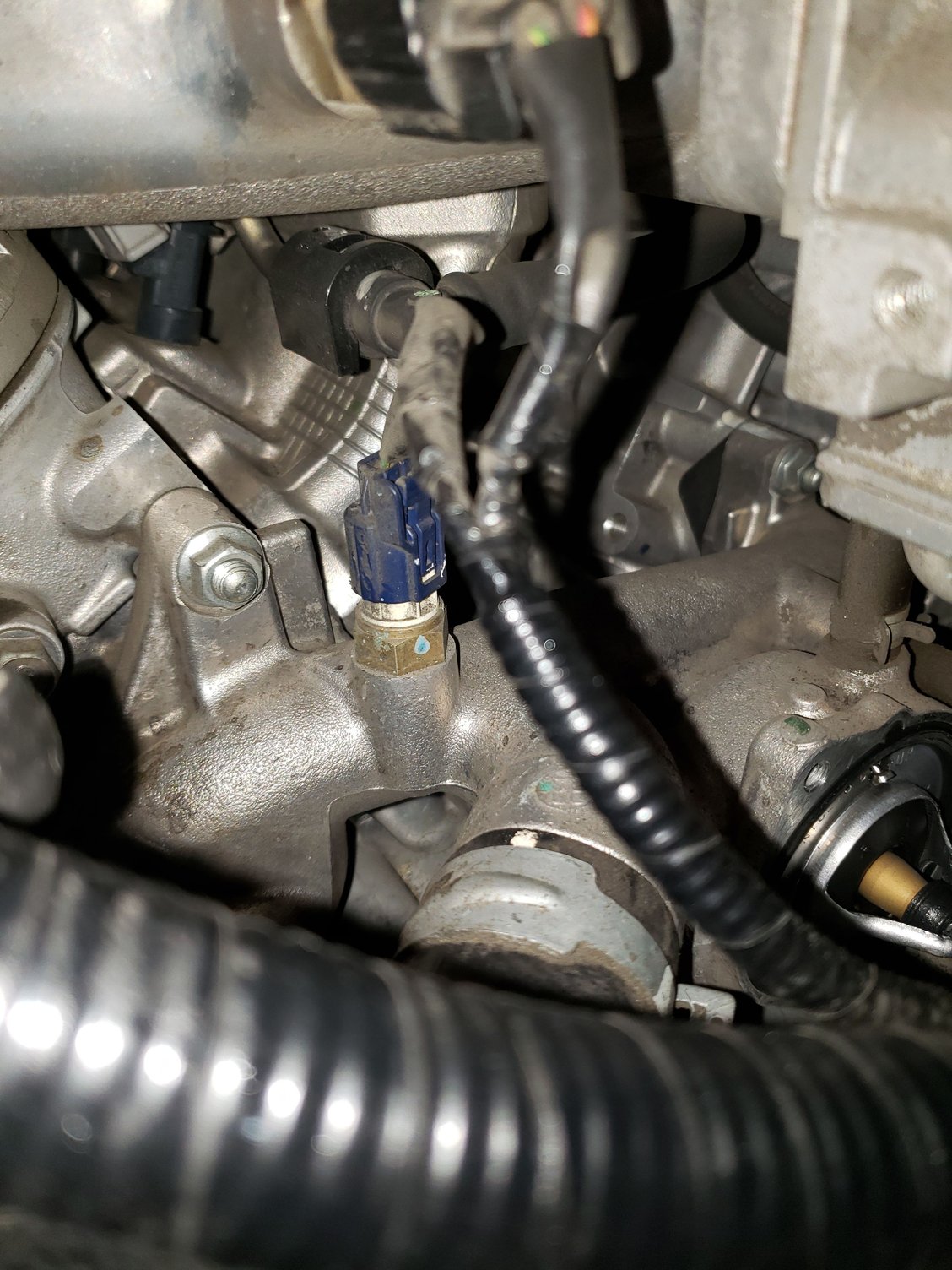

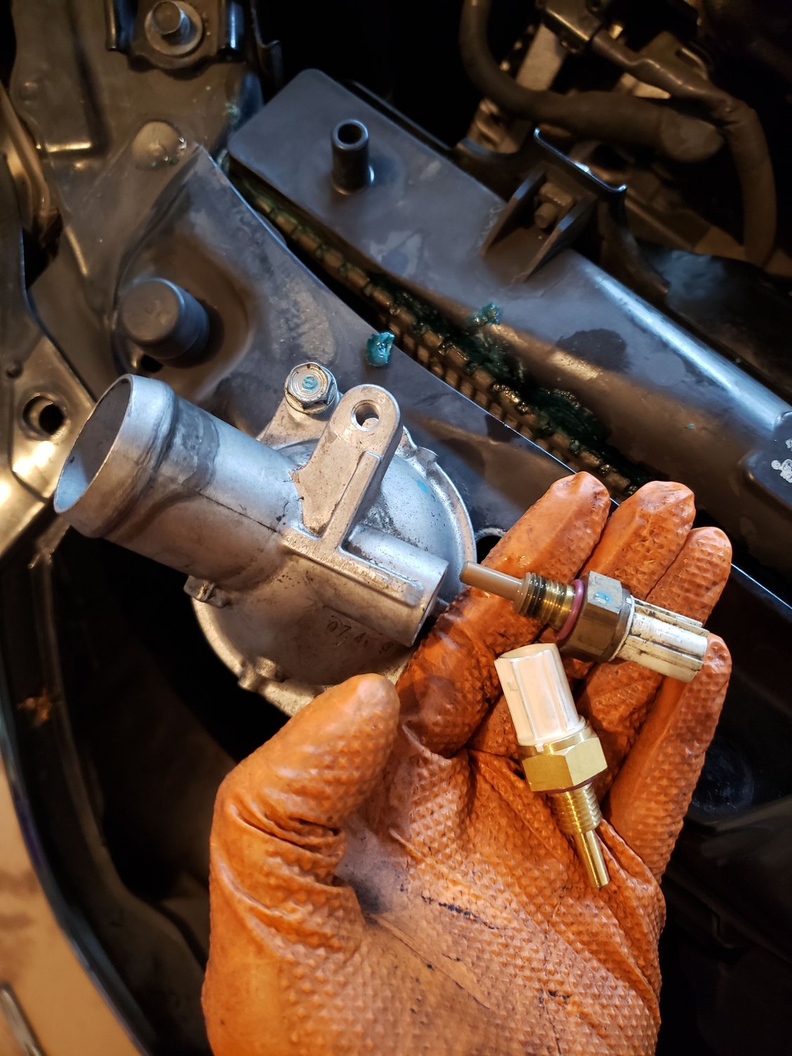

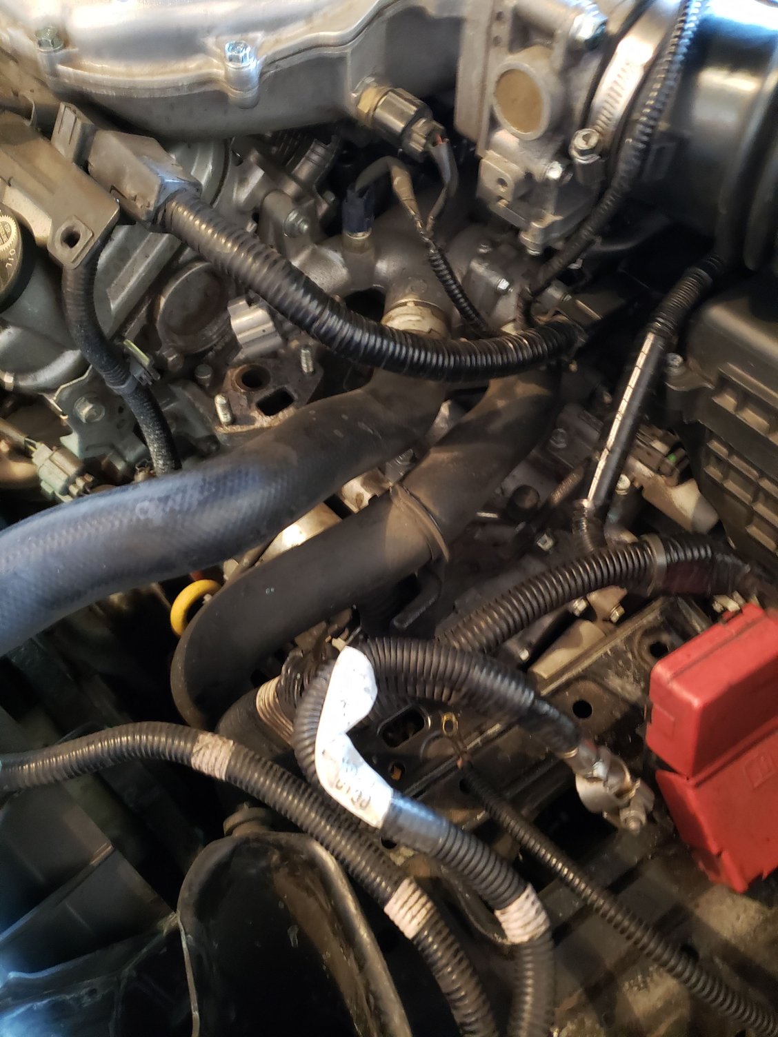

I can confirm the temp sensors are not located at the bottom of the radiator for the 2008 Acura RL as today I replaced my radiator with a Denso one. I also replaced two temp sensors, thermostat, lower radiator hose and cleaned the EGR valve.
Took me 5 hours. A lot longer than I expected. The hardest part is getting the damn connectors from the bottom. Also hard was the bottom bolt of the thermostat cover.
I couldn't get my obd2 scanner to connect so I do not have the temp..but I bought a new one and will get the temp when the fan turns on in the next few days when my new obd2 wifi connector comes from Amazon. Thank you everyone.
temp sensor on the thermostat cover
temp sensor #2 near the EGR valve
