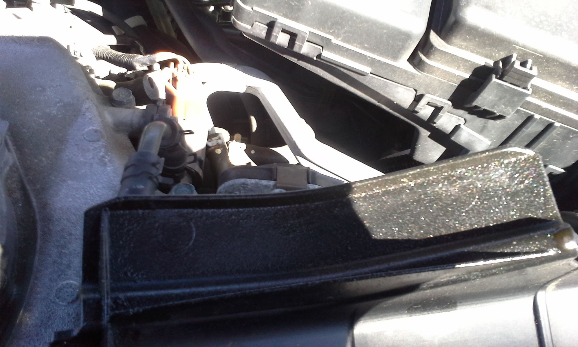

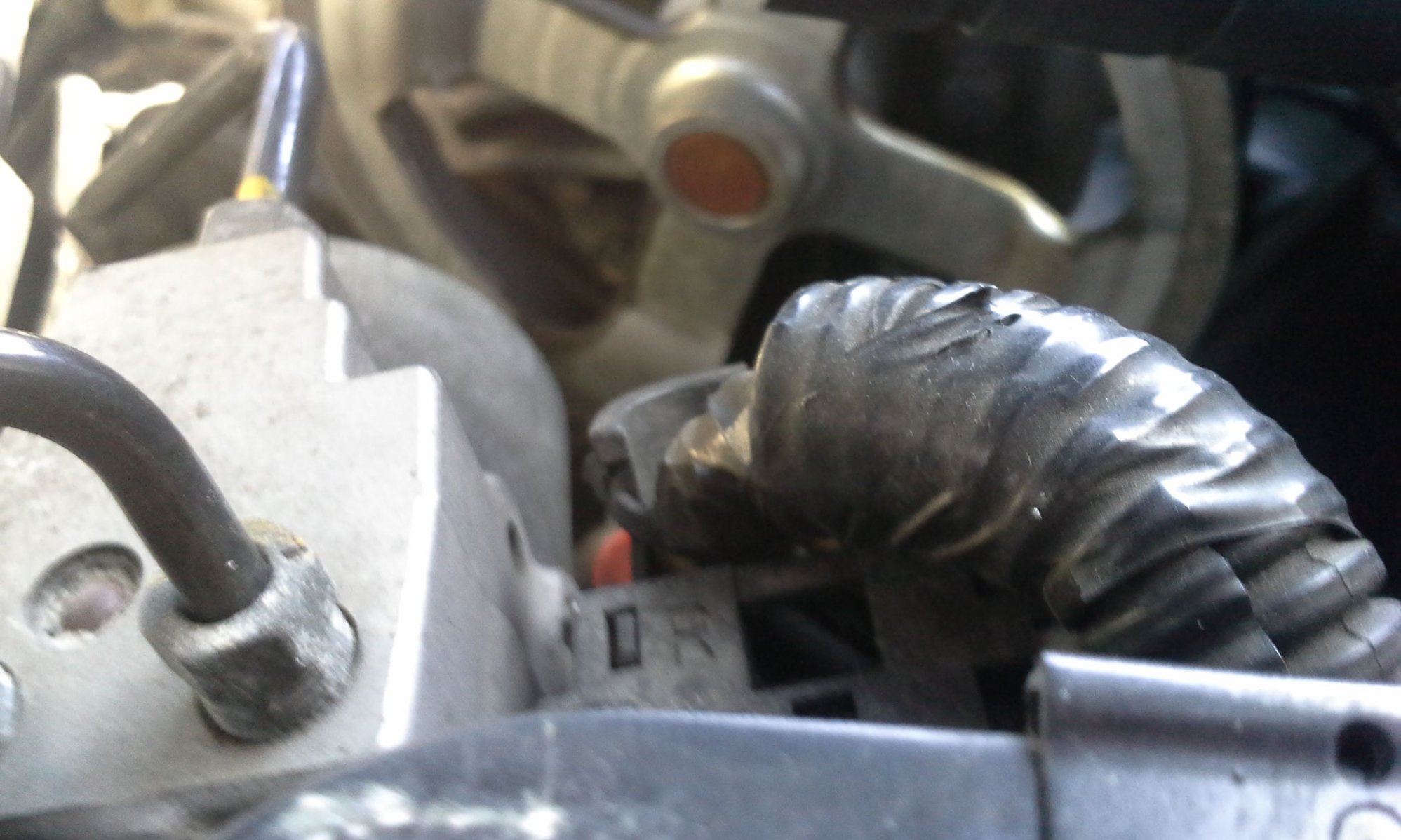

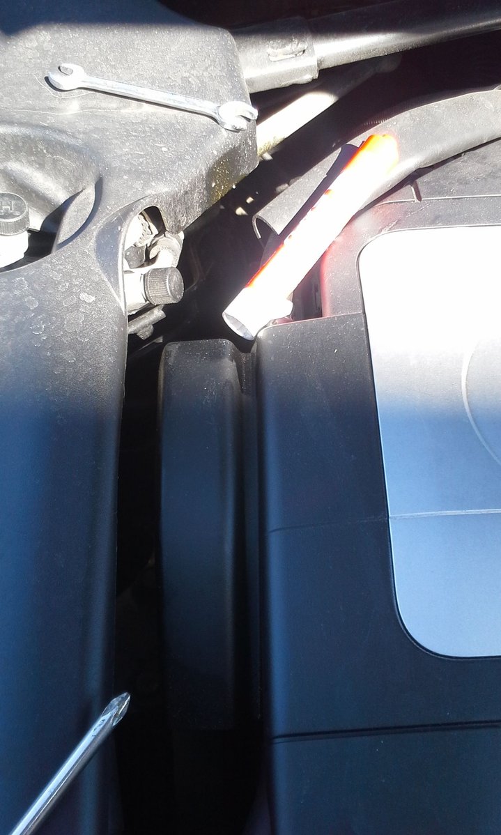

I do not see any cracks
This covers the belt pulley it has a coating (wet) of fluid
The pulley has some wet spots on it
