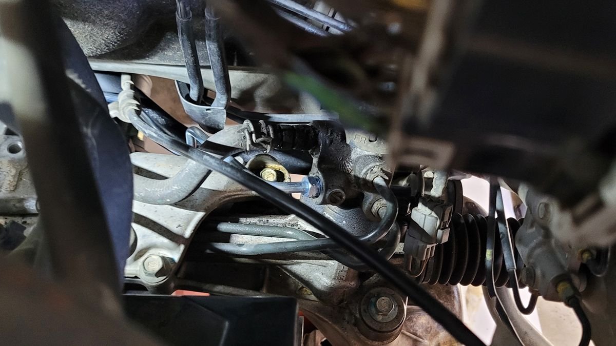

Replacing this line isn't fun. Would not recommend. I have even more respect now for the guys that build and repair these V6 motors. The limited access makes everything so much more difficult.

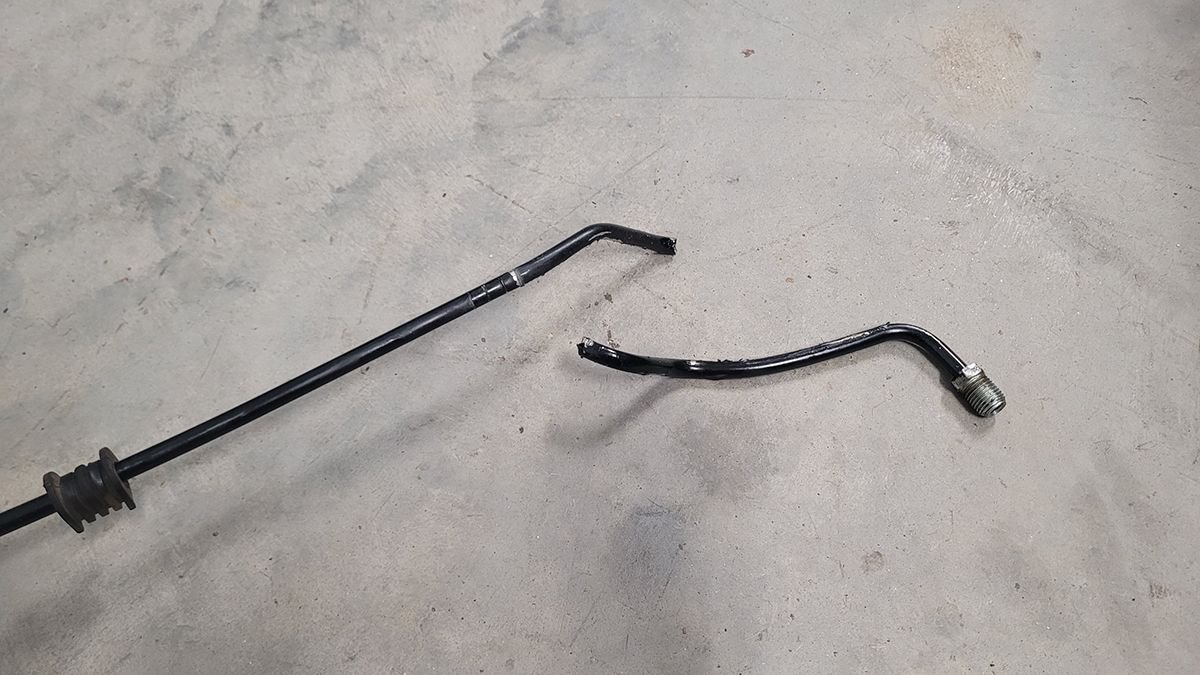

There's a youtube video where a guy replaces the feed line on a 2G RL, but he didn't show how he actually removed it or installed the new one. My plan was to get the old one out without destroying it so that I could be certain that the replacement was able to be installed without bending the hard line. I'm a little worried that if I bend the line, then the flare fitting won't line up correctly and I might end up with stripped threads and/or a leak. I tried to snake it out with the rear motor mount still in place, but the "U" shaped section right before the flare fitting got hung up between the subframe and the sway bar. It was hung up so well that removing the rear motor mount didn't make any difference and I ended up just cutting it.

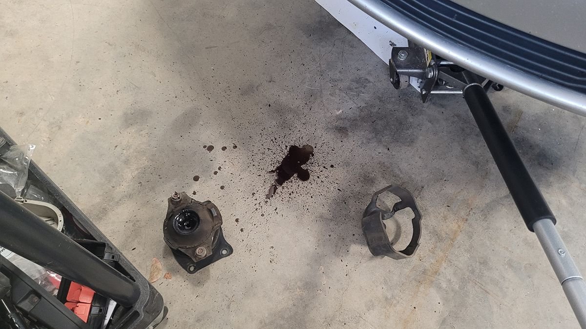

Getting the engines weight off of the front mount is fairly easy. I just put my car jack on the oil pan and lifted it ~1/2". The motor mount was completely shot. I pulled it out from the engine bay and while turning to place it on the tool cart, I must have been holding it sideways. The top of the mount fell off and a black oily liquid spilled all over the floor.

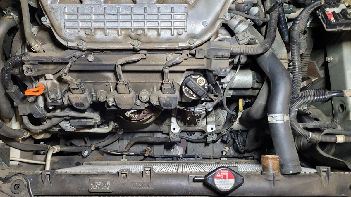

The new feed line went in without any drama. Get used to laying across the intake plenum on your chest. The aftermarket flare nut fitting uses a 9/16" wrench instead of the usual 14 mm. I didn't have any SAE flare nut wrenches, but my old school hot rodding neighbor had a set that I was able to barrow.
The front and rear motor mounts have been replaced. The passenger side mount was completely broken like the front mount, and I believe the transmission mount is also broken just judging by how much movement can be see when jacking up the engine. The timing belt is ready to be pulled off. I think my oil leak is actually coming from the oil pump now that I've dug into it a bit further. Now that I'm this far into it, I'll remove the pan and oil pump, check the clearances and reseal everything.
I went to pull the spark plugs out so that the engine would be a little easier to turn over and found that I have the dreaded deteriorating valve cover problem.
