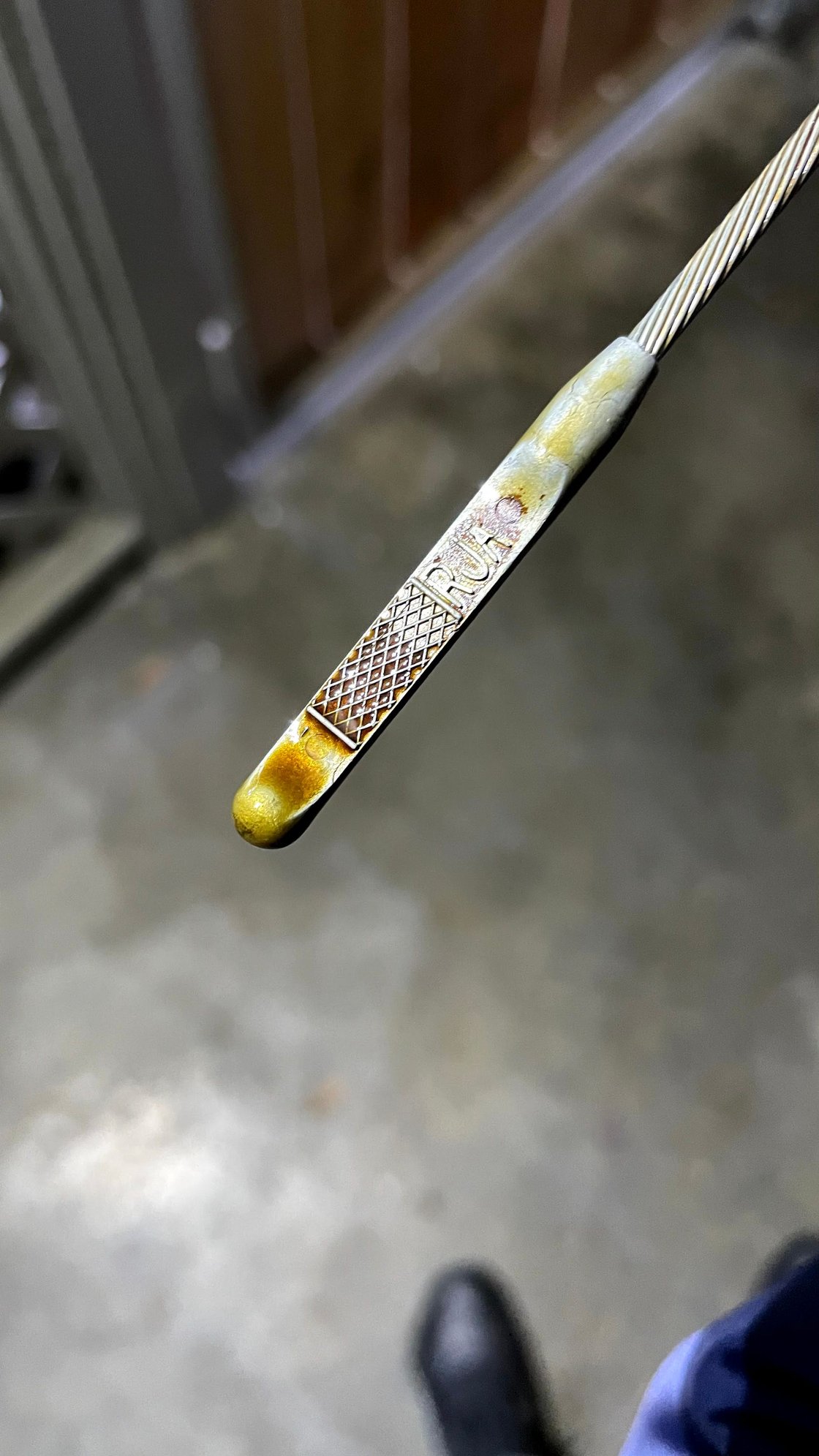

Hey guys!
Couple of questions:
1) After driving about 1500K miles, is this normal color for the oil? The car should have Acura's 5w-20 Synthetic Blend motor oil in the engine.
2) If anyone changed oil at the dealer, do they fill oil up to the full mark or similar to my example in the image below?
Car had ~ 111K when I took the measurement
Reply 0
Looking at the condition of the dipstick and knowing that you have 09+ RL. Yes, it is consuming oil
Reply 1

Quote: Looking at the condition of the dipstick and knowing that you have 09+ RL. Yes, it is consuming oil
I took a reading today of the oil level and when car is warmed up it shows similar level as it did 1200k miles ago. When car is cold it shows lower level. In the second image I added almost 1/2 quart of 5w-20 synthetic blend oil and now it seems to be full. I guess will have to monitor and see what I get. The burnt oil mark on the stick got a bit cleaner, but the other side of the dipstick is clean.
The issue is that I don't know what oil(conventional/blend/synth) Acura uses for their oil change but I do know that before I bought the car it had 5w-20 synth blend put in by the dealer. Even if the car consumes some oil, it doesn't take more than half quart between oil changes. Today is the first time, I put some oil in 2700K miles, just to be on the safe side.
Before adding oil and car is warmed up
Added some oil just in case

Jan 4, 2021 | 08:33 PM
It starts to burn more oil after 3k miles, I do not recommend to go over 3k miles on j37 engines with low tension rings.
Keep in mind, burned oil will not just go out through the exhaust, carbon will attach it self to pistons and valves-heads.
Reply 1
