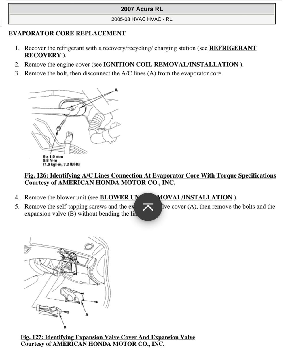

My question at this time, is there an evaporator at the rear passenger vent, and is there access to the front evaporator without tearing into the whole dash.

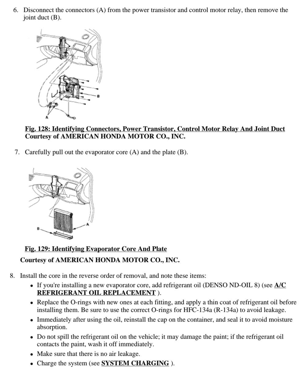

There's only one evaporator core which is located in the dash. The service manual makes no mention of removing the dash to access it. You'll have to remove the glove box and it's frame, along with the kick panel to access the blower unit.

All signs are pointing to the evaporator and now feel a bit more confident that I should be able to change it out if needed.
