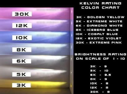

20,000k...
If your description is accurate to the product you bought, I am willing to bet just about anything your bulbs are worthless.

A 20,000K bulb would be the lighting equivalent of a sub-sonic dog whistle. Your brightness rating would be LESS than those incredibly stupid yellow bulbs that riceboyz stick in their Civics. Go 4300, 5000or 6000K or go home before you kill yourself or someone else.

OEM HID bulbs are 4100 or 4300K. I don't remember which exactly. Have the SA pull another Acura up next to yours and compare the light against a wall. That will tell you right away.

The kelvin rating should be the same on both bulbs. If one bulb is changing colors, it's going bad. Usually if that happens, you replace both bulbs so the color is the same on both sides. OEM on a lot of vehicles is around 4300k, because that's your best light. Anything too much more or less and you start loosing light output.
