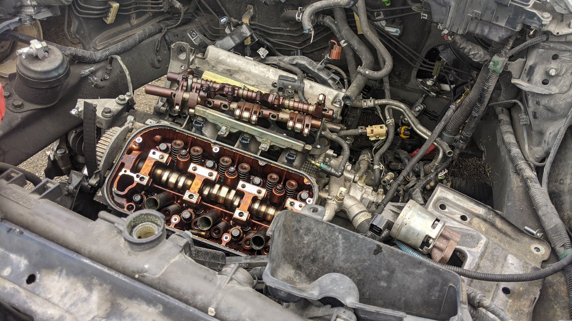

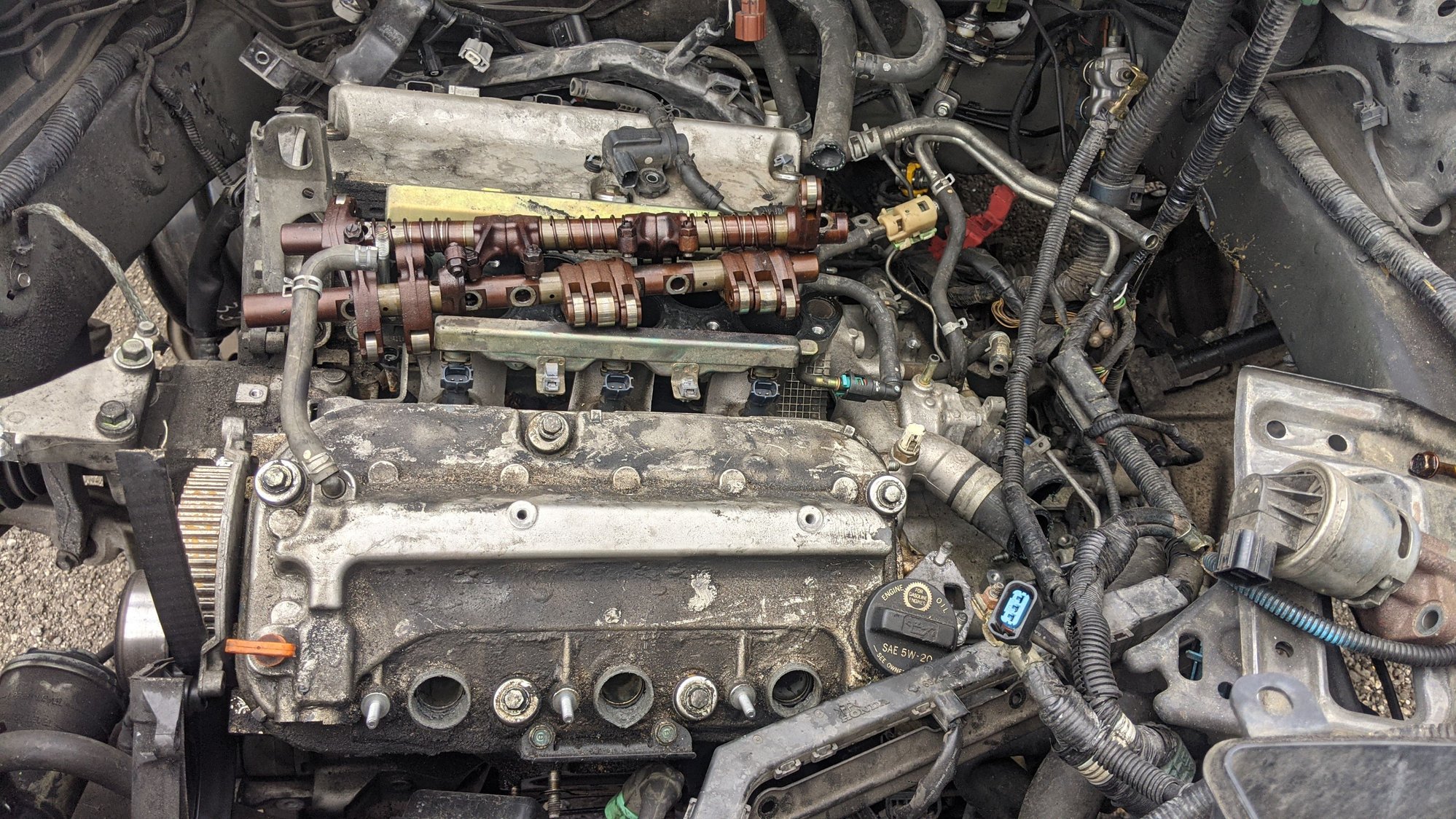

Ended up attempting to retrieve said camshafts but didn't have a pulley holder to hold the camshafts sprockets/pulleys
Anyways I got as far as I could without taking them out and wanted to make sure that these camshafts were prime for the picking and maybe there are possible warning signs I might want to be weary of since I'm pulling these off a junkyard vehicle.
So here are a few photos I did put the valve cover back on with the bolts incase it rains or something before I comeback with a pulley holder. Lmk what your thoughts are.

Honestly it looks like oil wasn't changed very often looking from the dark brown color of engine or maybe this is a high mileage engine. Either way you would want to measure the cam lobes according to factory manual to check the wear and tolerances.

Meh, they don't look any worse then the $42 salvage yard RL cams the guy below paid.

Glorygang600, you aren't paying more than $42 are you? Besides, it's all a 'roll of the dice' when utilizing junk yard parts. Make a command decision.
Good Luck!
