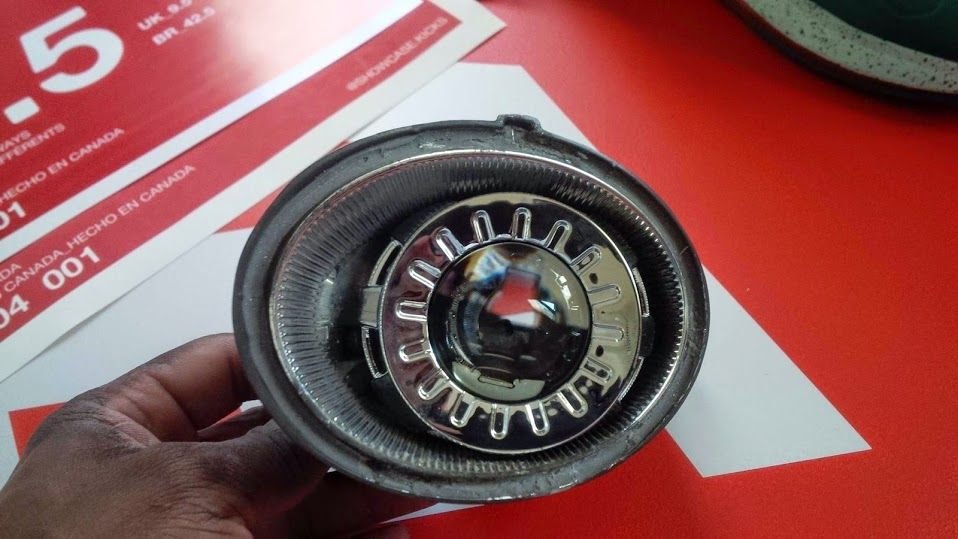

This is where I'm at so far. This is the one that was broken. Im using it to test fit. I have 2 other pairs to work with, which is why I want to try to get the glass off clean. It looks like I'll have to use the Lexan. I'm planning on either painting the shroud and housing black or LSM.

Old Mar 24, 2015 | 09:46 AM
oo7spy's Avatar
Joined: Dec 2010
Posts: 31,897
Likes: 7,251
From: Austin, TX
Old Mar 24, 2015 | 09:51 AM
projektvertx's Avatar
Joined: Apr 2012
Posts: 2,690
Likes: 614
From: Buffalo Grove, IL
Looks good!
Old Mar 24, 2015 | 09:58 AM
NathanJax's Avatar
Joined: Dec 2014
Posts: 274
Likes: 109
From: Jacksonville FL
Will be interesting to see if you can fit the drivers side back in since there's hardly no space behind the foglight
Old Mar 24, 2015 | 10:27 AM
ChocBoyWonder's Avatar
Joined: Jul 2006
Posts: 567
Likes: 76
From: Toronto, ON
It will fit. These don't protrude from the back. The smallest projectors (I believe). Everything actually fits within the housing. I'll take more pics the deeper I go. That was simply a test fit. The back of the housing needs to be shaved a bit to fit the bulb holder along with the glare ring holder on the inside. Shaving is going to take the longest since the housing is metal. I'm aiming for a week.
