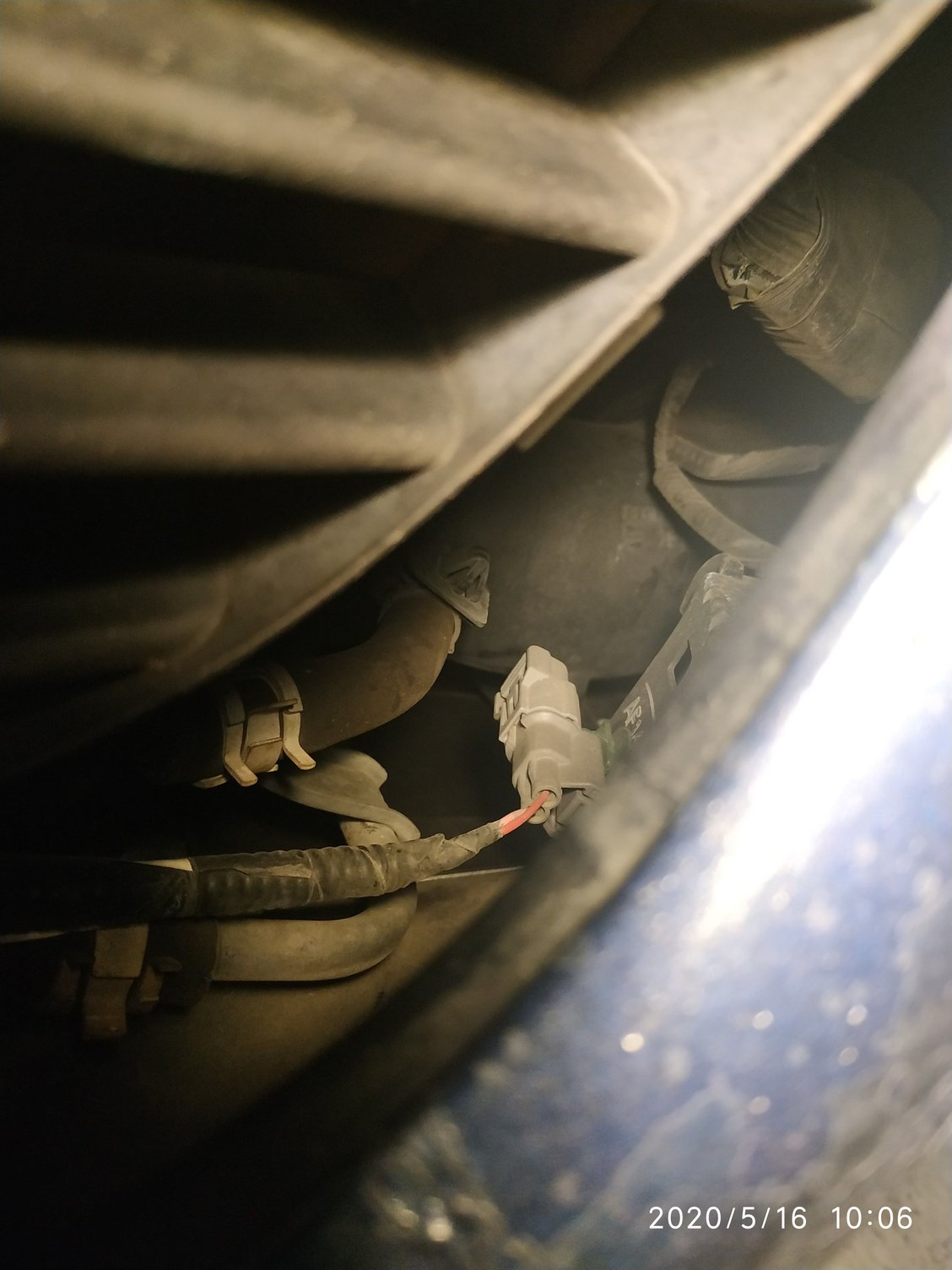

Old May 3, 2020 | 01:54 AM
specagent992's Avatar
Joined: May 2020
Posts: 81
Where is the outside temperature sensor? If it's not too much trouble can you post a picture and show the connector wires that you fixed?

Old May 6, 2020 | 09:38 PM
Joined: May 2020
Posts: 81
I pulled the sensor through the grille but the wires look good. What else can cause the sensor to not work? I have no other electrical issues, except the HFL that draws 0.22 amp with the ignition off.

Old May 7, 2020 | 02:31 PM
Joined: May 2020
Posts: 81
The sensor's continuity tested 1.75K ohms at room temperature which I think means it's working. Are there anything else to test for, maybe a fuse? The A/C and auto climate control works as expected, but the outside temp gauge reads --- aka flatline.
Old May 16, 2020 | 05:00 PM
Joined: May 2020
Posts: 81
It turns out that the wire to the gauge is missing. That's why my outside temp sensor doesn't work. Where can I get this wire?
