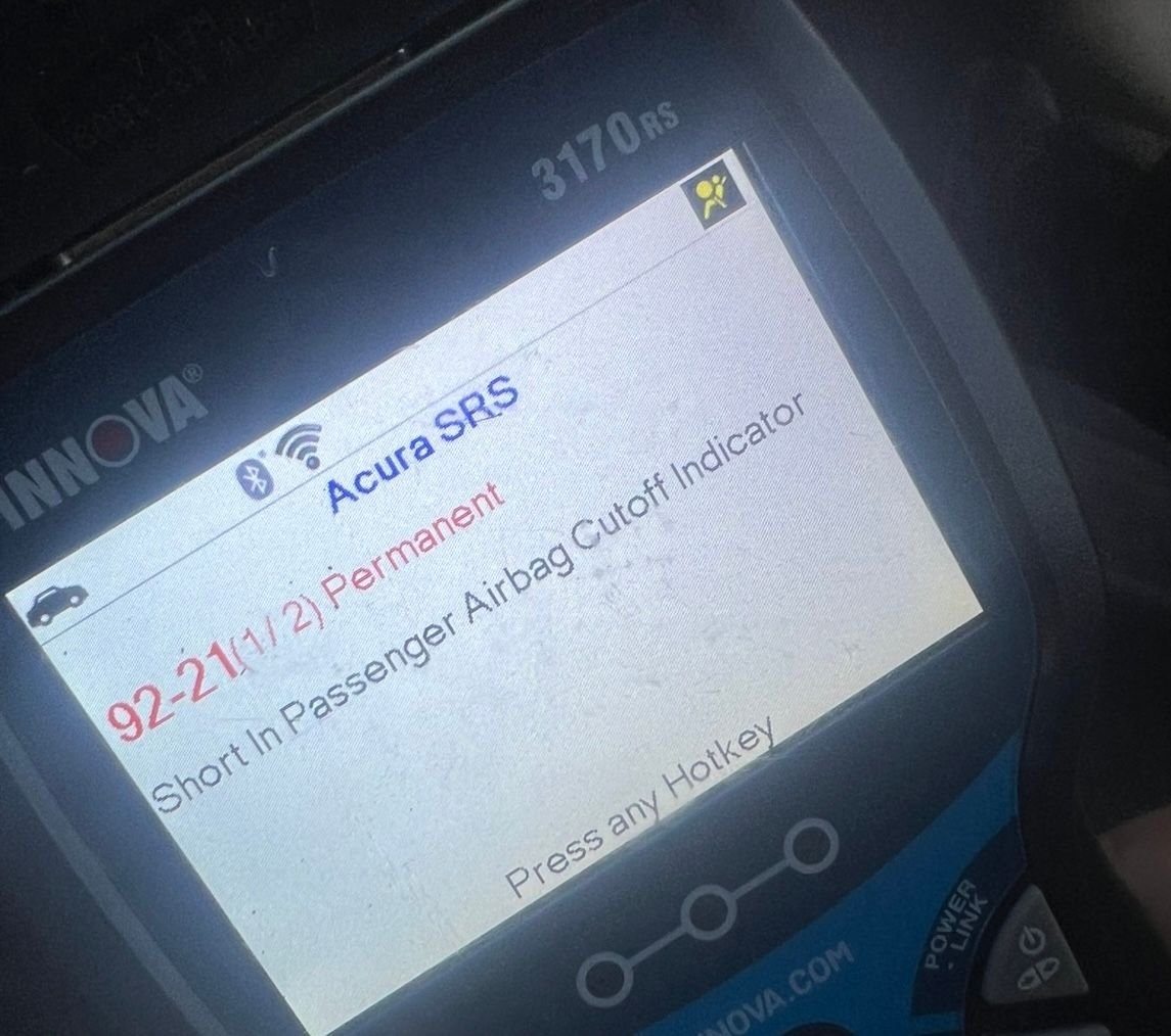

Airbag light on car for passenger cutoff indicator. Took whole seat out reconnected it blew out the seat belt light. This error is off only when nobody is in the seat and it’s buckled. I’m stumped.if someone sits in it buckled or I unbuckle it get this error again. .

There is a weight sensor in the seat - I think the airbag only activates if there are <some amount> of KGs sitting in there. There is a process to calibrate that sensor, search previous threads.

Looks like the HDS is needed for calibration process?
Calibrating the Front Passenger's Weight Sensor Unit

Other diagnostic tools can often complete these calibration processes - I have an AUTEL AP200 that I use with my phone, and there are a whole bunch of calibrations available in there, I successfully calibrated my Steering Position Sensor in the past. I can't remember if the Seat Weight Calibration is in there or not, but there was another thread with a guy who successfully did this procedure with a non-Honda diag.
You'll need a diag that has dedicated Honda modes, it won't be present in a basic generic OBD2 device.
