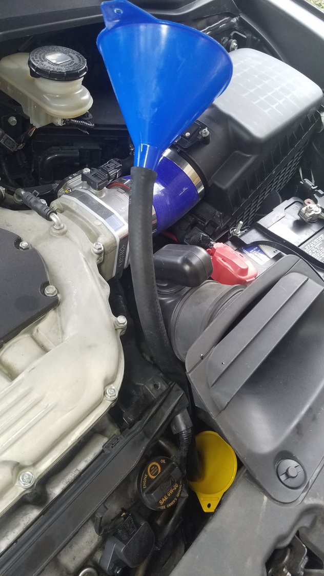

Maxlife ATF is incredible. Much smoother shifts up and down, better timing and the shudder is gone. It's like getting a new transmission. And that after just the first of three changes. Granted, it may be that it just really needed a change and OEM ATF would have had the same effect. But I'm happy either way.
Sludge on the plug
Nasty
Refill through the dipstick hole
