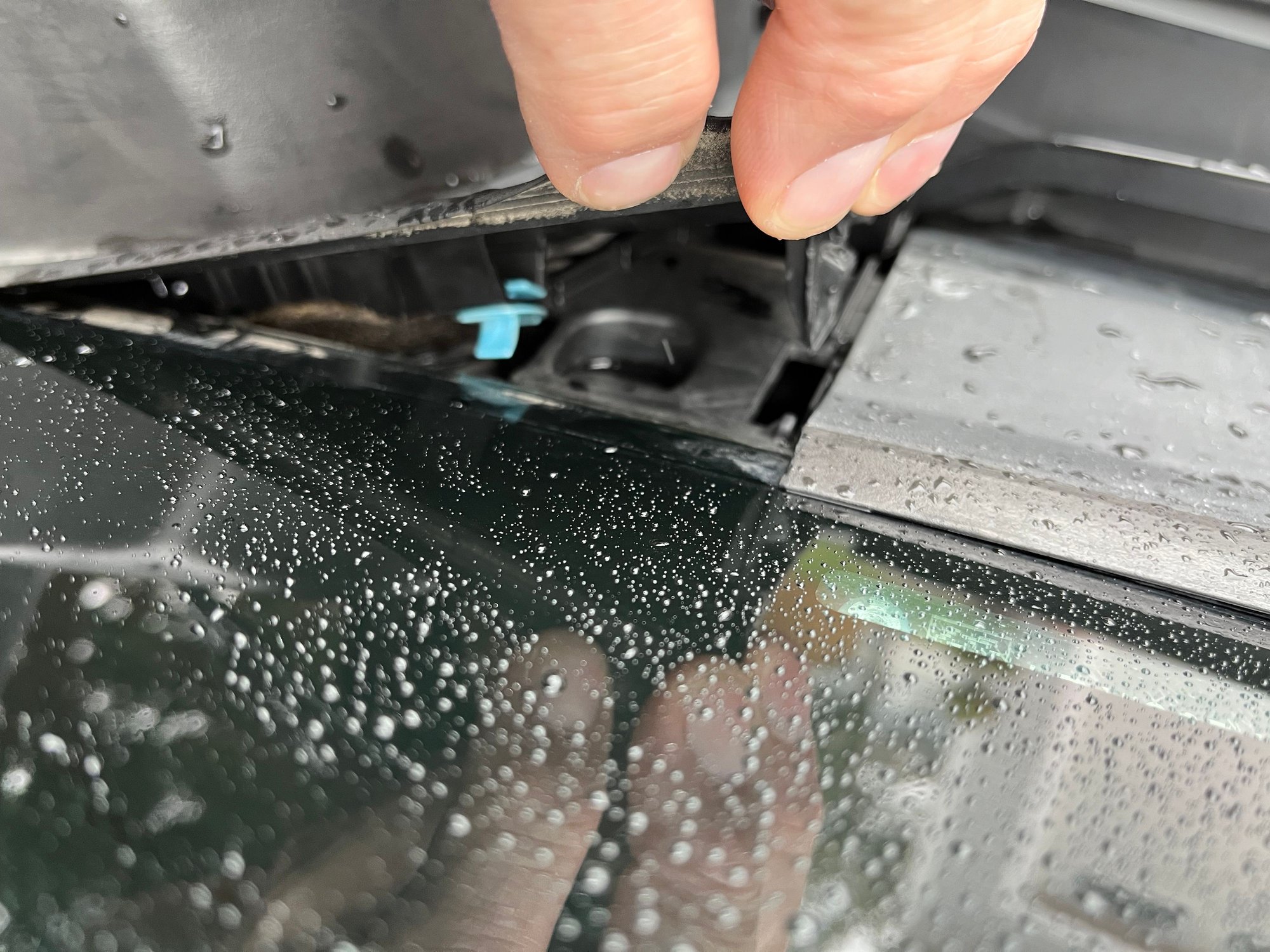

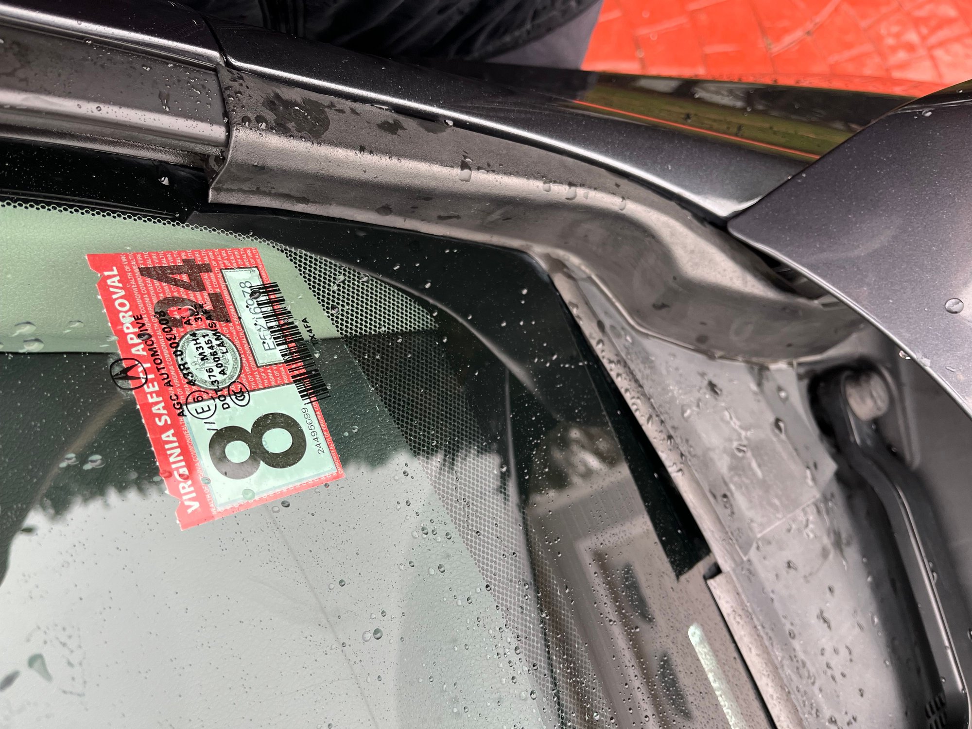

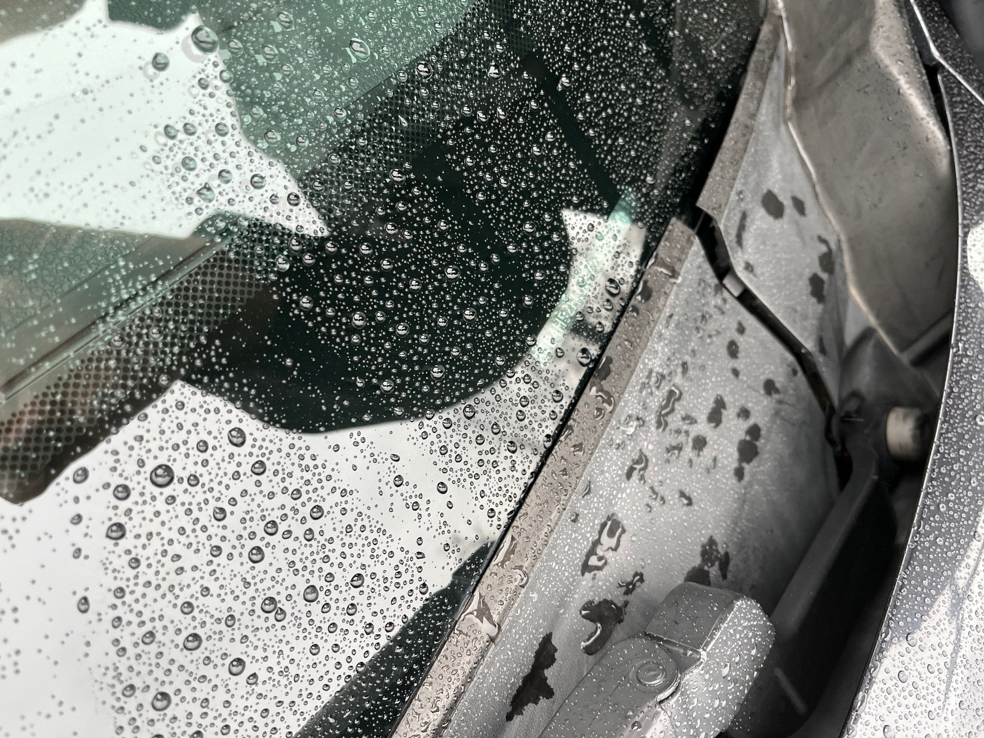

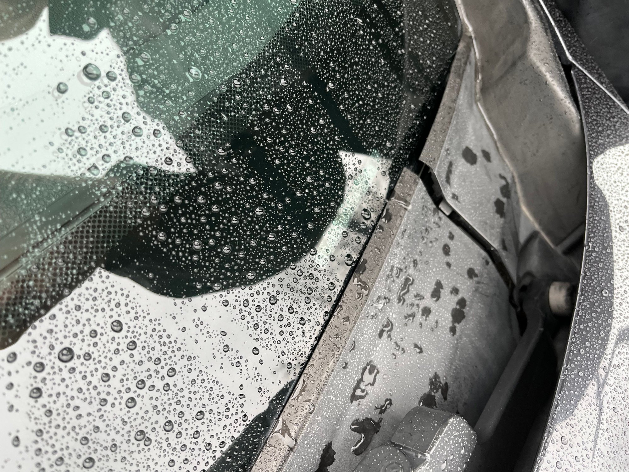

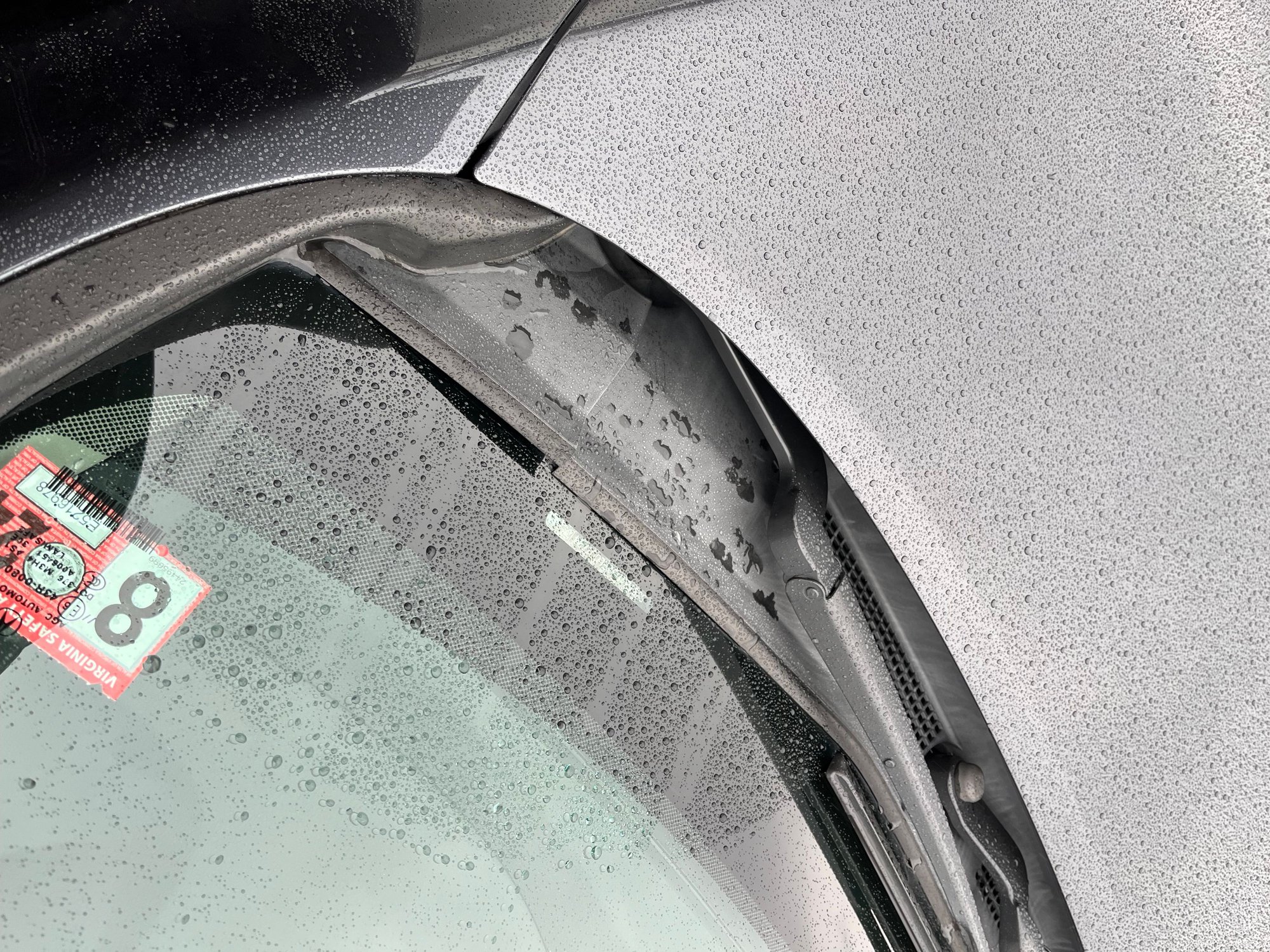

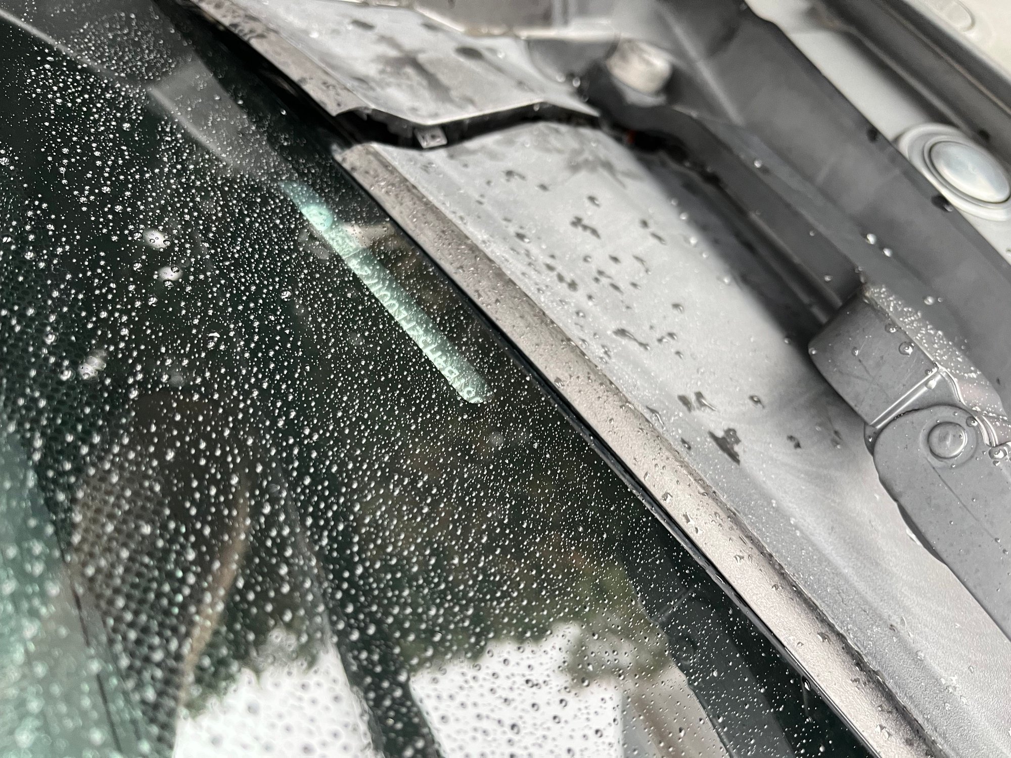

Part is on driver side near front wipers. It pops up whenever I drive. Pushing it down locks it into place temporarily. The car had some body work recently on driver side front fender and headlight. Any ideas on a fix?

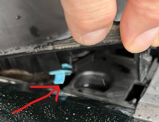

Looking at that blue cowl top clip, it appears to be broken?
It should look like this one:
You can find it on the link below as #20. Google search the OEM part number, you may find it cheaper?.
Engine Hood - 2015 Acura RDX 5 Door BASE (2WD) KA 6AT (acurapartswarehouse.com)

Zeta, thank you! I ordered on Amazon, Rexka aftermarket, gets great reviews

If you only need one go to a Honda or Acura dealer or even a body shop. They are only about $3 to $5 depending.
