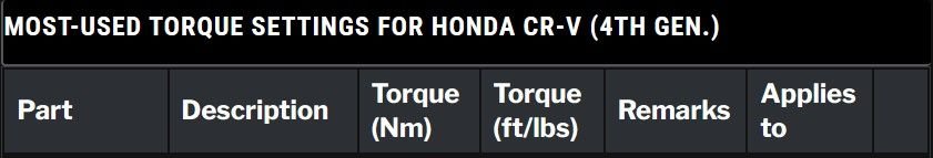

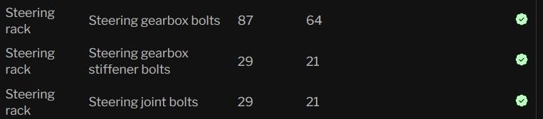

I could not find the torque values for the RDX, though, here are the values for 11-15 Honda CR-V.
These should be in the 'ball park'.
Torque Settings for Honda CR-V (4th Gen.) (2011-2015) - TightTorque
