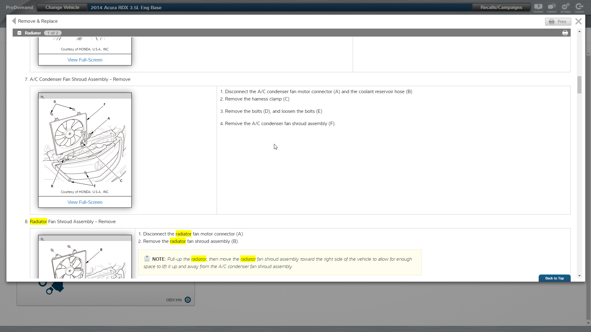

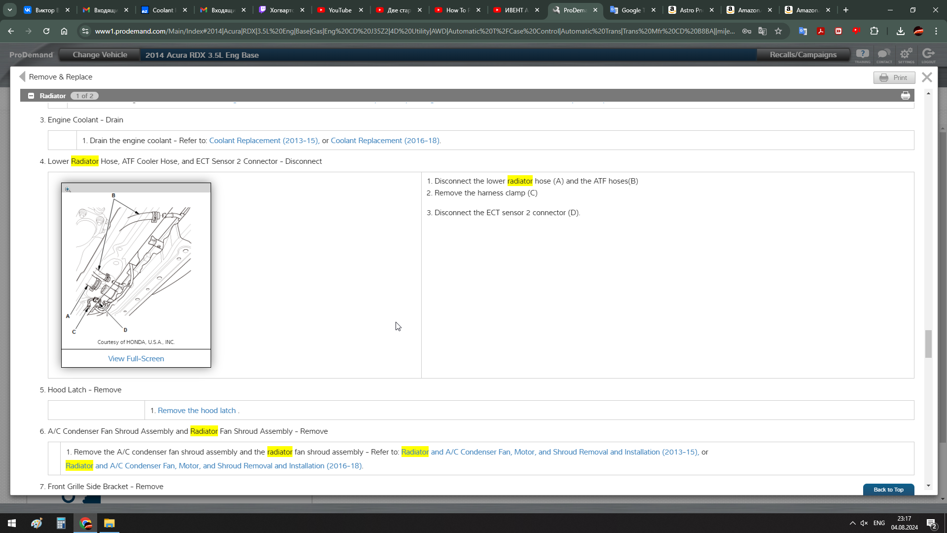

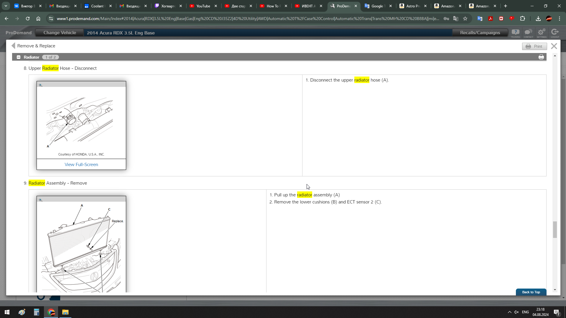

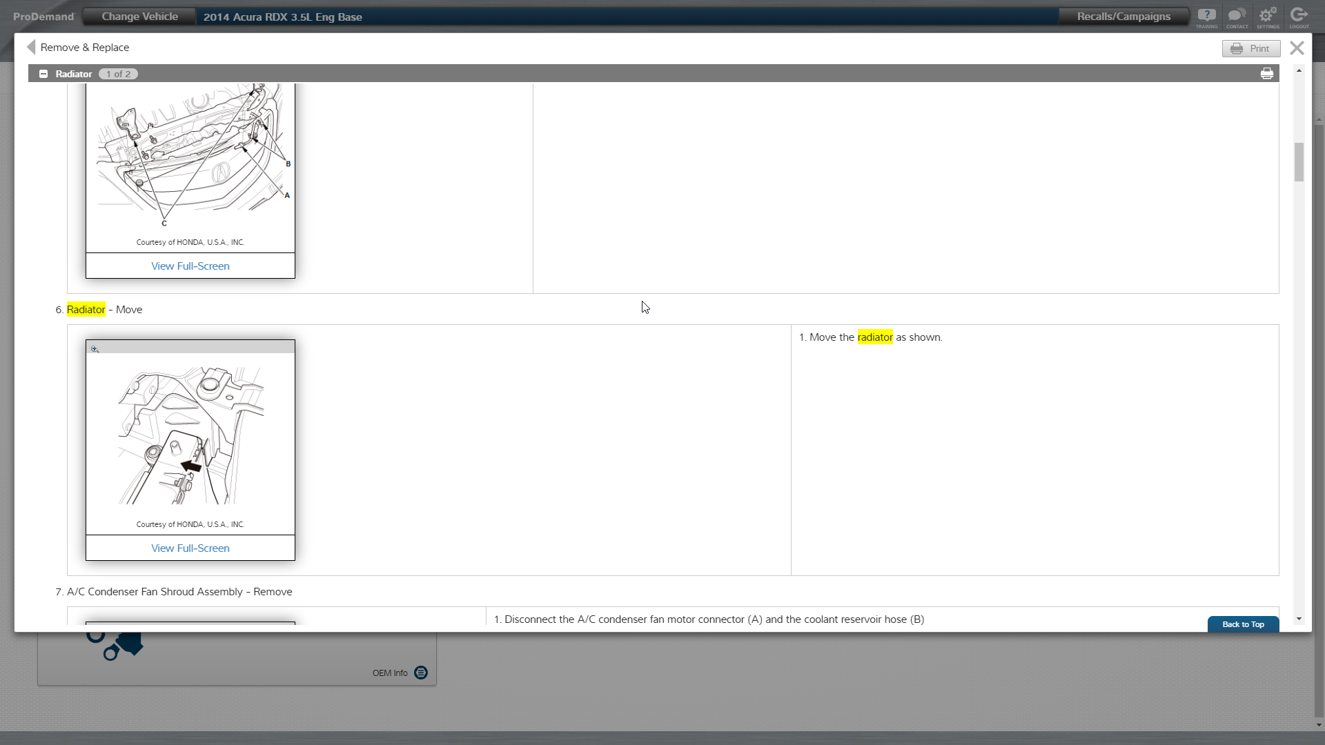

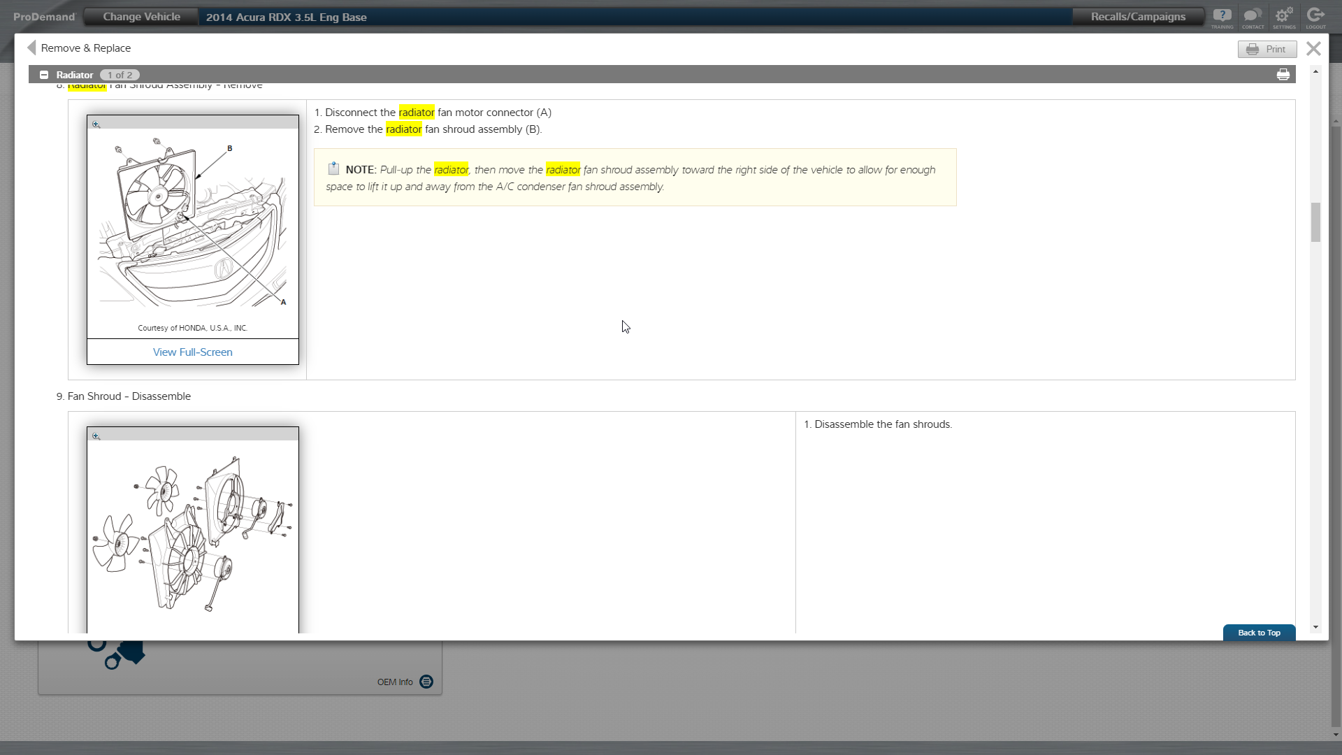

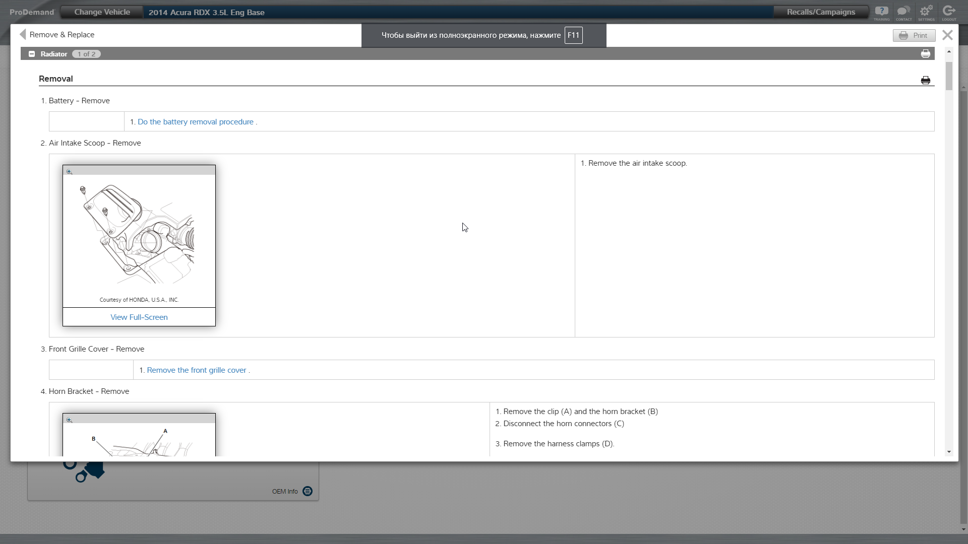

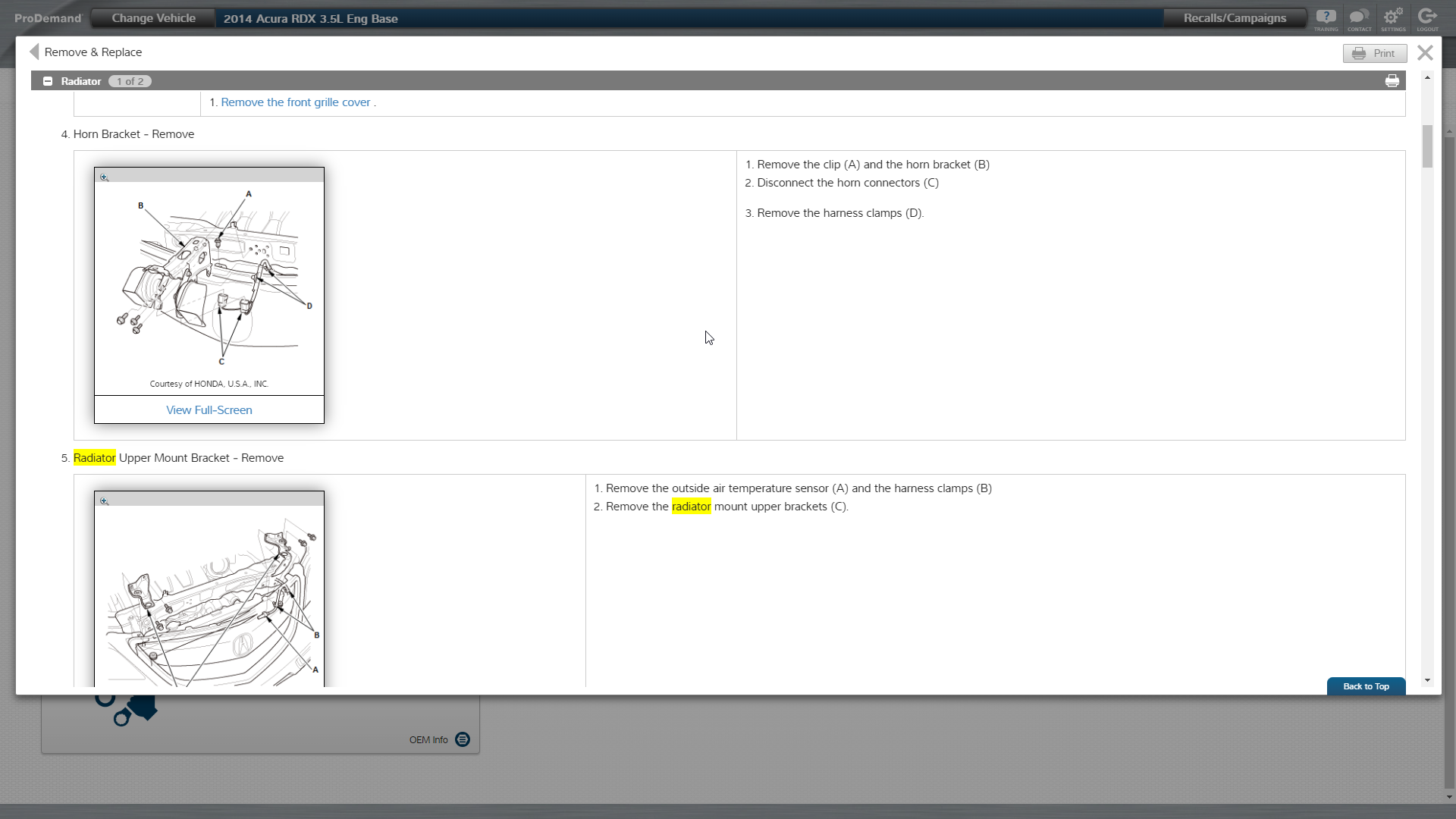

This is a simple job, you will need to pinch 2 thick coolant hoses and 2 transmission fluid hoses with Hose Pinch Pliers.
Amazon Amazon
Also order
Amazon Amazon
Then drain the coolant from the radiator, remove the front bumper and follow these diagrams.

It is absolutely not necessary to remove the bumper, but it is much more convenient without it.
