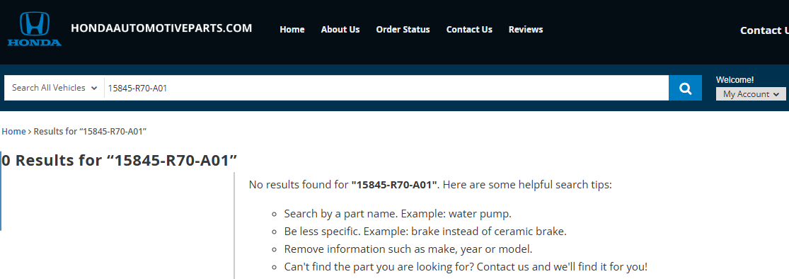

I was interested to see if I could actually find the 15815-R70-A01 screen gasket and / or the 15845-R70-A01 upper flat gasket via a U.S. online Acura / Honda part websites. ETCG stated he did this in the first video on the subject.
The results below were consistent with the below:
When this occurs, I immediately go to amayama Japan to once again cross reference to get any available data, if any, as to status.
It appears that at some time these two gaskets were in 'production'; however, now they are out of production and considered 'discontinued'.
Further proof that 'any' red labeled Acura / Honda package with these gaskets, found on the interwebs, is either repackaged Dorman 918056GS or Mahle GS34049 or a foreign land knockoff.
