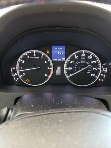

Seems like an odd combination of signals/codes simultaneously. "Check Emission System" light came on yesterday, so I ran OBDII scan and the only code was P0128, which is "Coolant Temperature Below Thermostat Regulating Temperature," and coolant temp remains below regulating temp even after driving for awhile.
Initial research is that the thermostat is likely stuck or broken in the open position, so not overheating. But the Emission System light, too? One source online says P0128 can trip other things, and another says to check air intake and coolant temp sensors. Since thermostat is mechanical and not electronic, it shouldn't be affected by a bad sensor should it?
Thanks, all!
eta: My shop has an opening to drop by for a look, but I'd like to be armed with any thoughts from here if possible.

Has your temp guage been lower than normal after driving it for a while?
Old Feb 25, 2026 | 04:53 PM
jim's acura's Avatar
Joined: Sep 2024
Posts: 48
Likes: 25
Yes, but gets close to but not quite normal when idling. My local shop said it's the thermostat. He wants $400+ for diag and OEM replacement t-stat + new coolant. I told him I want OEM Acura t-stat, which is $140 for Acura vs. $25 for aftermarket part.

What's stopping you from starting a cold engine and, as it warms up, touching the heater core the hoses and the hoses on the radiator?

OK, did that. They eventually heated up to normal operating temp, but took nearly 15 minutes of idling in garage with heater off to get to normal operating temp. Coolant is circulating fine, and temp gauge rises but very slowly. So, I take it that the termostat is stuck in the "open" position. The "Check Emission System" light and chime came on just a few seconds after starting the engine, even after clearing it, and of course stays on. That symptom arose at the same time as the stuck open thermostat.
Edit to add: Actually, I started it with the heater on, but turned it off after several minutes to get engine to come up to temp.

Simple and quick diagnostics, and you don't need any temp sensors.
It's amazing that the original thermostat lasted almost 250k miles.
