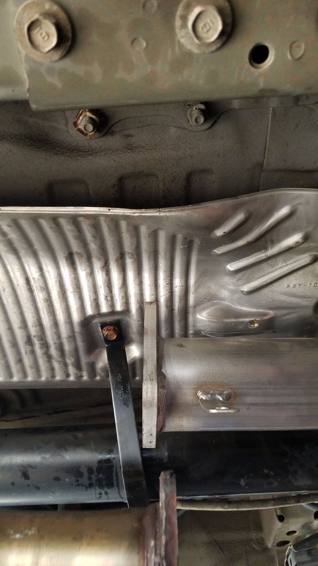

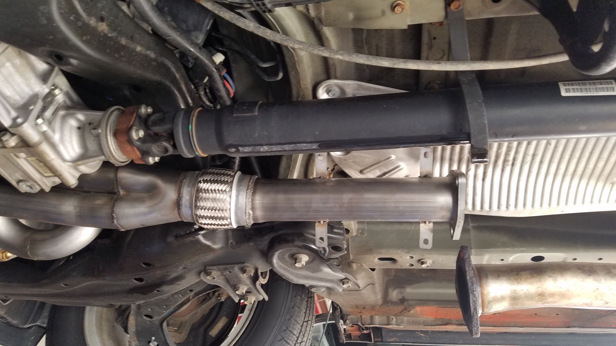

Install took about an hour. Sounds incredible when you get on the gas and about the same at idle. Here's what it took to get it on...
OEM:
It fit, except for the mounting bar, which was easily removed.
Collector about .75 inch too long and totally different flange
Solution: Cut it off.
And slip in a section of 2.5 inch stainless pipe.
Finished product:
And a video:
The butt dyno tells me I gained about 10HP above 3,500 in exchange for some low-end torque. A very worthwhile mod.
