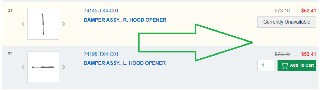

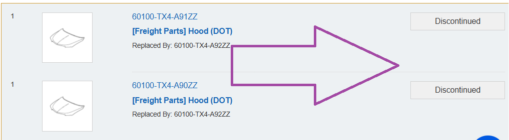

You can easily compare & contrast the differences yourself, for potential fitment, by analyzing the OEM parts diagrams from an online vendor.
The 2G RDX model year ranges from 2013-2018, with that said...
*Any 'number' designation for each component below that does not have a square 'dotted line' box surrounding it indicates the part is either 'discontinued' or does not relate to the specific 'trim level' selected.
Your 2014 RDX Tech FWD trim level has the (red) #8; 'Hood opener stay' associated with the (purple) #1; 'Hood' currently listed as 'discontinued' below.
The hood opener damper assemblies (yellow) #31 & 32 are not designated for your trim level; therefore, they have no square 'dotted line' box surrounding them.

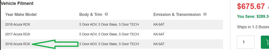

The first 2G RDX year (that I can reasonably determine) offering the hood opener damper assemblies (green) #31 & 32, with the designated #1 Hood, is 2016.
As a result you have three considerations?
1) Purchase an appropriate trim level 2016-18 RDX Hood & damper assemblies to test fitment on your 2014 Tech FWD?
2) Open your 2014 RDX hood and determine if the (right / left; upper / lower) damper 'bolt bosses' are present (incorporated during 2014 manufacturing)?
a. If space permits & they are present, one may be able to 'drill / tap' said bolt bosses to accommodate the two upper / lower hood damper fasteners?
3) Purchase the components to alleviate / correct the '...somewhat 'detached' condition of your current #8; 'Hood opener stay'.

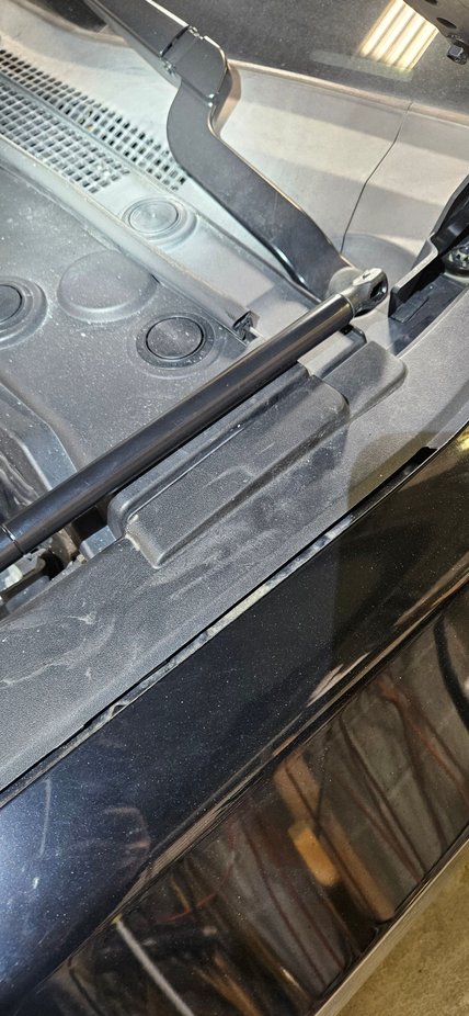

I'll try installing it on my 2013 RDX as well.
Amazon Amazon
Amazon Amazon
The total budget is $32.
Old Feb 1, 2026 | 06:34 PM
altair47's Avatar
Joined: Jun 2016
Posts: 1,867
Likes: 599
I drilled a hole in the cowl panel and inserted a ball, but when closing the hood, the gas strut hits the plastic panel, so it's not as simple as it seems. It didn't work with the 2013, We need a new cowl panel from 2016 and side covers. That already comes out to $350, not $32. I don't want to ruin or cut up the original cowl panel and side covers.
