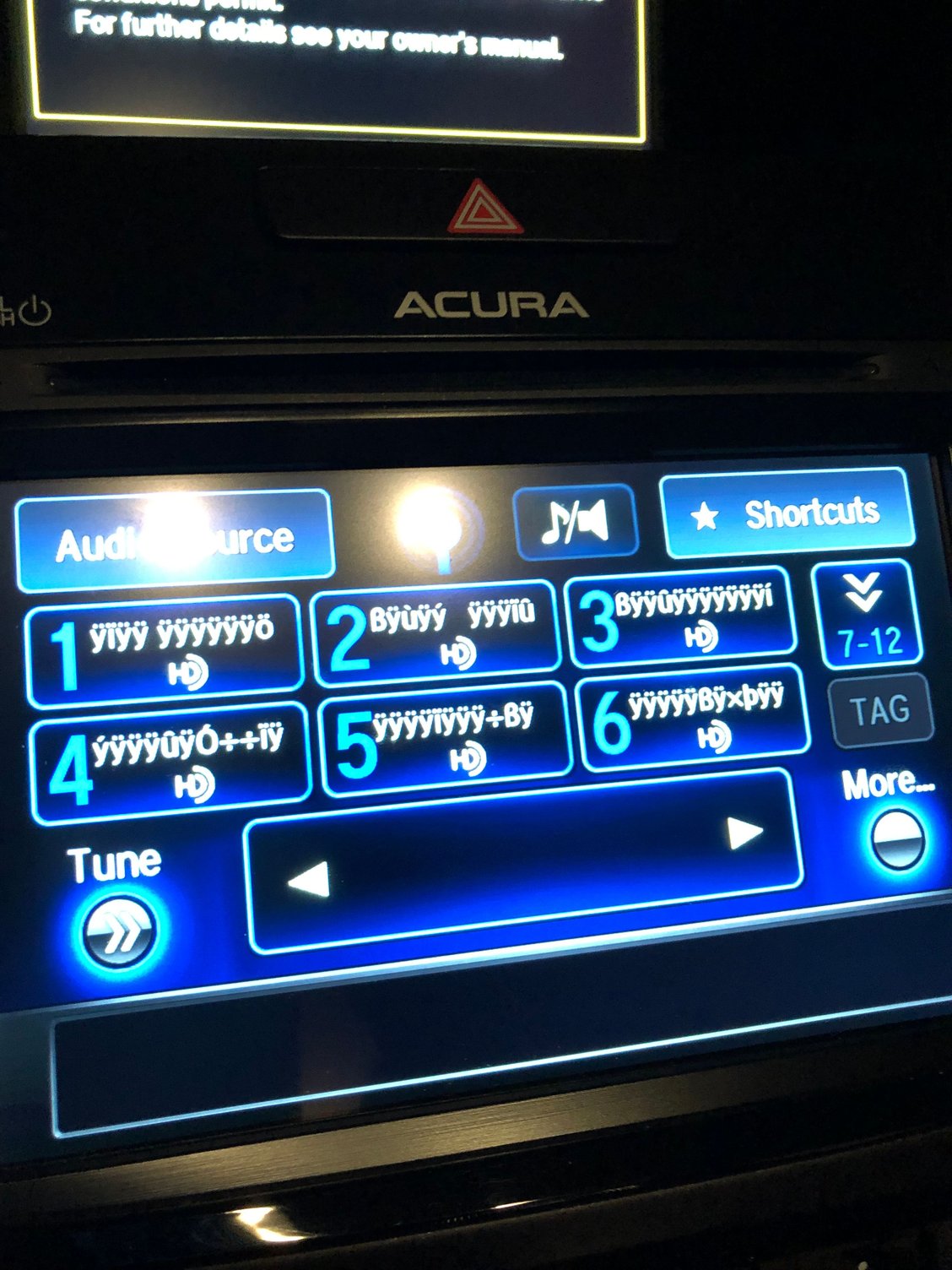

Strange characters displayed as stations when ignition starts
I have the Bluetooth on my iPhone on and the phone was previously paired with my 16’ RDX. When I start the car strange characters, mostly y’s are displayed as each station. It lasts for approx. 20 seconds and then my programmed stations appear. Has this happened to anyone? Thanks

I had the same problem with my 2016 RDX. I had the tuner unit replaced according to this TSB.
Mine was replaced for free under the warranty period. Yours may be as well, depending on when your purchased it.
