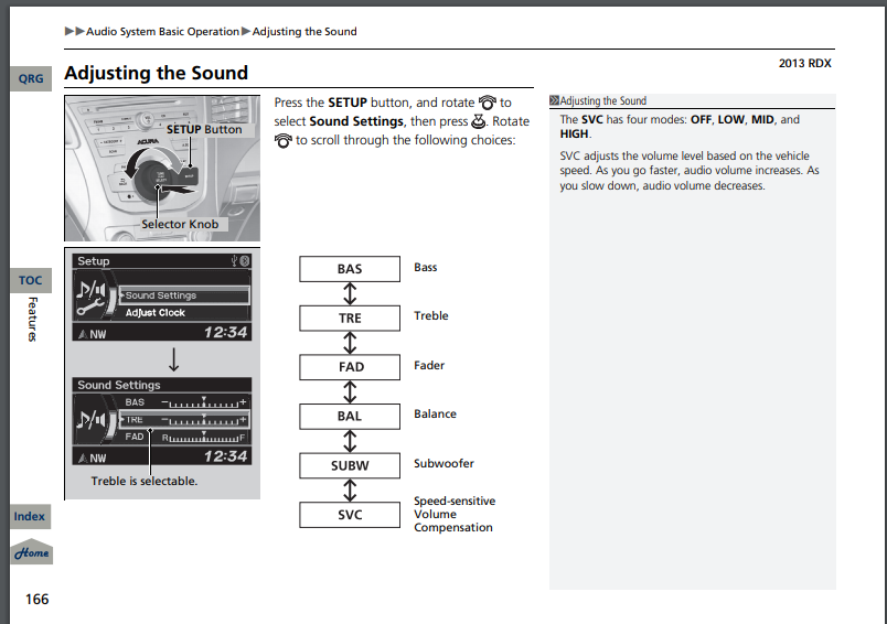

When driving the sound is great, but when I slow down. the volume reduces automatically. Is there a setting somewhere that I can keep the sound level constant?
Old Mar 9, 2018 | 09:44 AM
Posts: 48,302
Likes: 9,173
Turn off SVC
Read your owner's manual
