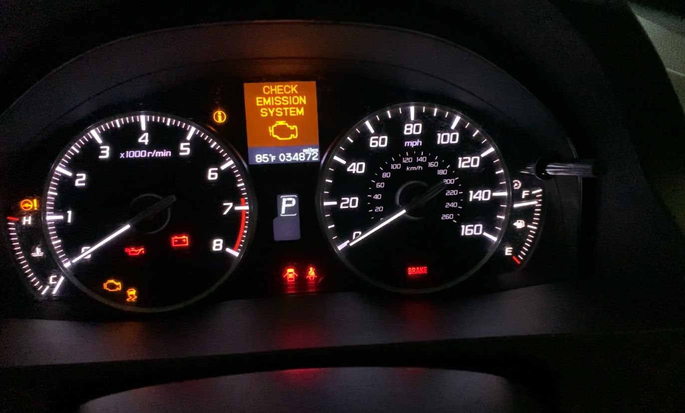

Hate for this to be my first post but I just got a 2016 and trying to install a dashcam so I removed a couple of fuses to check for ignition power.
When I set it to ignition On position these messages appear:
Check emission system/check VSA system/check hill start assist system/check starter system/check power steering system
Car will not start either.
I checked all the fuse I removed and they seem to be ok.
What should I do? Thanks for all the help.

Ok, i disconnected the battery for a few minutes and it seems to have fixed the problem

Did you leave the car in accessory mode while trying to install the dashcam?
Sounds like you just drained the battery, do you have a battery tender you can throw on to recharge it

No idea if this will work, but you may want to disconnect the battery and let all the electronics "reboot." I'm assuming you covered the obvious already and have put all of the fuses back correctly. I also have seen some folks mention that fuses that look fine actually had been tripped - so you might want to try replacing the ones you pulled with new ones
If you do go the disconnect battery route - you will want to make sure you have the radio code and if your RDX is so equipped - the navigation code.

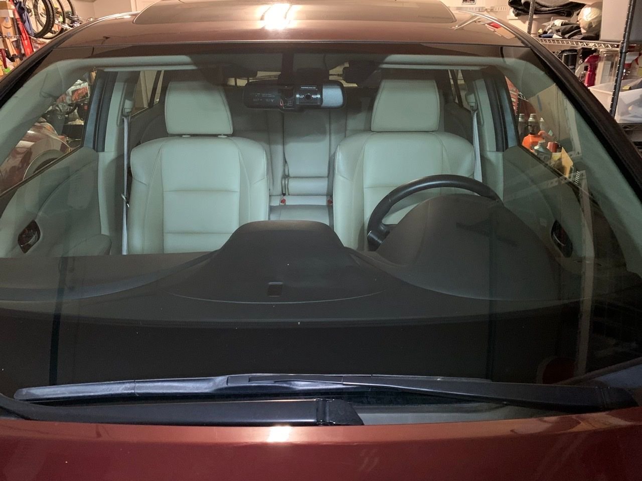

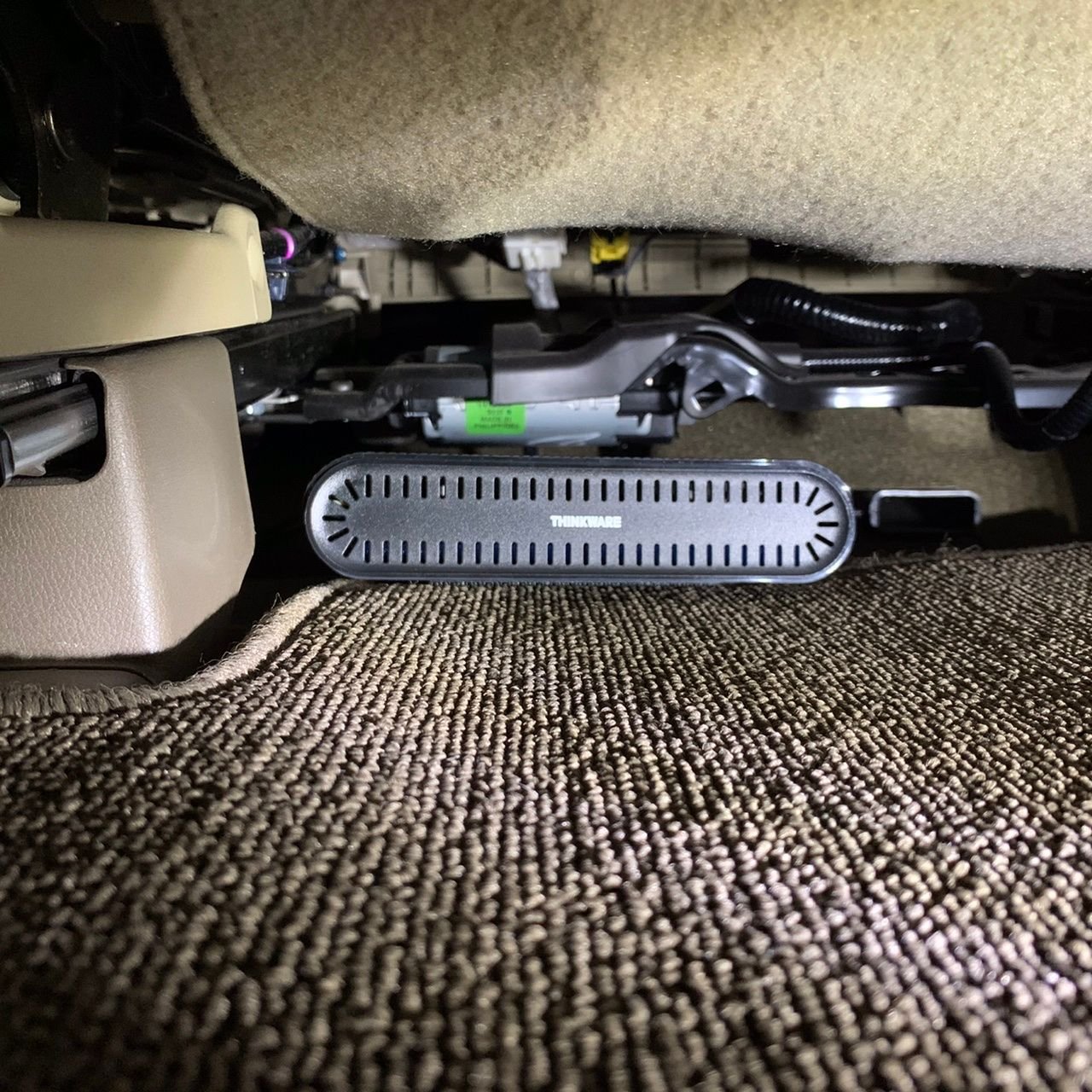

dashcam and battery pack now installed and working fine so far.

What worked as the fix?

Nothing unusual for an Acura to throw those lights and act up. Just disconnect and reconnect the battery.
Disconnecting the battery like I’ve mentioned in my second post 🙂
