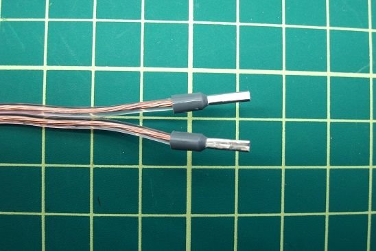

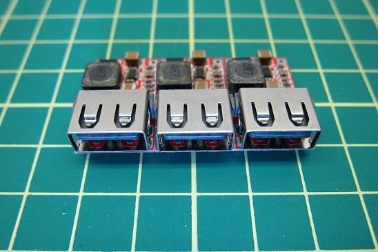

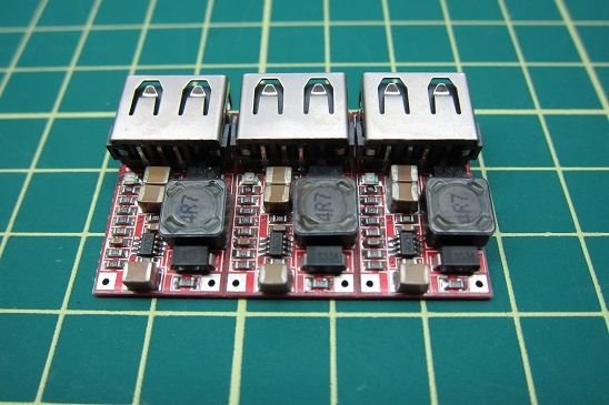

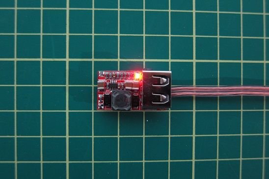

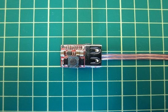

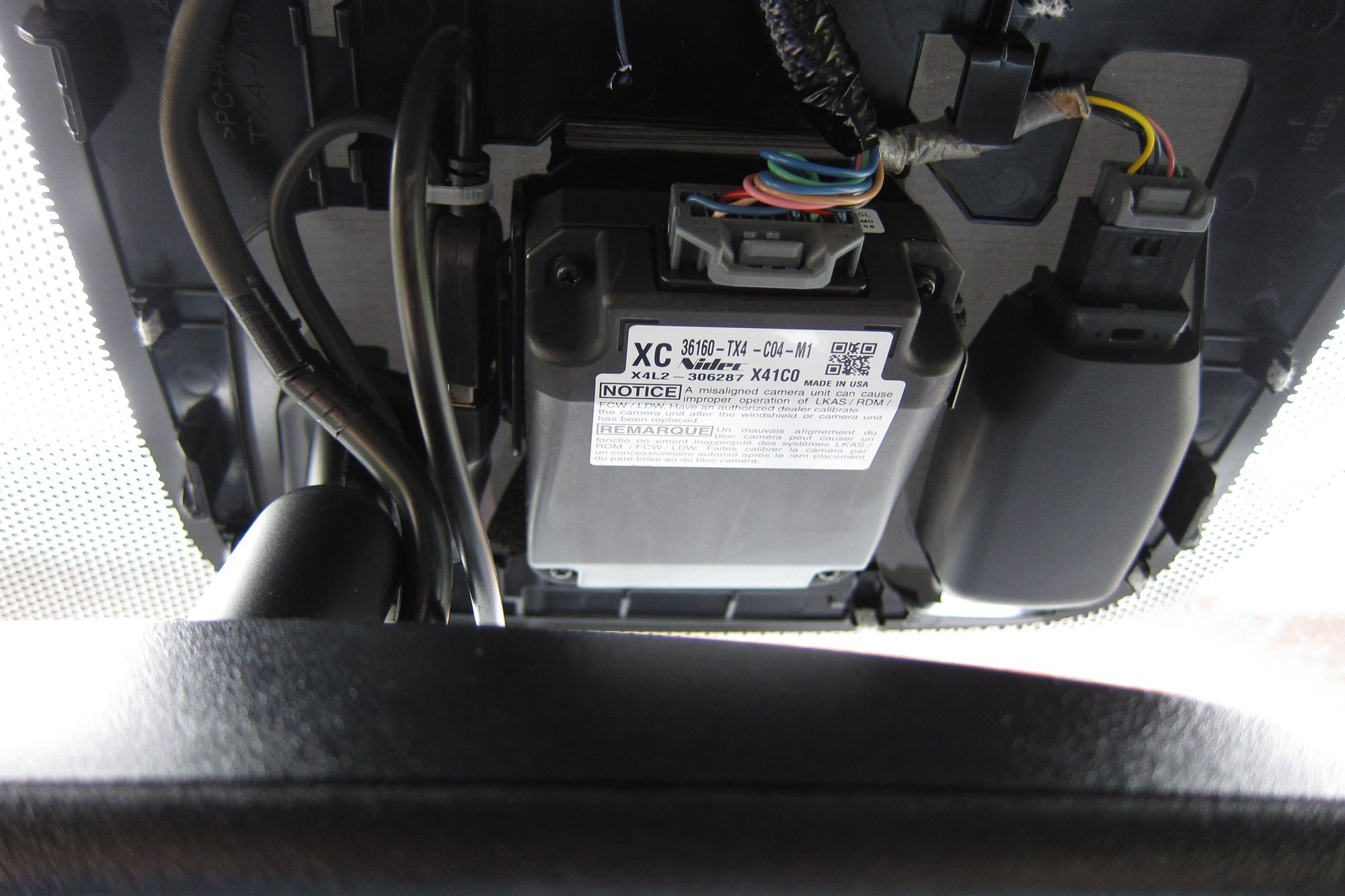

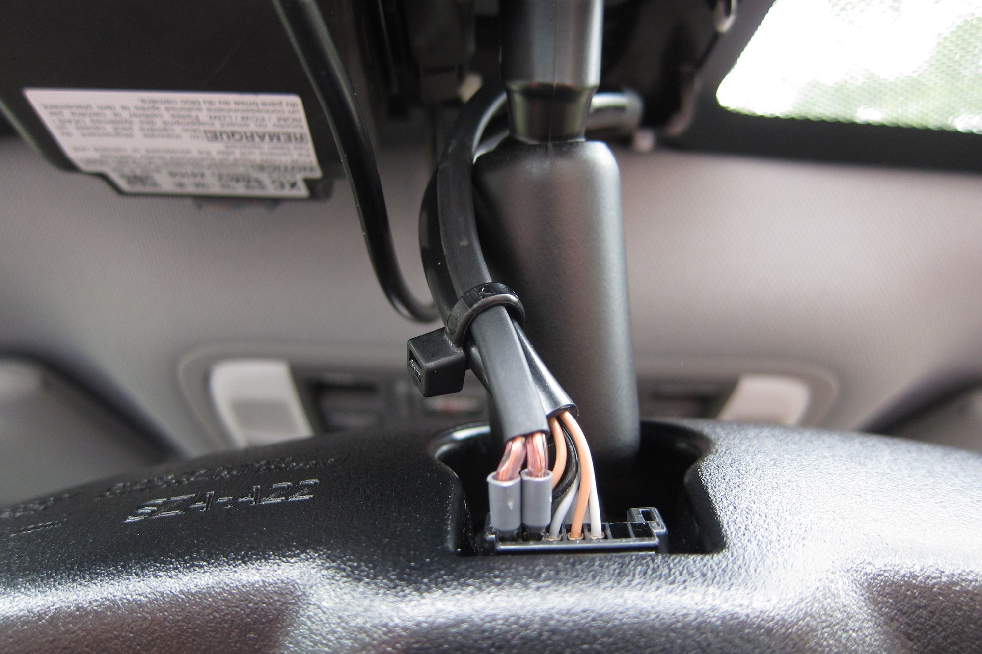

Amazingly with all the high tech crap they put on vehicles these days, manufacturers can't seem to install something as useful as a USB or 3.5 mm powered outlet at the overhead mirror/dome light housing that many cars have these days. How simple a dash cam or radar installation would be instead of running a cable along the headliner, down the A pillar, under the dash to some powered outlet.
Fixed!
For $0.99 each, I ordered a few of these off eBay for my vehicles...
A bit of soldering, crimping, testing and heat shrink applied...
And the finished product...
Not bad for about $2 per install plus a bit of my time.
