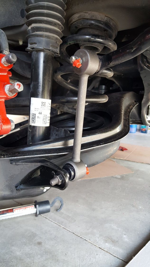

Here's what I did on my 2018 RDX.
I chose all stainless steel grease fitting @ 90 degrees.
Im away from home for family holiday. I can check the torque specs from the installation instructions when I come back home after the new year.
Rear sway bar.
Rear Prothane bushings. ** Dont forget ur Lateral Locks on the sway bar ! I installed them on the outside. Locks not shown in this pic.
Front Prothane bushing. Locks installed on inside of sway bar. Not shown in this pic.
Front Moog sway bar link.

Fronts:
Prothane 19-1164 Red 21 mm Universal Greasable Sway Bar Bushing fits A Style Bracket
@Suspension.com
dll122
Front Sway Bar Lateral Locks - 21-22mm
Moog Fronts:
83318002
K750667 - Front Driver Side Stabilizer Bar Link
Rears:
Prothane 19-1162 Red 19 mm Universal Greasable Sway Bar Bushing fits A Style Bracket
@Suspension.com
dll120
Rear Sway Bar Lateral Locks - 19-20mm
Moog Rears:
21649023
MOOG® K750380 - Rear Stabilizer Bar Link
Extra Parts needed:
McMaster-Carr
1) 1293K22 303 Stainless Steel Grease Fitting, 90 Degree Elbow, 1/4"-28 SAE-LT Male
2) M8 Stainless steel washers (Oversized), b/c 4 are needed for the Front Bushings.
Good luck!
