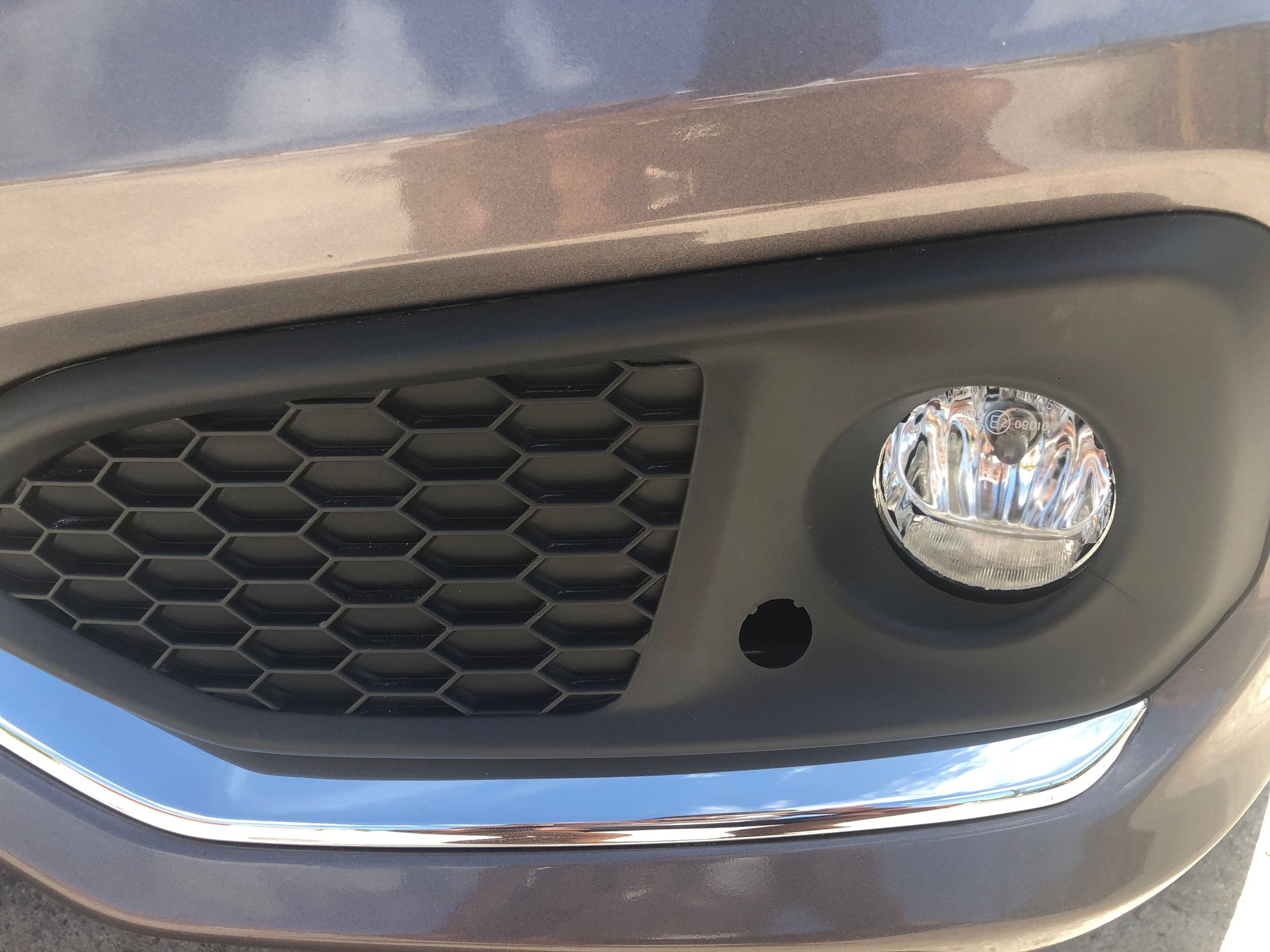

Anyone know the name of the sensor that goes in the fog light bezel? Or the part number?

I don't have fog lights, so no such hole, but I would guess that it is either for an auto-dimming sensor if your car has that technology for the headlights, or more likely for the ambient temperature sensor--the location for that is about what I would expect.

Posting the model you have would help...
I would speculate that it is a parking sensor. Only standard on advance models. Called Elite in Canada?
I think that the ambient light and forward collision sensors are behind the mirror.

https://www.acuraoemparts.com/v-2017...parking-sensor
Looks like number 15, Parking Sensory Assembly
You'll need number 9 and number 11 also.
Hopefully the wiring harness isn't damaged.
