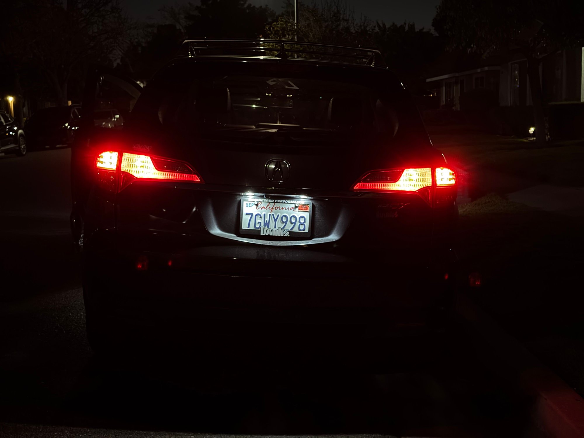

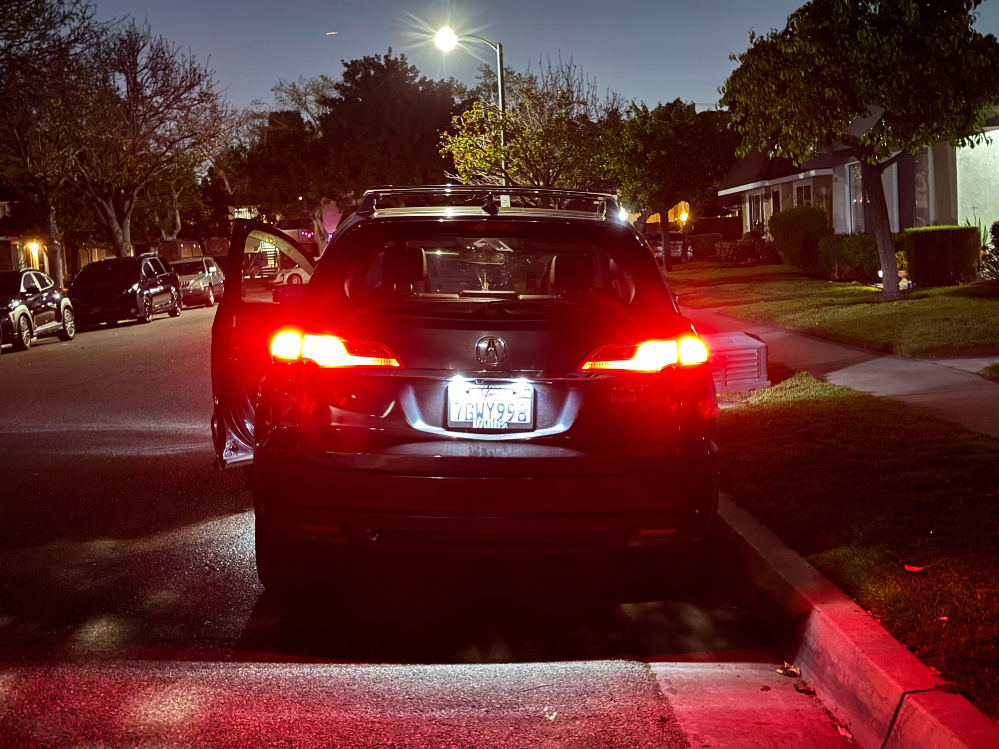

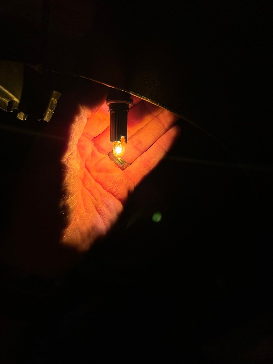

Had to replace one of my Chinese red running lights because it was acting finicky. Replaced them with those Red Philips Vision ones. They click into the socket much more securely and work like a champ. Finicky red running lights fixed.
Center red light both with Philips Vision Red 194 LEDs Outside brake lights are Sylvania Zevo 7443 LEDs

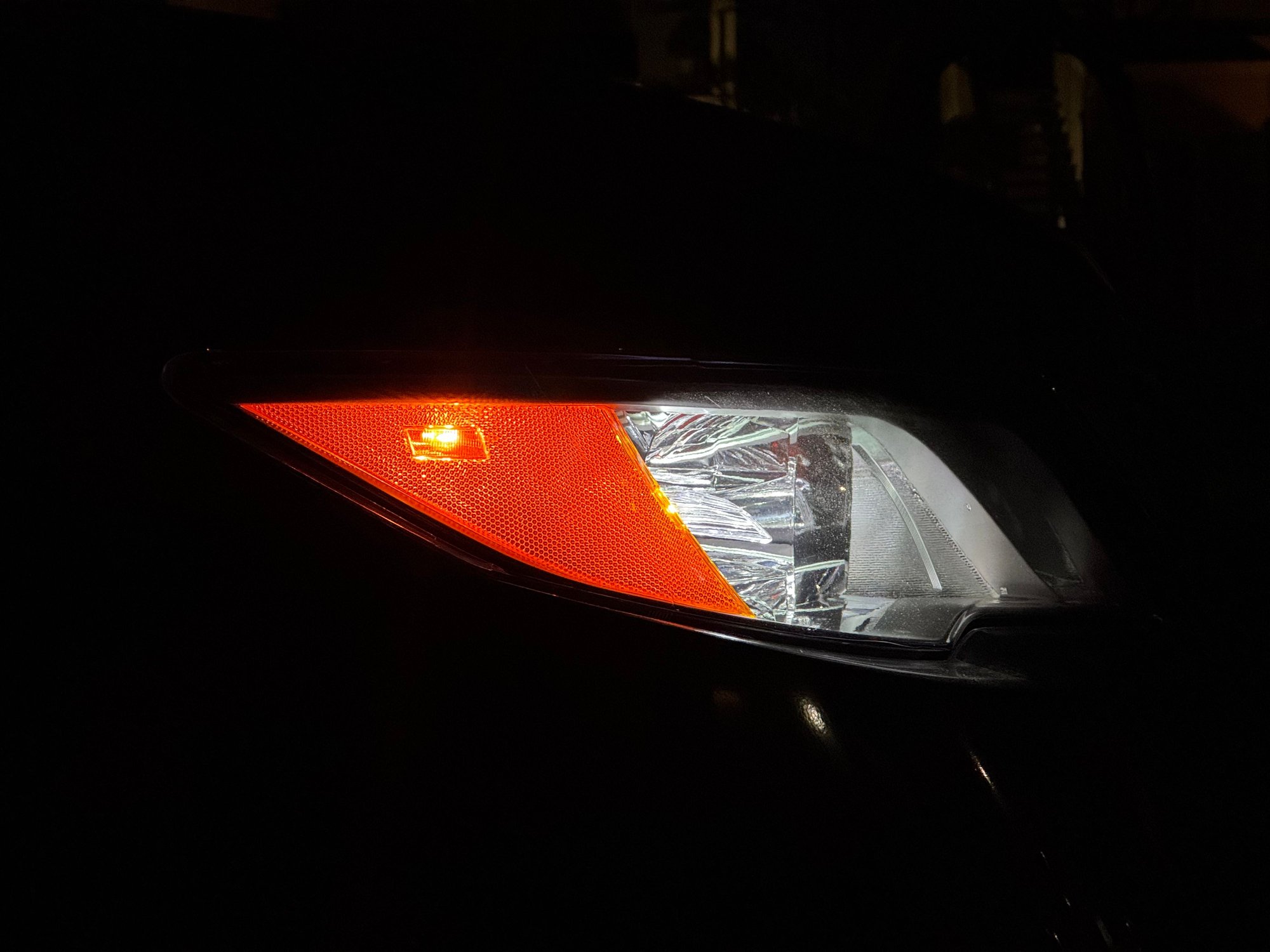

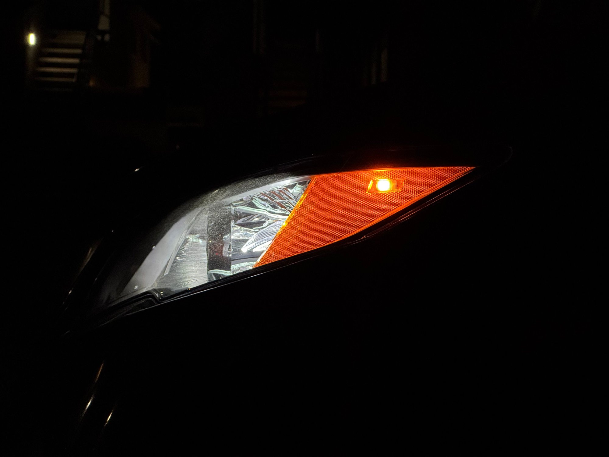

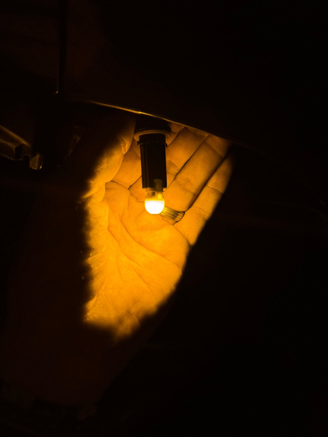

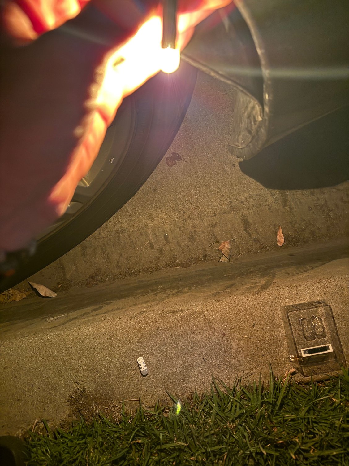

and since I was curious, I also grabbed a pair of those ambers for the front just for kicks.
they also do the job great, bright pure monochromatic amber so they cut right through the lenses and fill the corners great. A perfect be and done replacement for the life of your car.
Just a tiny bit taller than a factory 168/194. Should fit anywhere and not cause any focus problems.

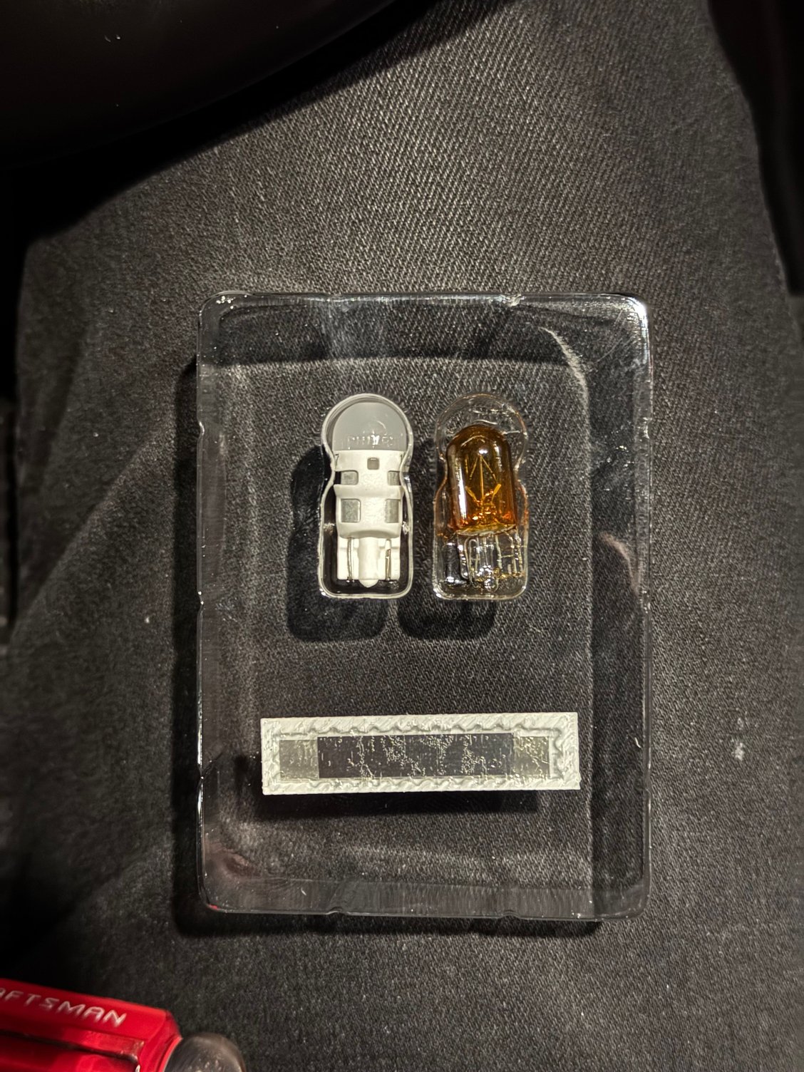

Stock bulb
Stock bulb
Philips Vision Amber. If anything id say 25-50% brighter than stock. The factory 168 is a 4.9W bulb and brighter than a 194 3.8w. So since these are punching above the 168’s, I’d say that’s a win. In person they do a better job filling the whole corner evenly and bright.
