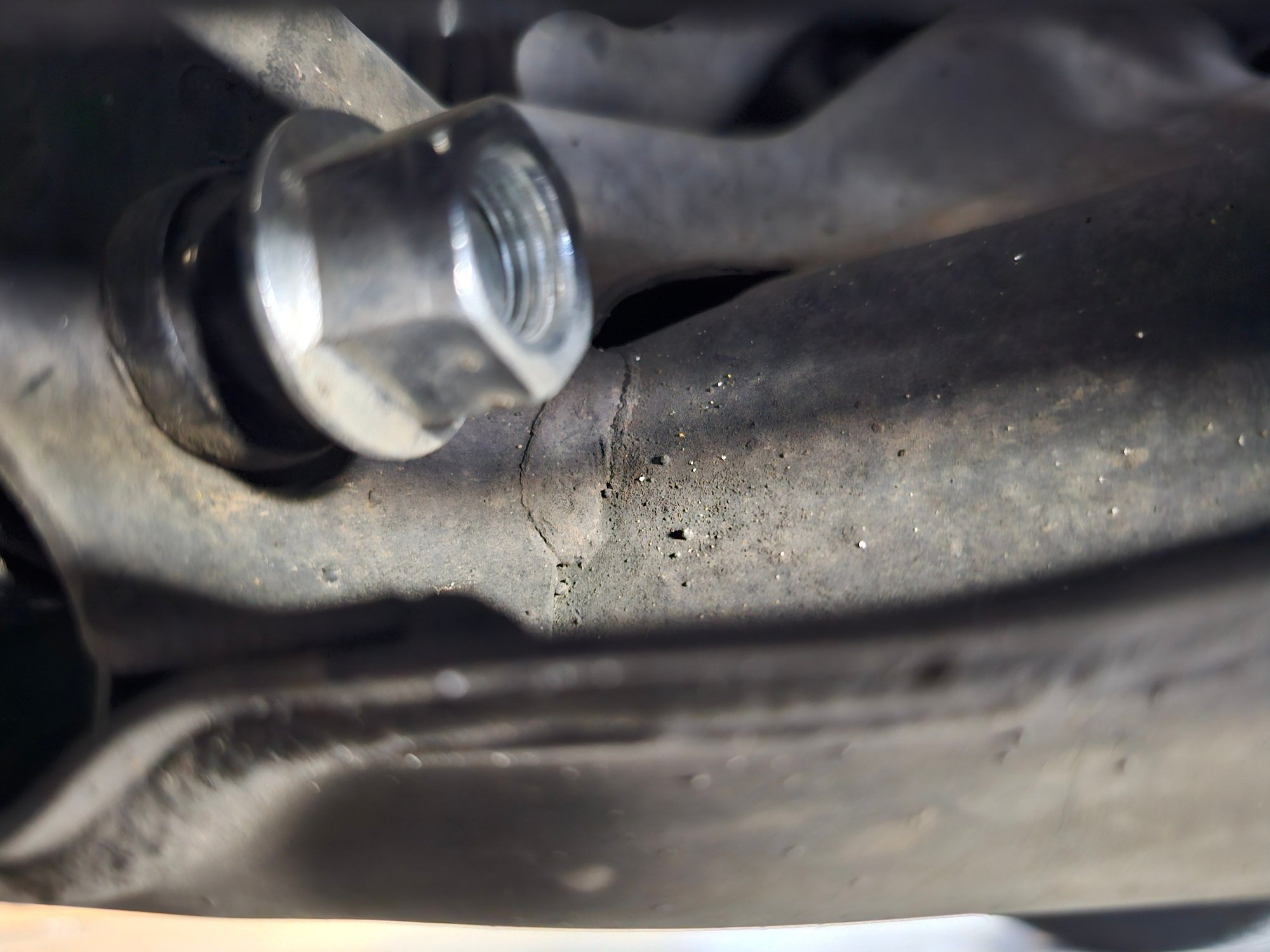

Hi Guys, mine is a 2013 Acura RDX with 260,000Km or 161,000 miles, the lower control arm bushings are showing some cracks, not completely torn.
Is it common to replace control arm at this age and mileage? do you replace just the bushing or entire arm?
Thank you

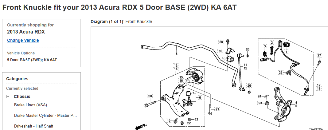

It looks like the bushes below (Base 2WD) are not sold separately & the LCA's are sold as assemblies?
Get the OEM part numbers and google search for best OEM's or aftermarket if they are available.
Front Knuckle - 2013 Acura RDX 5 Door BASE (2WD) KA 6AT

These are 12 year old cracks, don't touch it until it torn.

Reminder that the pair of bolts labeled #21 in the diagram should be replaced and not reused per the shop manual.

Do the bolts 20 & 21 thread directly into the welded nuts in the subframe and don't use nuts?

Yes #20 thread directly to welded nut in the subframe.
#21 thread to the control arm bushing metal casing

Thanks for confirming. I recently had the 2 lower control arms replaced with Moog parts and they came with nuts for #20. But the bolts were not long enough for the nuts thread onto them completely.
So I was concerned if bolts were shorter than OEM bolts.

Moog might have included the wrong bolt.
The Mevotech kit that my customer bought included the correct subframe (#20) bolts.
Ontario_bass - you needed an hour per side including r&r of the old control arm and pressing out/in the old/new bushing?? If so that's impressive. Alldata quotes 2.3 hours on a first-gen RDX and I assume second-gen is similar.
Make sure to torque the cross bolt #20 when the tire is on the ground.
Alternatively with the wheels still off: use a jack to push up on the ball joint & knuckle to simulate the weight of the car on its suspension before torqueing that bolt.
