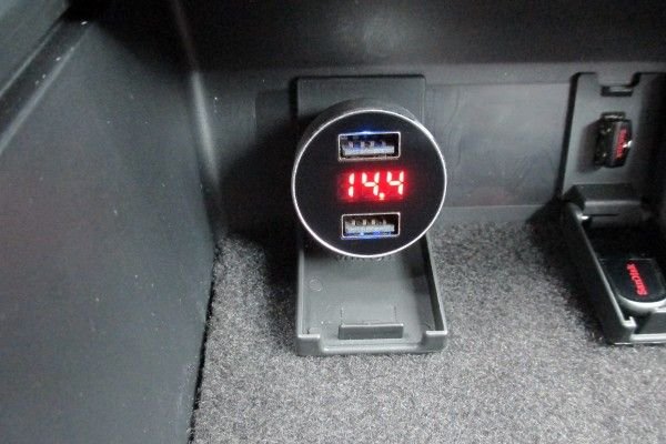

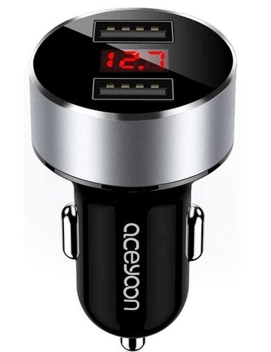

What does the charging system measure....? Get yourself one of these as a minimum. And you should be seeing 14 to 14.4V.
What is the name of this?
I am seeing 11.8 (using multimeter) under load which leads me to believe alternator is shot.
Off Amazon for under $20. Plus it has two USB ports for charging. Some other models go for less.
Looks like it.
