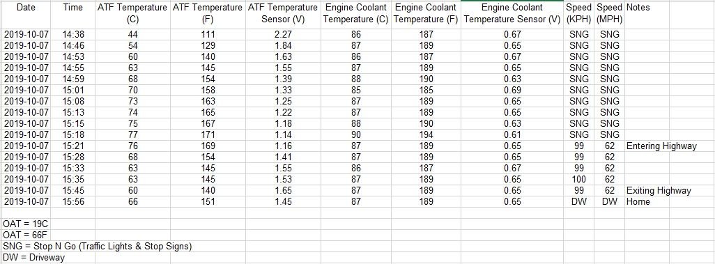

My 2017 RDX still has the factory Honda DW-1 fill in it, if that is what the "factory" fill is.
On the highway at a steady 100 KPH (62 MPH) on a 20 minute drive and also where the ATF temperature stabilized for some time, I am not even getting close to getting as high as your temperature.
My LAUNCH diagnostic tester was recording: ATF Temperature, ATF Temperature Sensor Voltage and Speed. Next time I will also have it record coolant temperature although it was exactly where it always is on the instrument panel. OAT was 15C. Terrain is level and I was not pulling a trailer. BTW, speedometer is within 1 count verified with my GPS with cruise on and a level and straight course.

Old Oct 7, 2019 | 03:52 PM
Tech's Avatar
Joined: May 2017
Posts: 1,311
Likes: 430
From: Right Here
FYI
I am sure SNG would have increased further. Would have to verify it though.
Also sure highway use would see it level off around the 125F range (verified the other day).
Will have to repeat when it warms up.

You found AT temp max out @171F with OAT@66F, much less and stable @125F while cruising. Would be nice to know if the sensor you monitored is located off the oil tub or cold return from external cooler...
By itself this suggests you should not have to worry about premature (<100k miles) temp breakdown of AT fluid, for YOUR DRIVING / LOCATION / CAR. Recheck @IDLE and/or above 90F in to be sure.
