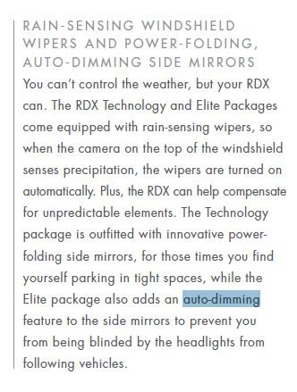

Screenshot from the 2017 RDX (Canadian version) shows auto dimming side mirrors (and powered folding mirrors) are part ofthe Elite package.

My 2017 RDX Advance has auto dim rear/side mirrors. There might be slight differences between the Canadian Elite and US Advance. I remembered that the Elite has heated steering wheel, however the Advance doesn't.
