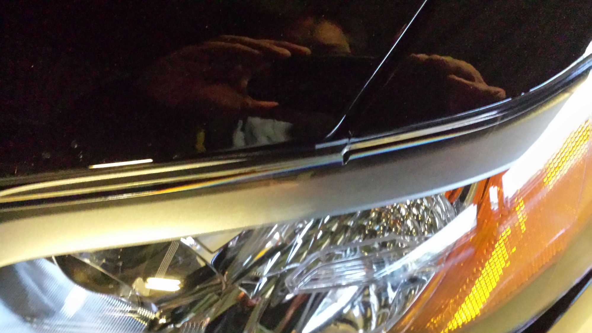

Originally Posted by omac
Has anyone noticed any quality issues with new Acura vehicles?
I just purchased a 2015 RDX and noticed that the hood fit is uneven. On one side, the hood floats ~0.25 inches above the headlight.
On the other side, the hood hits the headlight.
I took the car back to the dealer but they didn't seem to be able to do much adjustment to it. Has anyone had similar issues? Any suggestions on how to handle something like this?
Thanks for any suggestions.
After my rear quarter panels were repaired TWICE due to the headlights cutting into the paint, I now have this problem, the hood is binding on the left fender and will now require paint AGAIN. Jesus Christ, this along with the clear coat going on my Civic I'm starting to have serious doubts about Honda's paint department.
