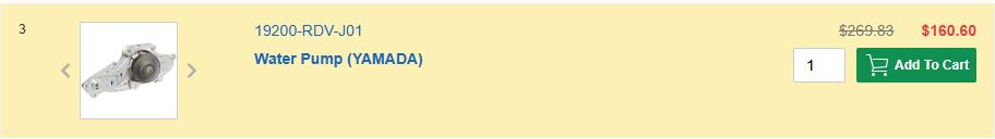

I went to an Acura dealership a few days ago, they found an oil pump leak. I double checked it and it looked like they were right. Their offer was ~$3000 for timing belt, water and oil pumps.
Now I am exploring my options. First of all, I would like to figure out what parts need to be replaces, I came up with this list:Belt, Timing - 14400-RCA-A01 - $121*
Tensioner, Timing Belt Auto - 14520-RCA-A01 - $204*
Adjuster, Timing Belt - 14510-RCA-A01 - $99*
Idler, Timing Belt - 14550-RCA-A01 - $63*
Water Pump - 19200-RDV-J01 - $185*
* Can be replaced with Aisin TKH002 - $187
Pump Assy., Oil - 15100-5G0-A01 - $63
O-ring for Strainer, Oil - 15221-RYE-A01 - $4
Gasket, Oil Filter Base (housing) - 15302-5G0-A00 - $8
O-ring (10.2X1.9) for oil pressure sensor - 91319-R70-A01 - $1
Oil Seal (39X53X8) for Camshaft x 2 - 91213-R70-A02 - $20
Filter, Oil - 15400-RTA-003 - $7
Washer, Drain Plug (14MM) - 94109-14000 - $1
Belt, Alternator - 31110-5G0-A01 - $47
Oil+coolant
Do I need to add anything else?

Hmm.., I could not find them in the OEM parts catalog (2017 Acura RDX), what RockAuto kit are they included in?
Honda wants to make money on the whole valve instead of selling you just the gaskets.
So I thought I gave you 2 good part #'s for the spool valve gaskets for the 2017...that may not be the case. Altair47 is correct in that it looks like the Honda / Acura doesn't list the gaskets separately and RockAuto doesn't list the gasket kits past 2015 models. I have a 2013 and 2018 RDX...looks like Acura changed the spool valve assembly in 2016. So, in sum, you're probably better off to leave the spool valve assembly alone...unless it's actively leaking.

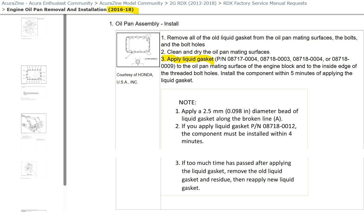

 What oil pan sealant does Honda recommend to use?
First-gen RDX shop manual calls for Hondabond or Ultra Flange Sealant. I'd guess it's the same for second-gen RDX although worth double checking.
08717-0004 - Hondabond 4
08718-0003 - Ultra Flange Sealant
08718-0004 - Hondabond HT
08718-0009 - Ultra Flange Sealant II
I've asked ChatGPT about all these, it recommended Hondabond HT or Ultra Flange Sealant II to seal oil pans.
Use Hondabond HT when you need a high-temp, high-performance RTV — for example, on oil pans, timing chain covers, or areas prone to vibration.
Use Ultra Flange II specifically for “gasketless” oil pans or very large metal flanges where you need a thick, gap-filling, oil-resistant seal.

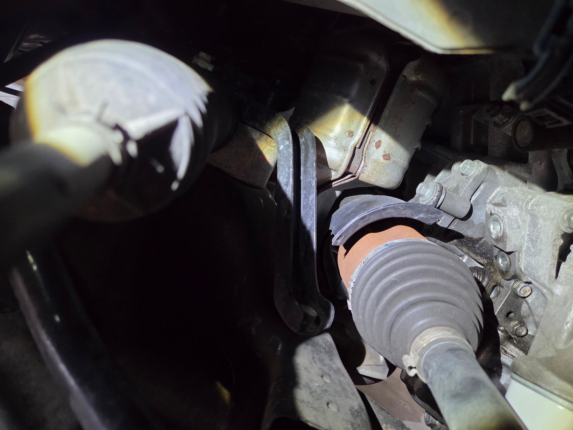

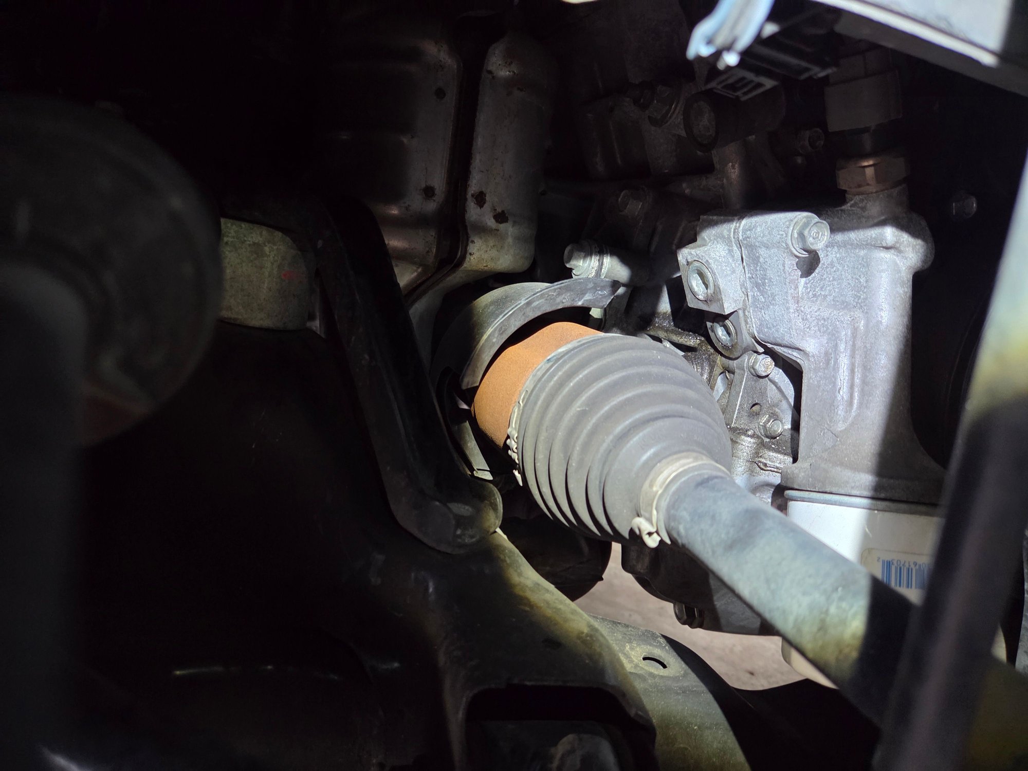

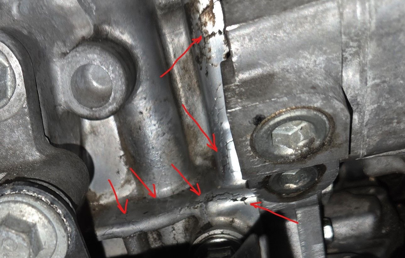

Can somebody who is familiar with this issue confirm that this looks like an oil pump leak? I got this conclusion in an Acura dealership but wanted to have a second opinion before getting estimates from other shops.
The oil filter housing looks dry, so it must be the oil pump, right? (these are the best pictures I could take).
It looks like a small leak or even a seepage. Warm up the engine and wash it with brake cleaner while it's hot. Drive and see how long it takes for it to reappear.

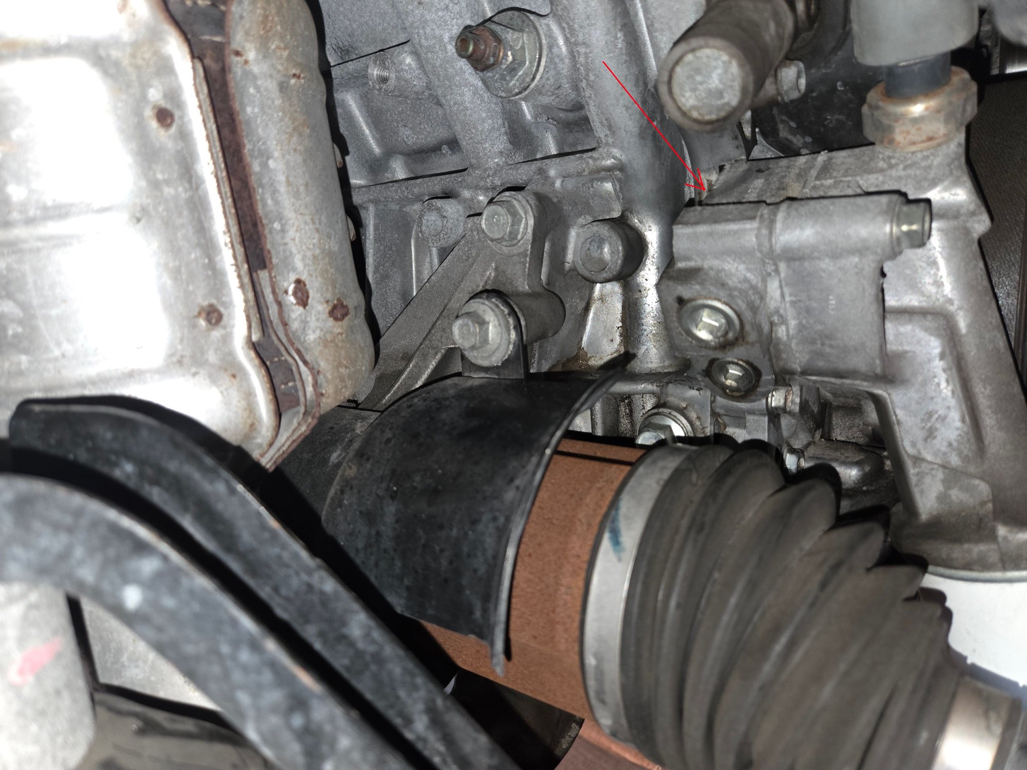

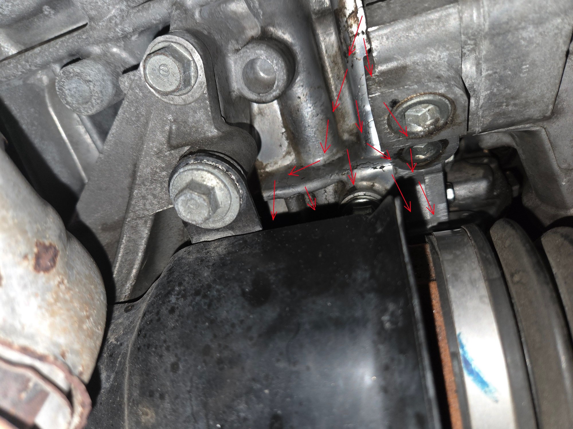

Old Nov 22, 2025 | 05:52 PM
Georgio's Avatar
Joined: Nov 2025
Posts: 37
Likes: 6
In that case, instead of throwing this money in the trash, it’s probably better to wash up this place and keep driving.
Here is how it looks like after washing. Most likely oil flowed out this way:
BTW, Are these cracks on the block something normal? Is it not what I might have caused while washing the hot block with brake cleaner?
The leak comes from here.
This is a factory casting of aluminum-magnesium alloy, not a crack.
There is no freshly leaked oil in the picture.
Of course, I took them right after washing.
I was talking about these cracks:
If you washed it, drove 10 miles and it was dry, then there was no leak.
Old Nov 22, 2025 | 09:20 PM
Georgio's Avatar
Joined: Nov 2025
Posts: 37
Likes: 6
Thanks for calming me down
Most likely it's a seepage, I have not seen a single drop on the ground.
