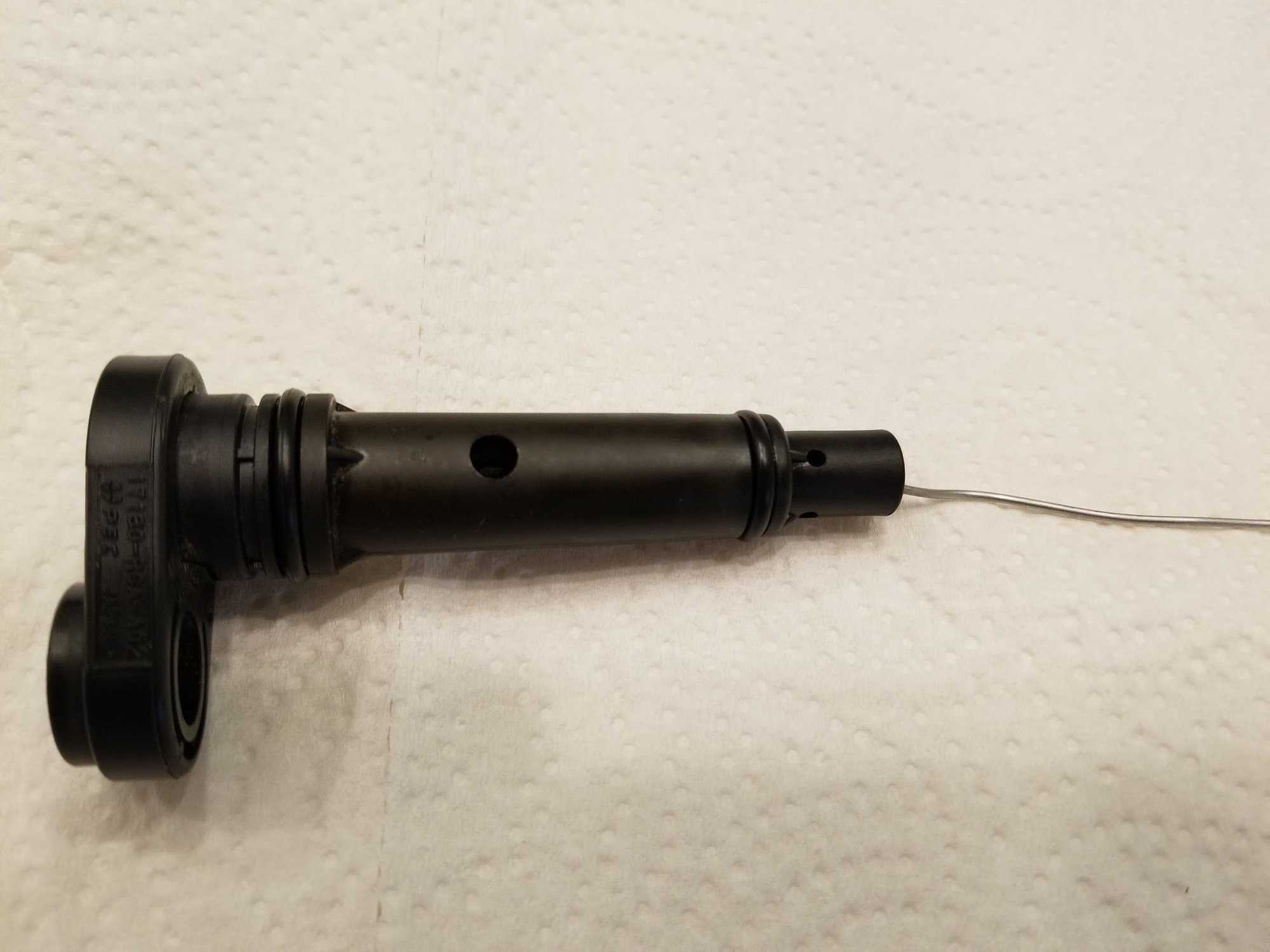

I changed my PCV valve (2013 RDX with 60,000 miles) for the first time yesterday. It took me all of 15 minutes because I'm slow. No problem removing the old one - I just turned it a little with my fingers to get it moving and slid a small screwdriver under the flange to pry it free. It slid right out and did not break. After examining, I'm not sure why this it's even called a "valve." It doesn't appear to have any moving parts - it's just a plastic tube with O-rings. My old one was not clogged, just oily (of course). Maybe the two O-rings could get hard and leak in high mileage cases but it looks like it would be easy to recondition by just cleaning the passages with solvent if they were clogged and replacing the two O-rings (if you could find them).

After examining, I'm not sure why this it's even called a "valve." It doesn't appear to have any moving parts - it's just a plastic tube with O-ring.
Googling found this:
the valve is INTERNAL
Old Jun 2, 2021 | 05:42 PM
jmcalli's Avatar
Joined: Sep 2016
You're right. I ran a wire into the small end and there seems to be an internal spring that allows gas to flow, I assume from the crankcase into the intake manifold, There was no rattle in the new one or the old one,
