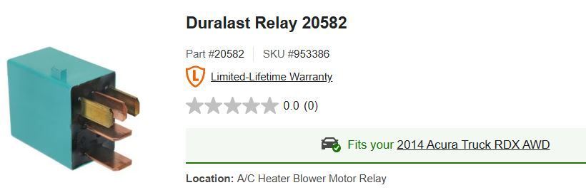

Especially in light of a new blower motor not working, check the relay (if it has one). I'll have to check on line but the relay box, often there are two should have a diagram..
It should resemble what is shown at Relay - Acura (39794-SDA-A03).

AutoZone shows this as the blower relay.

Here is where things stand, a new blower motor did not fix the problem, the old motor still spins extremely well so it's not seized or blocked or anything like that. We tried replacing the relay which also had no effect.
