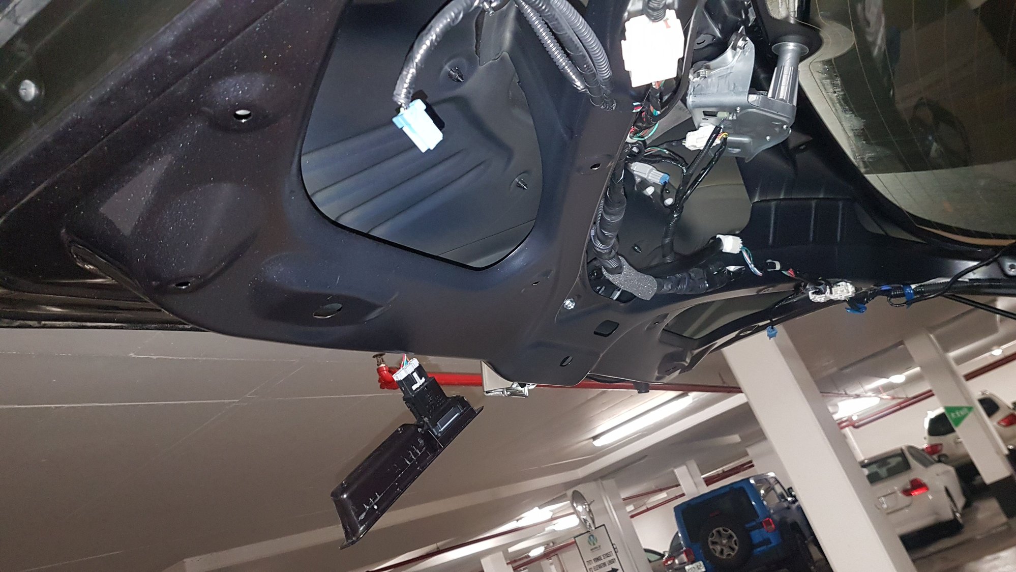

It was not really complicated, i spent that much time only because i was diving into the unknown (did not find anything about the process) and i did not want to break anything.
Right now i already assembled back everything while waiting for the camera to arrive and i took only a few pictures that i will attach here. Essencially you have to remove the interior panels starting from the top horizontal one, then the 2 side panels and finally the large panel piece in the bottom, make sure when you pull each panel to not flex it too much (particularely the large panel that requies a lit bit of force to remove).
Also make sure to remove the plastic part (the handle inside) with the liftgate button before removing the large panel otherwise the large panel will stick there.
Last thing, there is a platic connector for the camera that is attached to the metal frame (probably to prevent theft). Simply disconnect the camera connector then rotate the plastic part (like 45 degrees) to remove it from the frame.
Now the main issue at this stage is that the backup camera cannot be removed from the inside, rather you have to take it out from the outside. You will have to remove a small panel located on top of the license plate (it has openings for the license plate lights and the backup camera). I removed it by gently hamering the plastic screws that hold it in place from the inside.
Not sure if this explanation makes it easy to do but i will add a detailed tutorial once i open it again to install the camera.
Hope it helps.
here are a few pics i took:

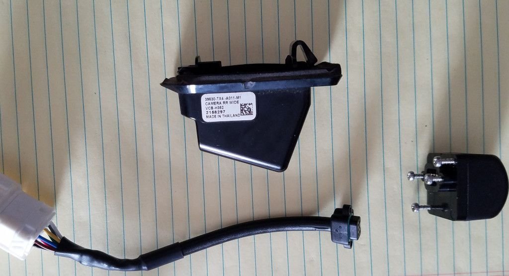

If you want to attempt a much less expensive repair, I suggest the following:
Watch this Youtube video about a camera-only repair on a CR-V:
See camera-only parts available on eBay: https://www.ebay.com/sch/i.html?_nkw...30-tx4-a011-m1
Compare part numbers:
The OEM Acura camera assembly: 39530-tx4-a011-m1
The camera-only part on eBay: 39530-t0a-a011-m1
This discussion of Honda vs Acura part numbers: https://ultraracing-usa.com/blog/dec...-part-numbers/
In my mind, there's about a 99% certainty this repair could be completed for $20 by swapping only the camera. The a011-m1 component of the part number suggests that this is the identical part, but only available independent of the assembly (camera + bracket + wire) through the Honda supply chain. To be clear, I did not try this myself. By the time I discovered this option I was already finished and I'm not spending another week of my life on this problem.
used part disassembled
view of wiring and screw attachments for camera
lens view of camera
That is all. Regards.

What have people's experiences been with eBay replacement cameras? I just ordered one today for our RDX as the rear camera is almost useless right now. The lens looks clear, but the image is barely visible on the screen. I don't know if it's something on the camera lens itself or not. I ordered the full assembly since the last time I pulled the camera out it was too cold and the clip that holds it in place broke.
Old Jan 1, 2023 | 05:34 PM
air4me's Avatar
Joined: Feb 2009
Posts: 12
From: Yreka, CA
Camera replacement
Hi. I replaced ours, on a 2014 RDX, about 3 years ago. As you probably found out, they are NOT repairable! Fortunately, our car has an extended warranty and it was replaced by the dealer, but not before I did take it out and tried to fix it. If you buy one from Ebay, I would make sure the seller offers returns. I was going to go this route also, but I also checked prices at a couple of online OEM dealers. I've used Acurapartsonline just to get the correct part number and pricing, and then go find that part, which is probably what you've already done. Just be VERY careful installing the new one, as the clips ARE breakable. Good luck!
Old Jan 7, 2023 | 12:46 PM
imnuts's Avatar
Joined: Aug 2013
Posts: 94
Likes: 15
From: Berkeley Heights, NJ
Well, the eBay camera came in today. Quality of construction for the clip/housing portion isn't great compared to OEM. There's a big opening in it, so water/dirt/etc could get into the lift gate, but since my OEM camera clip broke previously, not much different. The wiring coming from it also isn't as nice, but that shouldn't be an issue. Considering it only cost me $102, I'm not going to complain. After getting it installed, put the vehicle in reverse and all camera views work and I can actually see again. Hopefully it lasts a few years.
Old Jan 7, 2023 | 06:01 PM
air4me's Avatar
Joined: Feb 2009
Posts: 12
From: Yreka, CA
That's what I saw with the after-market cameras as well...BUT, you saved $150 and it works! Good for you! Like I said...I was fortunate enough to have mine under warranty!

Replaced camera but image is flipped
Hi there,
i followed these steps and was able to replace the camera with one off eBay. But the picture came out flipped (so the image is upside down), I even bought a second to be sure and got the same result. The camera only has 2 screws and can only go in one way, would appreciate any advice or comments if anyone encountered a similar situation and figured it out.
Thank you in advance and appreciate all this advice I found!
