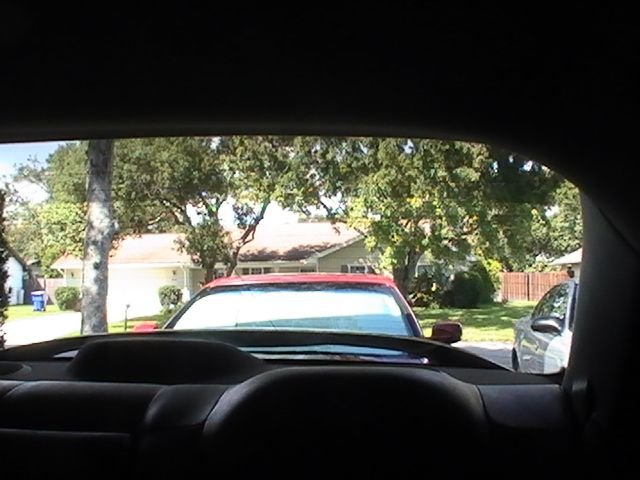

Took advantage of one of many 95+ degree days and removed the rear windows messed up nineteen-year-old tint.
It looked like the below picture.
Followed this video and used pure simple green as suggested.
Probably because of the age or tint quality, I was not as lucky to get the adhesive to pull with the film.
Using a micro-fiber cloth, simple green removed the adhesive film with repetitive applications until the window was cleaned with sprayway class cleaner.
It was a PIA and because of the heat, I had to pull the car in the garage; however, at least now I can see out the rear window and the result was good.

In my research on doing this, I've heard people say to use ammonia based 409 cleaner or Windex & simple green.
I had a lot of simple green on hand and just used that.
I think I let it bake in the sun to long and that's what caused the tint adhesive to stay.
The guy on the video stated 20 minutes at 120 degrees f.
I left it about 40 minutes and it was pretty dried out. Live & learn.
If I decide to remove the side window tint, which is not defective at the time, I'll give the other two a try to test their effectiveness.
The sides will also be much easier to deal with because of access.
Laying / maneuvering on the rear seat to clean the adhesive, especially down low & around the third bark light, was an exhausting contortion act with the heat of the day.
