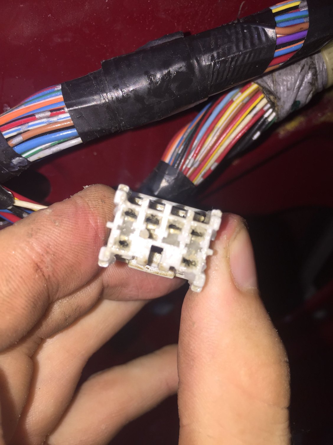

The person that was supposed to replace my regulator did a hack job with the wiring and purchased the wrong (assumed) regulator with the incorrect pin format to fit my car's loom/harness. So from here I inspected his work and I noticed that he didn't use any solder or any sort of electrical shielding which allowed for two cables to short . I'm not an electrition by any means but I can put together a guitar so I'm thinking something got fried... but I am an optimist soooo I soldered the two wires that were hardline connected to the reg. together and put some proper shielding around both of these wires, and silicone paste. He also used part of my old regulator's wiring harness so that it would fit to my door harness because I think he got the wrong regulator and relized but then tried to isntall it anyway.......
Here's my problem since I have tasked myself with dealing with this mess/dilemma.. I can't find any window regulators with the correct pin layout that would actually fit my loom. I have a 6 pin molex type connector in my loom/harness and the replacement regulator only came with four cables leading to (again I am assuming) a four pin female molex to mate with the door harness/loom. Only four cables are present on the regulator that he got, no sign of two more.. I've looked for the same regulator with a six pin molex and I could not identify some off of certain websites and the only ones I could find were the 4 pin ones...

My male molex from my loom/harness on the door. Sorry for the lame quality, my iphone is lame.

#2 or #7 on the link below will give you the OEM regulators with a part number to cross reference to aftermarket, if you desire.
https://www.acuraoemparts.com/auto-p...or-window-scat
In addition, you could also search car-part.com for salvage yards in your vicinity for a wrecked CL. Maybe you could harvest a 'used' regulator/connector to remedy your problem.

I should have mentioned I was talking about the Left hand door regulator. You helped me realize I forgot to mention that crucial detail!
With one glance it wasn't hard to determine my Regs authenticity.. Turns out it was a taiwanese part that didn't have the right pin connection.
