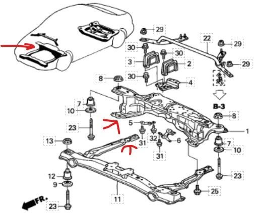

With both models look for rust, most certainly if it is a northern car.
The passenger side front beam, for example, as it connects to the rear beam, has a tendency to rust out because of the A/C drain outlet on that side of the firewall.
The OEM rear beam, (#1 below) is discontinued, so if it is corroded your only option is to source one from a salvage yard.
Make sure the recalled airbags have been dealer replaced to avoid possible 'shrapnel' in the event of safety restraint deployment.
