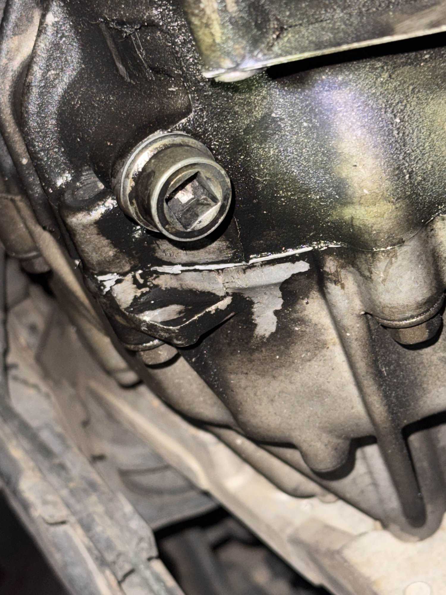

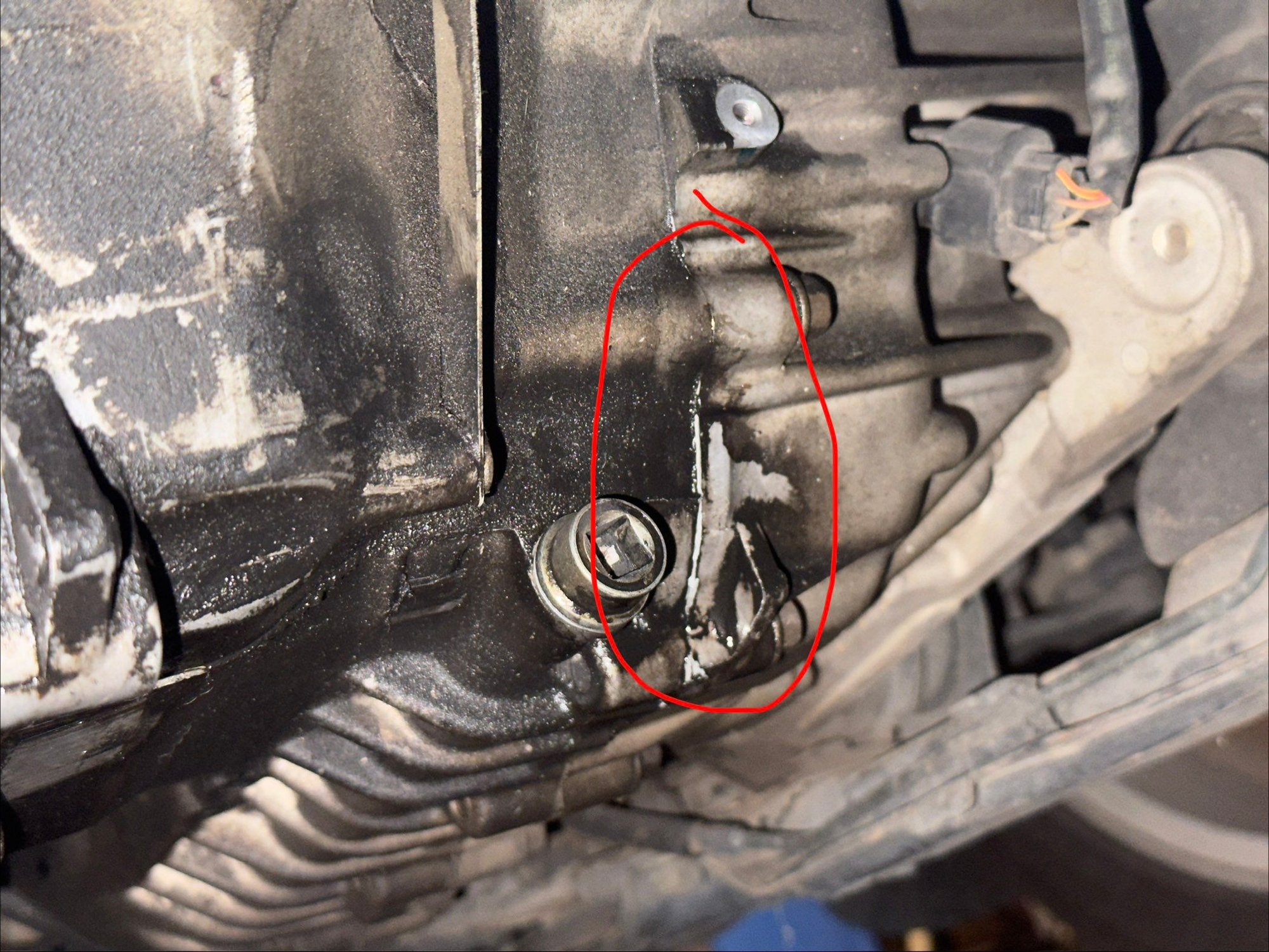

I have 2003 Acura CL Type S with the 6 speed manual transmission with 233xxx miles that I have owned since 230xxx miles. When coming back to my car in a parking lot a few days ago, I notice some fluid running from below my car (not alot), so after checking the oil level, I decided to replace the mtf since I don't have the service history of the vehicle, I don't know when it was last changed. The fluid looked fine, a little sparkly, but no major chunks. Upon pouring into an old oil container, it looked like I had about 1.7 quart, and I've read that it should have about 2.7 quarts. I started refilling it and got it to just over 2 quarts, went to check the check bolt, and it was leaking a lot of fluid. It appears to be leaking from the seal between the sides of the transmission housing. I assume, based on how much oil is caked on the bottom of the transmission, the car has been leaking at least slightly since before I bought it.
I intend my next course of action to be removing the transmission and replacing all the seals. From what I understand, there is no "rebuild kit" you can just buy, but you can still buy the seals from Honda/Acura individually. Please confirm if this is accurate and if so what are all the seals in the transmission and is it worth the money to replace the bearings, shifter forks, and any other components while in there? For anyone reading this, giving a response or not, thank you for your time.
Fluid was flowing down the seam inside the red circle, looked like it was either leaking across the whole seam or just at the top.

The gray material highlighted by the yellow arrows is most likely an RTV material (Honda bond) providing a 'seal' between the machined surfaces of the trans housing & clutch housing. There is no fibrous 'gasket' type seal kit available that I know of.

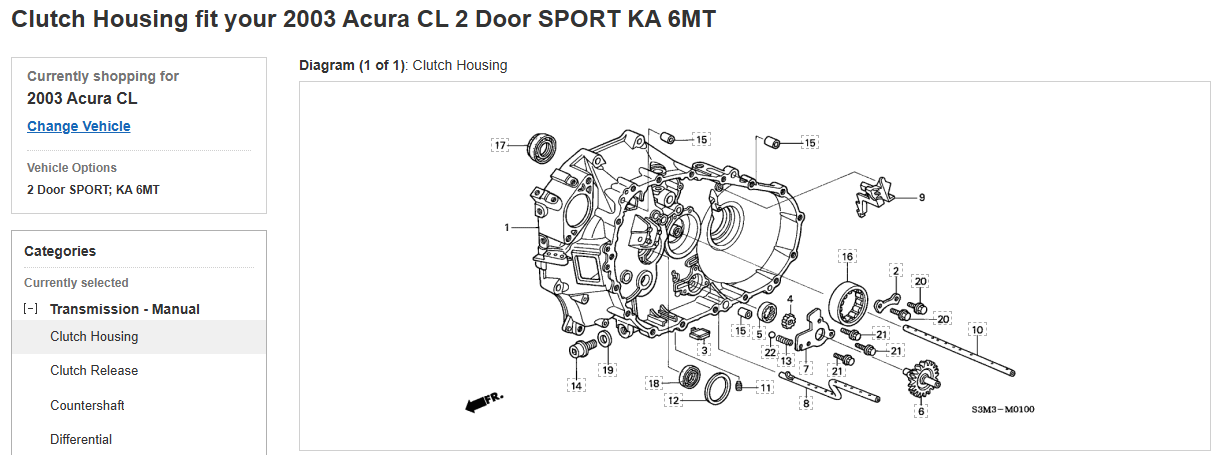

As a result, here are OEM part vendor diagrams of the clutch housing & transmission housing below.
Use the links provided to explore the availability of any parts you need to replace for your CL-S6.
Clutch Housing - 2003 Acura CL 2 Door SPORT KA 6MT
Transmission Housing - 2003 Acura CL 2 Door SPORT KA 6MT

Yes, #17 on the clutch housing diagram & #22 on the trans. housing diagram.
