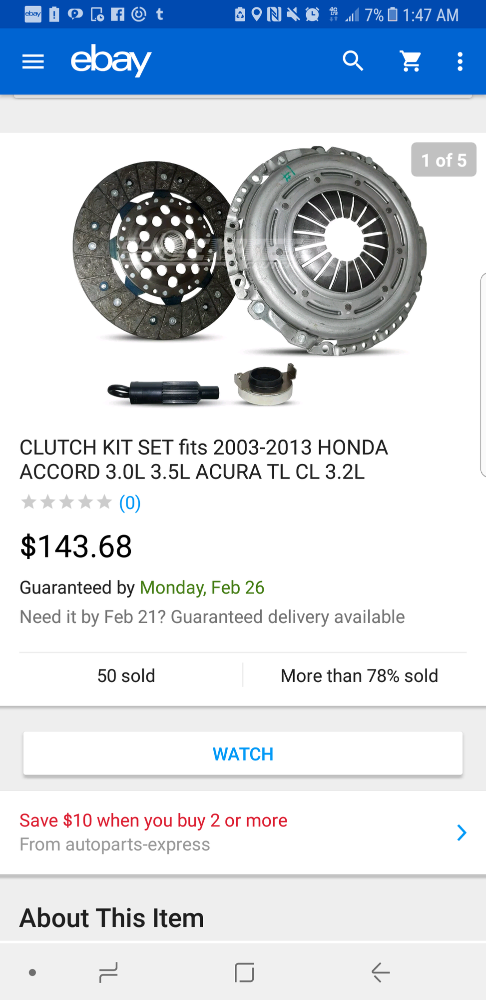

Thank you guys for the info. Where can I get that ACDelco fluid? I'd like to try that first. Here's some screenshots of the clutch its def not a LUK replacement I couldnt get that at the time just opted for this. I dont think this is a self adjusting clutch at all... is that the problem??
If those pictures above are accurate, you are correct, that is not a self-adjusting pressure plate. You may have to do some adjusting, shown in the procedure below from the Helms, at the clutch pedal to find that consistent smooth shifting sweet spot.
Good Luck!
I agree, the image is definitely not a self-adjusting LuK pressure plate.
