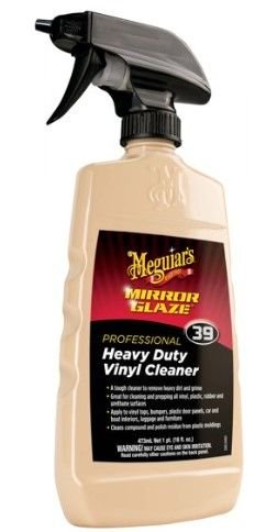

I was going to say that if the 'in-car' airbag inflator was already updated he could just transfer the AB module & cover to the newly acquired steering wheel; however,
1) (red arrow) the steering wheel below appears to be an inexpensive salvage non-Type-S assembly (probably put in as an accident result) when compared to the new one above.
2) (blue arrow) the black finish coating appears to be a little degraded / sticky.
Here in hot weather Florida, the glossy factory colorant degrades, ends up sticky, and becomes an irritant.
The base AB cover underlayment material is a dull black in color, so the factory gloss colorant can be removed to eliminate any stickiness, if present, by
employing Meguiar's M39 heavy duty vinyl cleaner on a terry cloth rag.
After removing Amorall can be used to gloss it up again.
This is all inapplicable, though, because the more appealing Type-S AB cover, with the shiny 'A' logo, on the new steering wheel is the way to go.

Great write-up! Thank you very much for the guidance!
