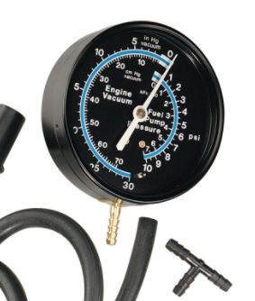

When I say manual gauge, do you have access to another vacuum gauge to do a comparison against yours? Just wondering if your boost issue is real or a gauge calibration issue.
I have one of these in my tune up tool kit. Just tee one of these off of the upper plenum vacuum lines and see what you get. Tape it to your windshield or run it into your cabin without pinching it and compare to your other gauge.
http://www.sears.com/sr/javasr/produ...TOOL&ihtoken=1

Originally Posted by Jayw/clS03
1. boosting 12.5lbs when i am supposed to be maxing out at about 9lbs (9lb pulley)
2. I got tuned 2-3 weeks after running the base map that came with the emanage kit which caused me to be super rich.
In my 1st Tuning day we saw that there seemed to be a problem with being able to hold a nice steady air/fuel ratio but i was still able to gain power in the tune, so it was suggested that maybe my spark plugs were fowled because of being rich for so long. I changed those and found that 2 of the plugs were bad because the ceramic part of it surrounding the winch (sp.) was cracked probably causing no spark in both. If you shake these 2 plugs, the ceramic part gaps the plug too much. None of these plugs appeared to be fowled because none of them became black.
We thought that changing the plugs would make everything good and better and it did for WOT for the 2nd TUNING session because my power was being delivered so smoothly throughout my dyno graph and such big jump in horsepower and torque.
What problem are we missing??? The only thing tweaked for tuning ever was my Air/Fuel ratio. Nothing else was adjusted. My current idle Fuel Pressure is set at 30psi. Please someone tell me what's wrong with the car because nobody that i speak to knows why there is a problem.!!!!!
I modified the FPR to idle at 32psi. It is rising in rate but
In WOT my A/F ratio will range at the lowest 10.5 sometimes and highest to about 12.5. In partial it will be in the same range and out of nowhere it jumps to 11 or lower then to 17 and higher.
Fuel delivery seems great at 5lbs or higher boost but that partial aches.
Well, where to start. So many questions, so i'll just throw out some comments.
Your spark plugs ceramics falling off is a sever indication of detonation. anytime the ceramic is cracked you've got problems.
A good AF ratio is 11.8 for this motor. It is the sweet spot, anything richer won't hurt it, but leaner is bad. There is the possibility if you run to rich to wash the cylnder walls of oil and waste a ring.
Your fuel pressure at idle is too low, 30 psi is no good, should be around 40-42 psi, depends on other factors, but a good place to start is 40-42 psi.
Did you put in the walboro fuel pump? I didn't see this mentioned anywhere and I guess we're all assuming you did.
What kind of boost/pressure gauge are you using and how is it hooked up? If it's the autometer one that needs a constant supply of voltage during cranking of the engine, this could throw off the initial calibration the unit performs when the key is turned on.
Your total fuel pressure at that boost level should be close to 100psi at WOT with stock injectors. You also need an additional injector to give the stock one a break. I'd bet your maxing out your injectors and they are shutting down due to the duty cycle. This was something I was experiencing till I upgraded the stock injectors with RC 440's.
Your up.

First, i was told by scalbert and instructions to be at about 30lbs of fuel pressure at a 10-20 vaccuum but you are right because most turbo and supercharger applications are anywhere from 40-50psi of idle fuel pressure. I did start at 40psi and slowly took it down to 30psi and made more power.
I believe that i was detonating at some point but couldn't hear it but now that i've been describing what the car would feel like before with just the supercharger kit and higher boost pulley on, i now know that i was detonating every so often higher up in the rpm. good thing nothing blew up.
The attempt has been to get the A/F ratio to stick to about 12.2 and in WOT i guess it has been right around there give or take -+ .3.
I am currently running the fuel pump from comptech itself. I don't know if that is the Walboro pump is or not but it is the comptech pump.
My boost gauge is the autometer Phantom type. I guess it does need power and does engage when the car is on the on position. I just don't understand how it could be so uncalibrated. I'm going to get a manual gauge and make a comparison. I hope that it is my gauge that is wrong because i don't know how much longer the motor can take 12.5lbs of boost.
I wasn't aware that i had to get an additional injector with my setup. Other people have not had to do this so i would assume that i would not have to but we will see.
Today i experienced a new problem. Now constant load even after 5lbs just before WOT makes the car go from about 11 then to 17+ A/F ratio. before this problem was under 5lbs of boost. So this problem of rich to lean is getting worst day by day. I thought that it was just a Tippin area problem but now i don't know.
I amn going to attempt to get re- tuned, but this time by someone other than the one that i've been going to. I'm going to be going to allmotor's tuner (Church) since i know he has a little experience with tuning a cl-s.
Any more info??? thanks

One problem solved:
Manual pressure gauge says that i'm peak boosting @ 9lbs and dropping as i go up in the rpm.
Old Aug 30, 2006 | 02:46 PM
mrsteve's Avatar
Joined: May 2003
Posts: 36,474
Likes: 249
From: Leesburg, Virginia
Yeah... sounds like you've got a faulty MAP sensor or gauge. Happened to me twice with Autometer's crap.
12.5psi couldn't have been the actual boost level... that blower isn't capable of reaching that compression without ripping itself apart very quickly.
One problem solved:
That's what I was banking on. Glad you've isolated the problem to the gauge.
