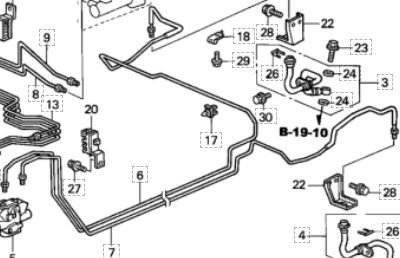

Acura part numbers (Right Rear) 46330-S84-A00; (Left Rear) 46340-S84-A00
If you search with either of these number you will get:
BL-1111-SS1D Honda Accord Rear Brake Line Set
The set will come with small sections that run from the brake hose to the wheel cylinder. The CL doesn't require those since it has disc brakes in the rear.
One other thing. You will need to lower the rear sub-frame about 1.5 inches to remove a bolt in a brake line bracket. Do not remove the sub-frame bolts. Just loosen them to get enough clearance.

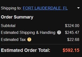

To each their own,
OEM Acura (as it appears?) one piece (Right Rear) 46330-S84-A00;
OEM Acura one piece Left Rear) 46340-S84-A00
Shipped to my zip code is $245.47 alone from acurapartswarehouse! :

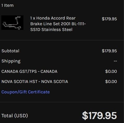

Shipping from linestogo for BL-1111-SS1D Honda Accord Rear Brake Line Set is $0.00.
Personally, the modularity of the linestogo kit is very appealing; however, that's just me.
Furthermore, since I will probably never have to replace these lines (living in the south) and I absolutely avoid, at all cost, having anyone else work on my car(s) if possible, IMHO, this kit presents with the easiest DIY installation alternative due to its modularity.
I'd purchase it in a heart beat.
