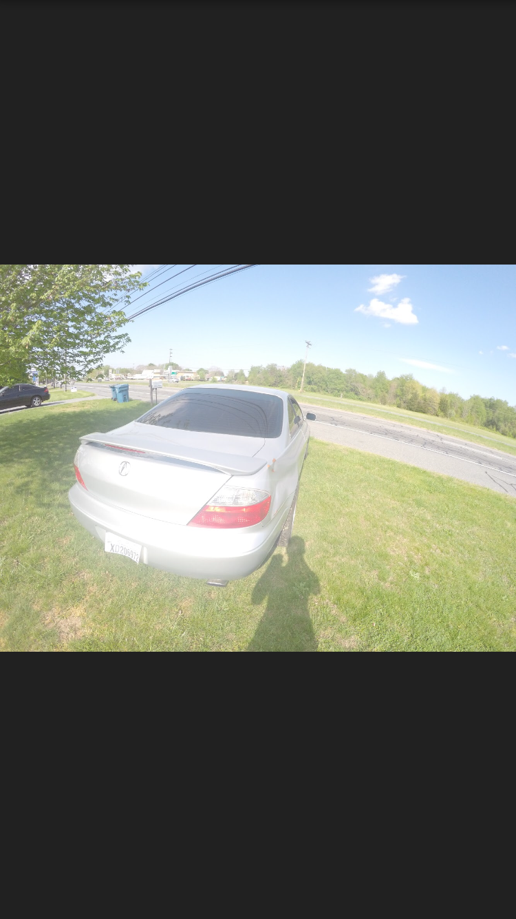

I have a 2003 CL-S and the passenger side quarter panel has a fat dent towards the rear. I found a cl on eBay being parted out and they are selling the rear panel for cheap. My question is, is the quarter panel bolted on Or is it welded on? how hard is it and how is it done?

simple answer is NO, the rear quarter panel is not bolted on, it is a welded, structural rear body component. replacing the rear quarter panel "skin" is no easy task and would take someone with professional training and experience to do successfully. exactly how serious is the panel on your car damaged? a picture would help determine if replacement is necessary, or perhaps repair of the existing panel might be a more practical and much less costly approach.

Thank you for the fast reply, here are some pictures.

that'll buff out.
But seriously I'd guess a body shop would have to pull out what they can and fill the rest. That's not a cheap fix.

The rear quarter panel goes up the C-pllar and all the way to the front windshield. It's a big piece.
