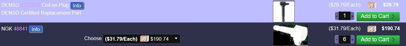

UPDATE: After going thru the time and frustration of getting the new coils installed .... I will have to do it all over again ... and it is my fault (sorta) .... we all know the story of "You get what you pay for" and in my desire to get the parts quickly and trying to save money, I bought a set of 6coils for $66 (from Amazon) that claimed they were compatable with my car .... NEWS FLASH they weren't .... the wire connection to the coil would not lock on, resulting in a loose connection which allowed for moisture to get inside the connection > engine misfire and the connection vibrating loose.
I tried modifing the coil by filing off the very top of the coil, hoping that would help and after 1hr time spent on 2 coils and no success, I have decided to return the coils and go with the NGK coils ..... We live and we learn!

Go with either Denso Or NGK, rockauto always has a competitive price before shipping. You can even find a 5% discount code by searching the net:
