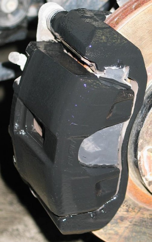

Old Sep 15, 2004 | 06:56 PM
Smitty's Avatar
Joined: Apr 2002
Posts: 9,940
From: Pittsburgh, PA
Smitty's Avatar
Joined: Apr 2002
Posts: 9,940
Old Sep 15, 2004 | 06:58 PM
VeeralS05's Avatar
I NEED MONEY!
Posts: 2,587
From: Atlanta
paint em i did mine is a one day job, clean the calipers good use de greaser or some dawn soap! and sand paper 120 grit worked well with mine. I painted my rears over a month ago and they still look like i just painted them! Get the spray kind from auto zone.... I used 500 degree engine paint and it looks great! if you need any help jst e-mail me!
VeeralS05@msn.com
Old Sep 15, 2004 | 07:05 PM
Shawn S's Avatar
Joined: Oct 2000
Posts: 20,014
From: Hellertown, Pa. USA

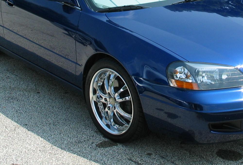

Originally Posted by Smitty
Looks fine from a few feet away and costs HUNDREDS less then powder coating.
And no need to disassemble and have the car sit for days.
i just do not know how you could put such beautiful rims and expensive Comptech parts on your car and then do something so cheap looking....
Like I said before, the powdercoated calipers look AWESOME, I don’t argue that.
It’s just that my car is used every day and it’s driven through salt & slush all winter.
It’s not a show car that sits in the garage when it rains or snows.
They look fine to me. I don't feel that it's worth the extra money for me.
