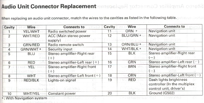

I just took apart my whole dash, and if possible, could someone scan me the audio schematics for the car. I pretty much only need what wires are Right front, and Left front, and so forth.

This may help...I stole it from Mr SilverKnight
Spiroh,
Keep in mind that those wires are at the stock amp connector, however, all the audio related wires are there. If you need the wires at radio connector, let me know.

SK,
Actually I need the ones that go straight to the deck. I already removed my amp long time ago =)
spiro
Originally posted by SilverKnight
Spiroh,

Here it is
http://silverknight.clickhere2.net/images/radiowires1.jpg
