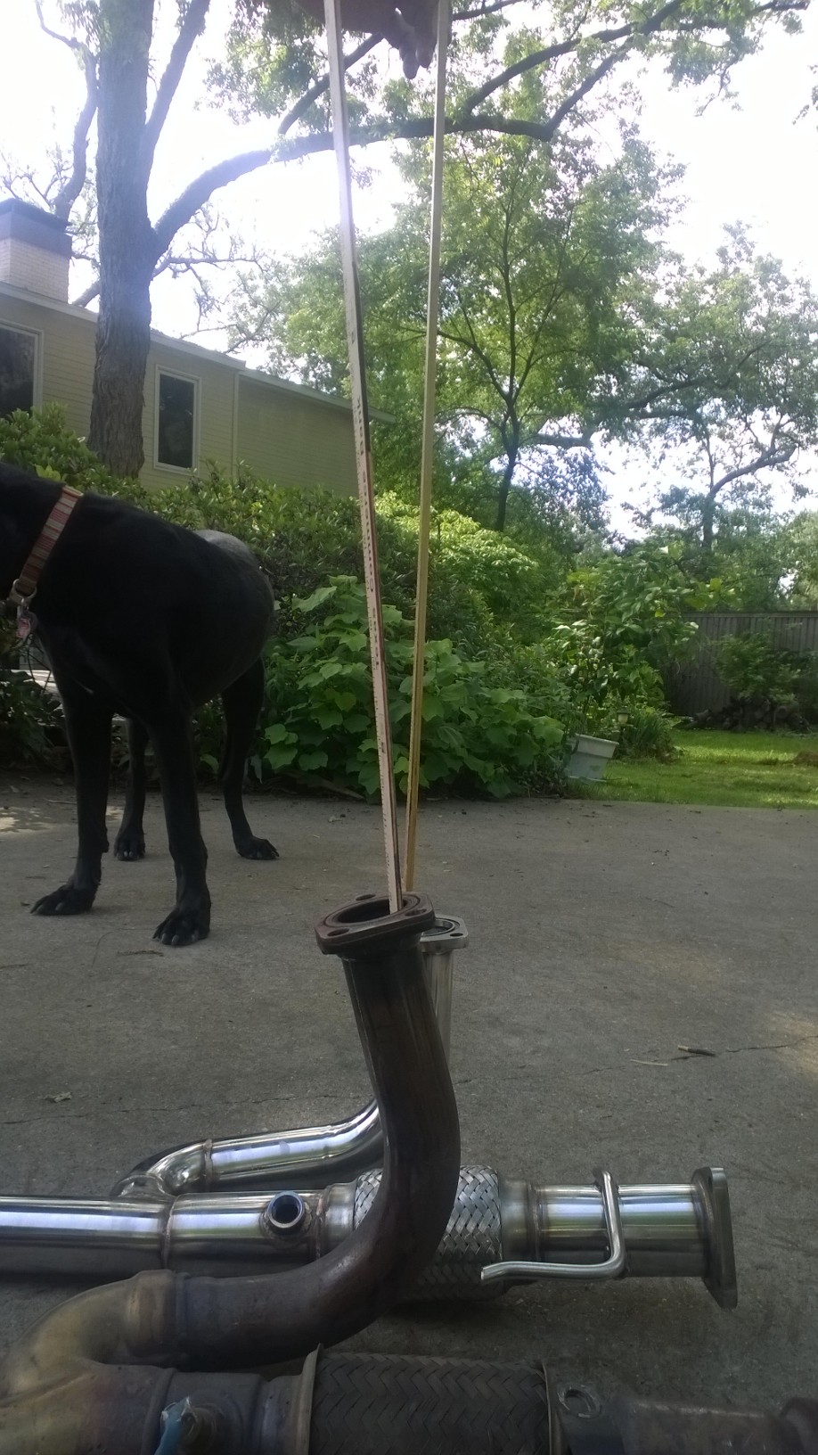

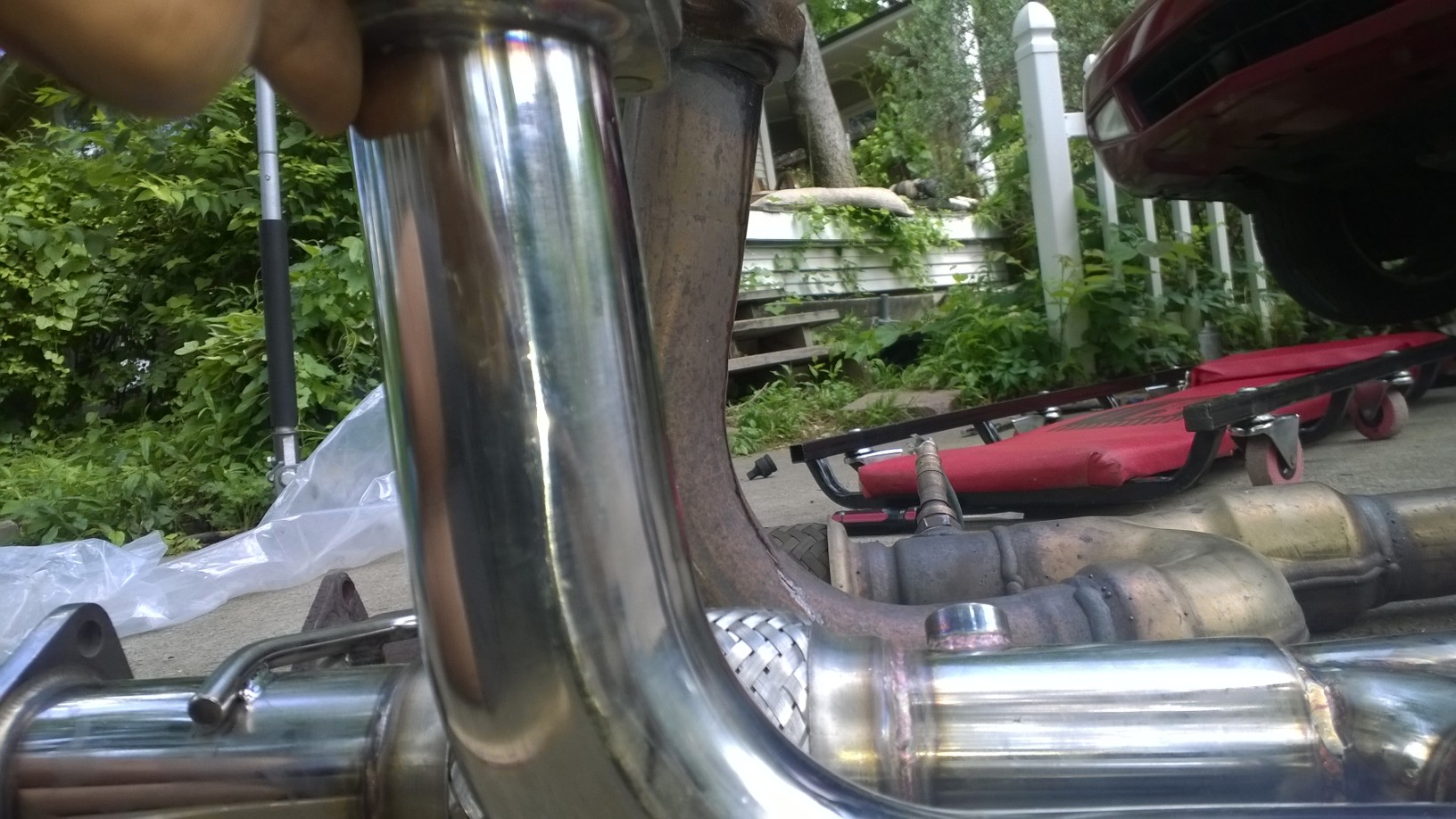

Alright here is what i encountered, just got finished putting everything back together. The angle is wrong for the rear header. Down pipe is too short and strait up, has no contour to get past the drive shaft. Do y'all see what I see?

that is so weird.... like what car are they supposed to fit on then if they dont work on the j32?
it's almost like it was never going to go on the car in the first place.
I bought some obx headers supposedly off the internet and when i got them I looked at them and literally put them right back in the box and sold them at a 80$ loss on kijiji.
Literally they just looked like ass, welds were not consistent the flanges did not meet up smooth inside the tubes... nothings was good about it.. and that was like 250-300 buck iirc.
But I held out and got a used set of CTs for 400 iirc lol and it was the best thing i ever did. I have hit the j pipe on a sewer and BARELY even made a dent in the pipe. so the steel is likely better as well.
I was once told by a customer of mine, buy cheap buy twice. and that what I ended up doing.
If i were in your situation guys with the 6 speed dilema. I would buy dc sport headers cause they are known for good fitment and quality and then modify the one header on the rear. Im guessing like 1-2 bills would get it the way you need it to be. BUT I duuno JACK about welding so this is pure speculation. It seems that would give the least troubles to you guys instead of looking for a company that has made it right to fit from the get-go.

Do you have a picture of the headers trying to be installed in the car?
Comparing the stock headers to the XS-P downpipe doesn't mean anything, since the collectors are different sizes/angles.
I'm not saying you didn't get screwed over, but it's best not to jump to conclusions. Bust out the pitchforks for when we're 100% sure it's not just you.
I agree, when looking at other members pics of the headers they received from XS-P they look exactly like the ones you received.
I would personally try again and install them if XS-P doesn't send you another. Others have had little to no fitment issues. If any, minor fitment issues but they were still able to install them. I plan on ordering a set in the next month or so.

I Agree, I need pictures of the install, I understand what you are saying about the collectors.
I have asked around about the rear collector install, and majority said that the rear went in fine, whereas are I HAD to remove the motor mount.
Once the collector was installed the down pipe didn't have enough of a swoop as shown in the first picture to clear the drive shaft.
Even though the collectors were longer and pushed everything down, it still wouldn't clear which is what I was trying to show in the 7th picture. The bend is not significant enough to clear the drive shaft.
I am currently in contact with XS and will see what they say. The wanted me to take some pictures of the difference and said they will try and ship me the "correct one" which make me wonder if there is more than one design..

I heard of others removing the rear mount also, but some say you have to twist and turn the collector to get it around the rear mount. also don't completely tighten any of the bolt down until everything is connect. Just have the bolt tight enough to hold all the piece together. It's good to hear you were able to get in contact with XS and they are working with you. Good luck and keep us updated. I'm excited to buy my set.

Yea that's exactly what I did but was still getting frustrated lol but o yea? let me know if you encounter anything similar, hopefully not!
How soon will they be there? Mine shipped super fast I had it within 4 days of ordering it from Hong Kong! I was impressed

Did you order your headers recently? Is the bend on the rear collect cut and welded or is it a true bend? Can you take some pics of the rear collector?

Yea absolutely, its a true bent, it looked like it was gonna be the right size bend, I just had a problem getting it past the mount.
Yea I ordered my headers about a two weeks ago and tried installing them about a week ago
