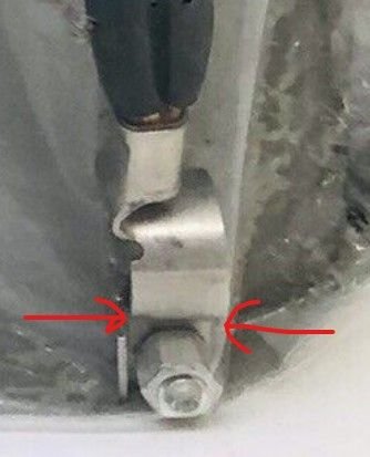

Looking at mine today it shows a vertical crack / separation (purple arrow) at the nut / bolt and round terminal fastener area.
Positive cable looks good to go.

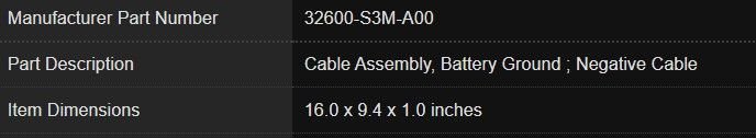

With that said, a CL-S 6 negative ground cable assembly 32600-S3M-A00 search comes up with either 'Currently Unavailable' or 'Discontinued'.
OEM Specs. 16x9.4x1
With a cursory search, the closest spec. OEM alternative I can find is 2002 Accord V6 32600-S84-A00.
OEM specs. 11x10x3
The automatic CL / TL one 32600-S0K-A10 appears available; however, its specs are shorter 9.7x9.2x1.

Is your issue with the actual clamp that connects to the battery terminal? One of mine broke a long time ago, and I just went ahead and replaced both with new clamps from AutoZone. Easy to install, and they haven't given me any issues.
Old Aug 27, 2022 | 04:09 PM
Posts: 6,904
Likes: 2,210
Yeah, the nut side has elongated into the bolt passage from years of clamping down / over tightening such that it has actually split the flat surfaces (red arrow) away at the round terminal surround.
I've looked at it again, since my battery box is lowered, because of the S/C'er location, the actual length of the 'long side of the ground' may not factor, to my detriment, in worrying about overall length.
Therefore, I may get away with using a shorter one, like the Accord cable.
Now if the battery were positioned in its higher stock location, length would probably matter.
