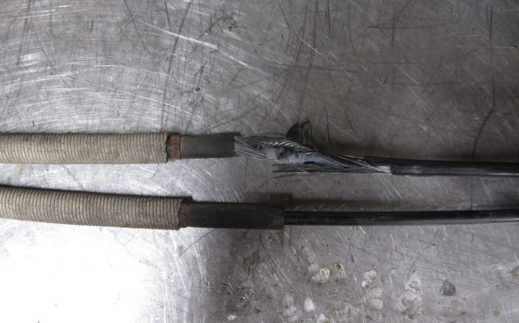

More updates. With the cables disconnected, I can move the levers on the trans, and it goes into every gear just fine. At this point, I'm almost sure it's the cables. Thanks for staying around, it seems like all of the Cl guys are gone. I'm going to check out that thread.

Found the problem, definitely not the shifter. Cables were supposed to be here today, but USPS lied as usual. Delivery was NOT attempted at 808 pm. Hopefully today.

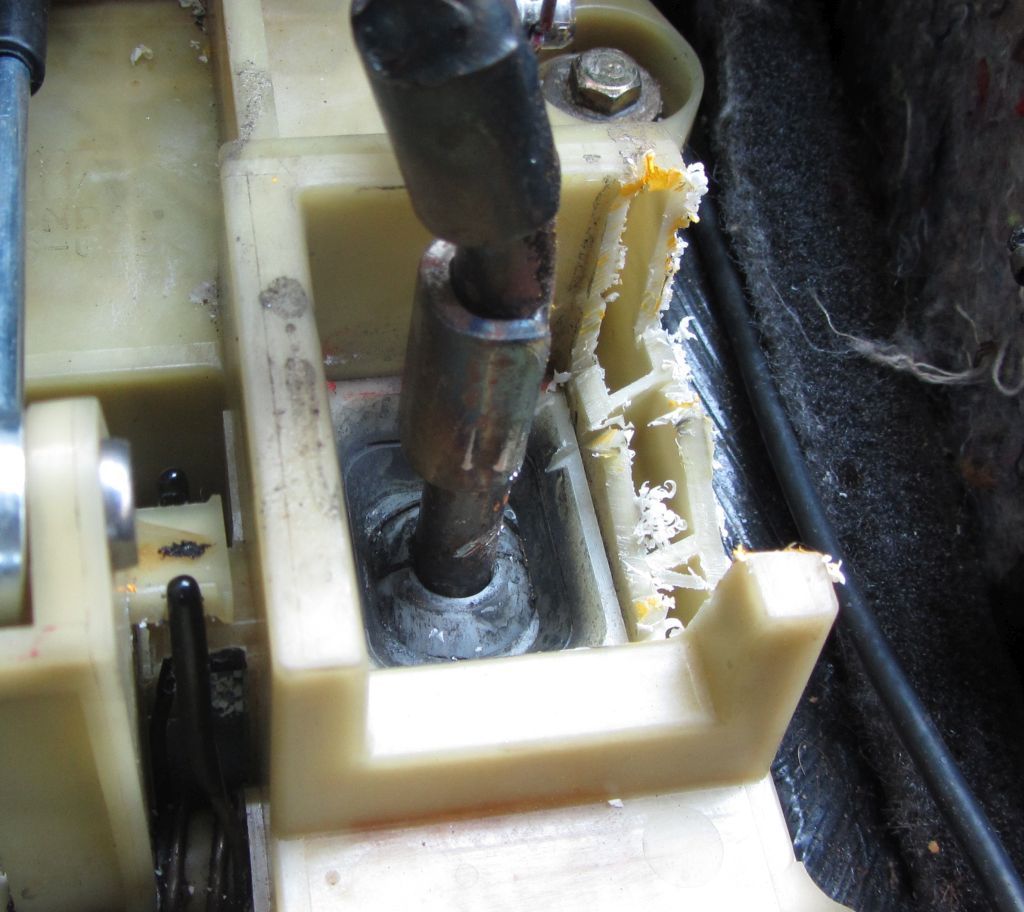

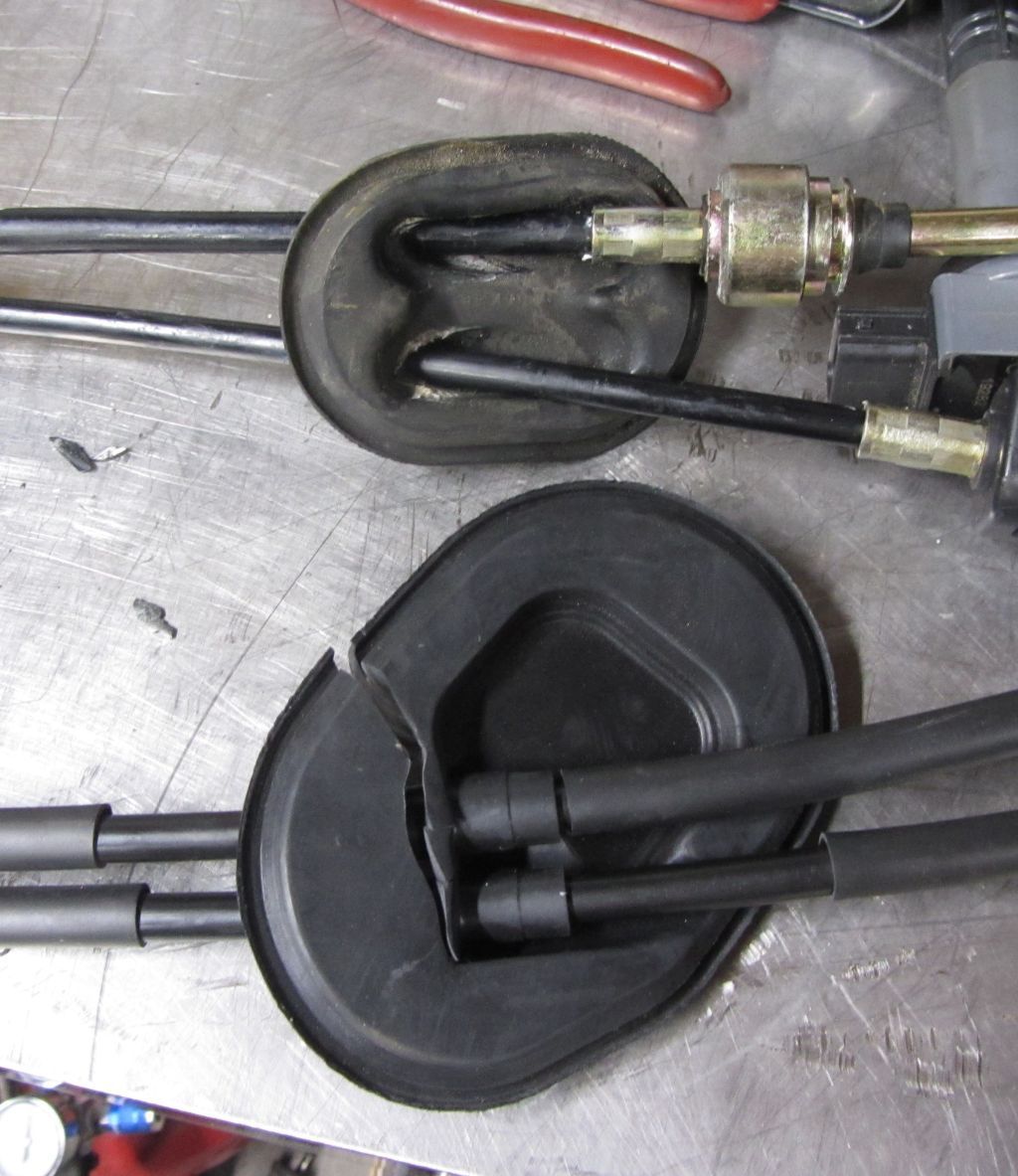

The RSX cables are about 2.5 inches longer. That made for some changes. The bracket above the brake lines will no longer hold the cables. I did get it bent back some, but not enough to get the bolt back in. The rubber that goes onto the floor to protect from weather is different, but the old one doesn't work with the new cables, since their length puts a lot of strain on it. It's there, but not going to stop any weather from coming in. Lastly, when it was done there was no reverse. I cut the shifter plastic, and now reverse works fine. All gears work, and car is now fixed. I'm happy with the result.

Yeah I wasn't comfortable with cutting my shifter box. I found that once I had installed the cables. all my gears were shifted over one position to the right (to engage 1st I pushed forward to where 3 would normally be on the shifter box). The only fix for this was to not clip in the cable(closest to the driver) into the shifter box , but that ruined the feeling of the shifter. However I'm glad you're happy with your setup!
